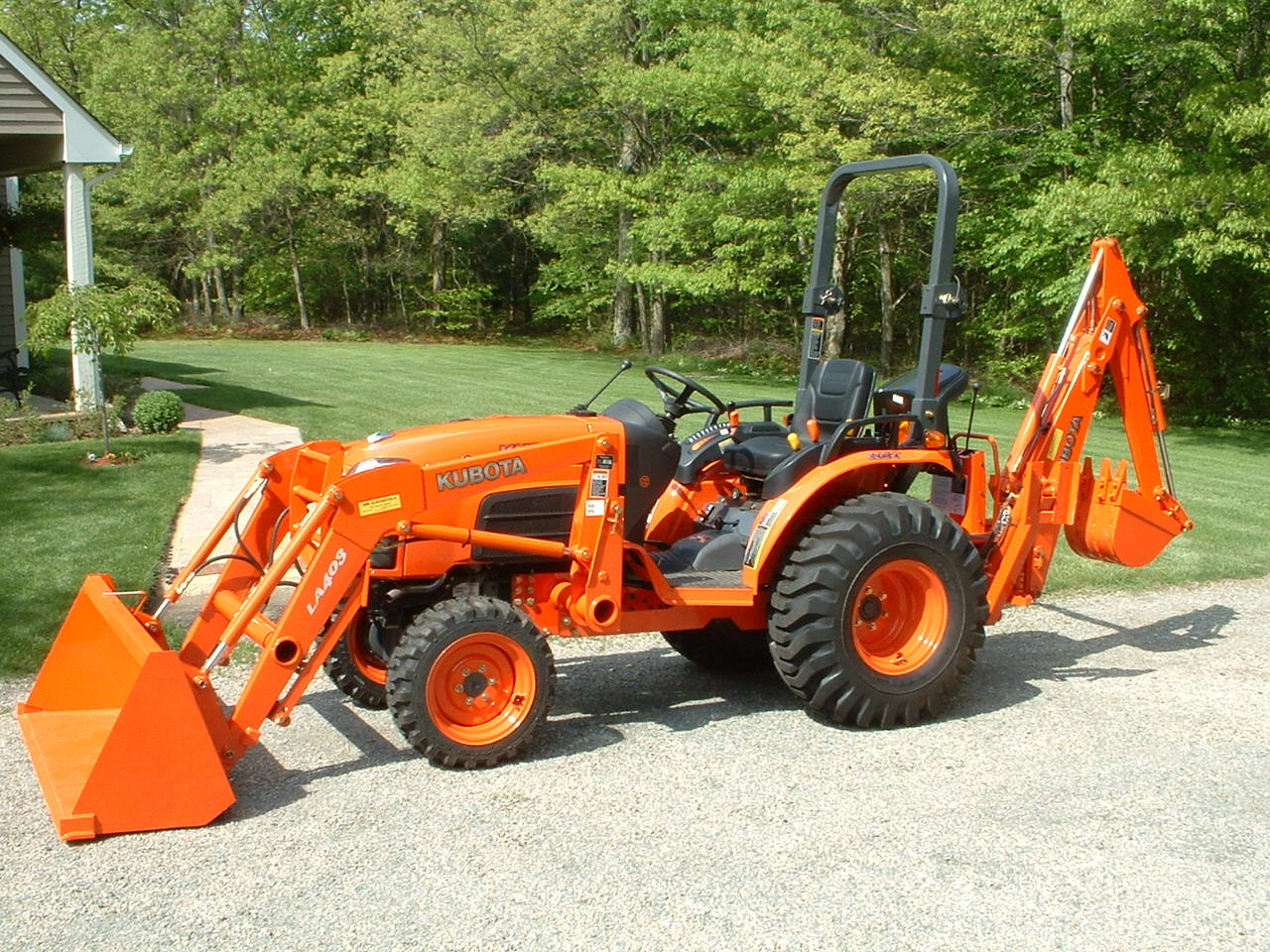

   / Tight fitting backhoe ? #2
Only cut i've seen with the hoe tucked in tight, where the seat spins around is the new 23, 26, and 2920 Kubotas

   / Tight fitting backhoe ? #5
The Kubota BH75 sits about as close to the tractor as any I've seen, though the new BH65 looks good, I haen't seen one yet. The BH75 is available on the B7800, B2630, B3030, L2800, and L3400 tractors, and maybe others. I've attached a pic of that hoe on a B30 series:

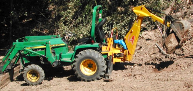

Truly integrated TLBs with a sgl dual-purpose seat are out there (Kub B21,
B26, etc) and they have close-mounted hoes.
I made some subframes for JD955s (33hp, but only 2000#) and I mounted
the hoe as close as I could. I still used 2 seats, but they could not be
folded down at the same time.
Most hoe attachments can be adapted to use a PTO pump, but modern
CUTs have plenty of hyd flow to run them.

   / Tight fitting backhoe ? #9
dfkrug, You did a VERY nice job of getting that hoe tucked in tight. Most people do not take the time or effort to get it in close. I like the look of what you did.
In my opinion, the outriggers should just clear the tires. That is where it should be. Then there is less stress on the tractor and better maneuverability.
