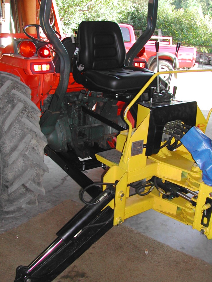

MJPetersen said:
In my opinion, the outriggers should just clear the tires. That is where it should be. Then there is less stress on the tractor and better maneuverability.
Thx, Mike. Yes, one of my primary goals was to bring the outriggers as
close as possible (plus a small margin) to the back tires. This approach
did require that I re-work how the seat is mounted. Fortunately, this
CUT does not have a rear fuel tank like some B Kubotas and the Kioti
CK20, among others.
Attached photo is of a factory early style Woods subframe on a a Kubota
L2550DT. That hoe was so far out back that it adversely affected
driveability and ground clearance.
CIDERTOM, the OP was referring to 30hp and under tractors, but yes
all integrated TLBs have their hoes close-in mounted. I think the BX24 with
the BT601 hoe is well-designed, too. There is a lot to be learned from the
B21/26, the L39/48, the 580, the JD110, and other industrial hoes.
