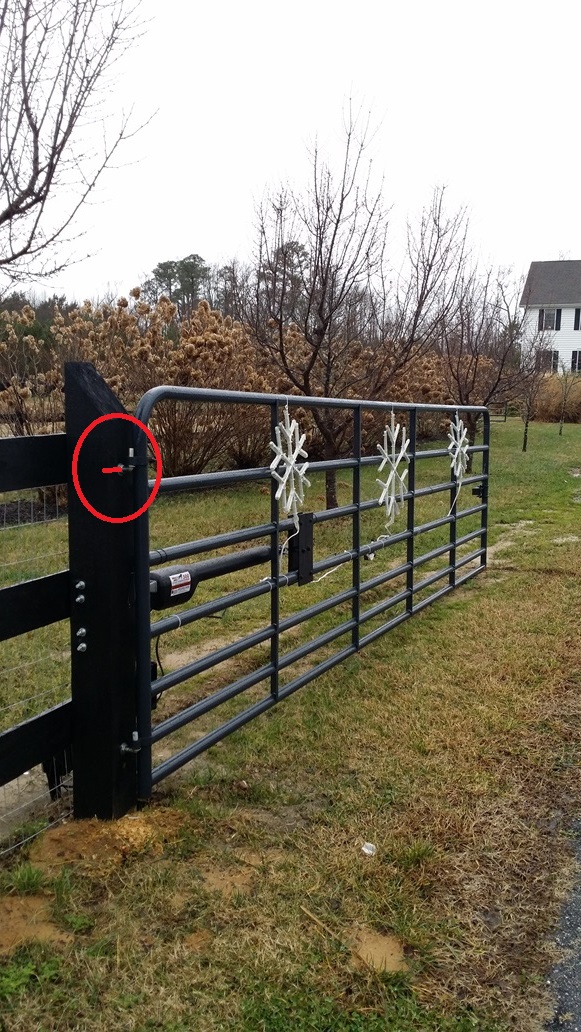

1, not sure what you are defining as slop, is there pin in socket slop, or is the clamp on hinge moving on the tube frame.
Are the pins in the same plane vertically?
Is there slope on the ground its arc swings on?
If nothing else, then a gate wheel should help as long as no binding.
   / Tightening up slop in tube gate hinge??? #12
One thing that you have to have is a truss rod or cable to level the gate; can't believe they let this out the door without one. You can add a diagonal wire or cable without welding by using brace bands and the hardware, a threaded end for the wire and truss rod tightener. Go from the top of the hinge side to the bottom of at least the third bay, if not all the way to the end. Get the hinge side plumb all ways and level the gate with the truss wire, should sort the problem.
   / Tightening up slop in tube gate hinge??? #13
A 16' gate has a tremendous amount of leverage on your post, even it is in concrete. Since your post is at 90 degrees from the fence line, the fence is not "pulling back" on the post. And just wait until someone decides to climb over the gate at the far end away from the hinge to get to your house (solicitor). I would put that gate wheel on no matter what and see if it can bottom out if anyone climbs on the end of the gate. If you have wetter soil like I do, just sitting there day after day will eventually lean that post, unless you put down a LOT of concrete. Nice looking gate and good job on the details.
   / Tightening up slop in tube gate hinge??? #14
I am thinking the hinge side of the gate being "plumb" in both directions is more important than being level. I guess it would be the same thing if we can trust the gate being "square" but is it really square? I think that is what the other poster is alluding to, the gate may be sagging out of square.
As an experiment, have you tried loosening the hinge clamps and twisting them on the gate? For instance, take the top hinge and loosen it, and twist it a little bit so it pulls back on the top of the gate. It will throw it off a little bit when it's closed but you no one would notice it but you. And it would pull the gate up when it opened.

This might be a stupid question, but is the ground flat? Because I still don't see how a gate could "droop" in one direction and not the other. Either the post is not perfectly vertical, or the ground is not flat so that the gate is running into a slight uphill grade when open. Can you run a string level from the bottom end of the gate in the open position on over to where the bottom end of the gate sits when closed, and verify that it's flat ground?
I have nearly the same setup and 16' gate (except I flipped the upper hinge pin so that someone can't simply lift the gate off the pins). Any slop in the hinge clamps and pins is not nearly enough to allow notable drooping or sagging in any one direction versus the other.

From this picture your top L bolt is threaded in farther than the bottom one. Likely to take out flex in the gate. That will swing the gate towards the ground as you open it assuming the post is plumb. The highest point of the end of the gate swing is going to be straight out from the post.
   / Tightening up slop in tube gate hinge??? #17
You know you are right. But I thought he offset the hinge pivots because the post was not plumb. If the post really is plumb, and he offset the hinge pins to make it work out when it's closed, you are correct, he will have the exact problem he has now, it will run it into the ground when he opens it. He needs to check that.
Like I mentioned, he needs to make sure the vertical piece of the gate nearest the hinged side is plumb. If it's plumb, but the gate is not "straight" or "level" when he closes it, he will have to get some sort of cable or something and mount that diagonally and pull up on the gate like the other poster mentioned. Sort of like those turnbuckle things on a old wooden screen door.
I think we all agree, the slop in the hinge pins is not his problem.

loosen the top hinge on the gate and twist it a little so the gate leans away from the side it opening to, you can lift it a little that way,
(the problem is not hinge slop),
either the post is not plumb, (the line that the hinges are in) more so than the post, or the ground is not level,
look a the front tires on a most cars or trucks when there turned sharp they lean (no longer plumb) that is because the pivot point is not in line with the wheel, (hinge line is not in line with swing of the gate) if one properly helps the tire and car turn, but your gate is not turning,
take a level and see what is off, one may need to reset the post or if the ground id not level one may need to move the hinges up on the post and give more ground clearance,
(I had to re tilt a post on a gate just a few days ago, and I had to re drill and move one gate up do to uneven ground, I had temporally "fixed" it by twisting the hinge a few days before).

From what I can see, 2 choices... Dig out the high spot so the gate doesn't drag.... Or move the upper gate hinge pin... Either move it on the post or move it on the gate... offset it......
