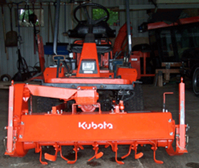

   / Tiller for BX1500 #7
I bought an older Kubota K420 42" tiller and converted it to front mount. It was made in Italy, I think by Muratori. It works great and is well suited to my F2400 (24hp). A slightly smaller unit like the 37" may be a better match for your BX1500. /forums/images/graemlins/smile.gif
