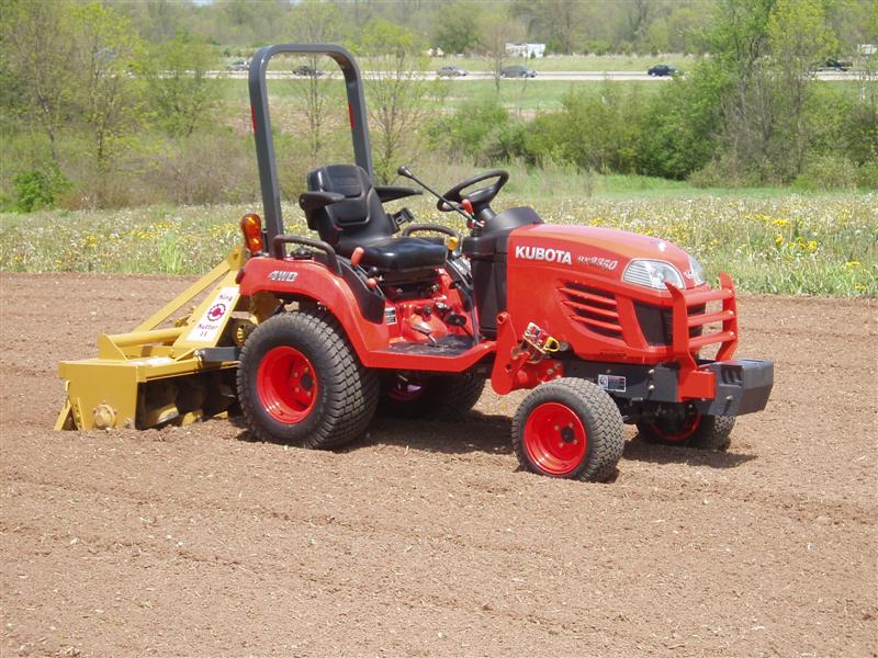

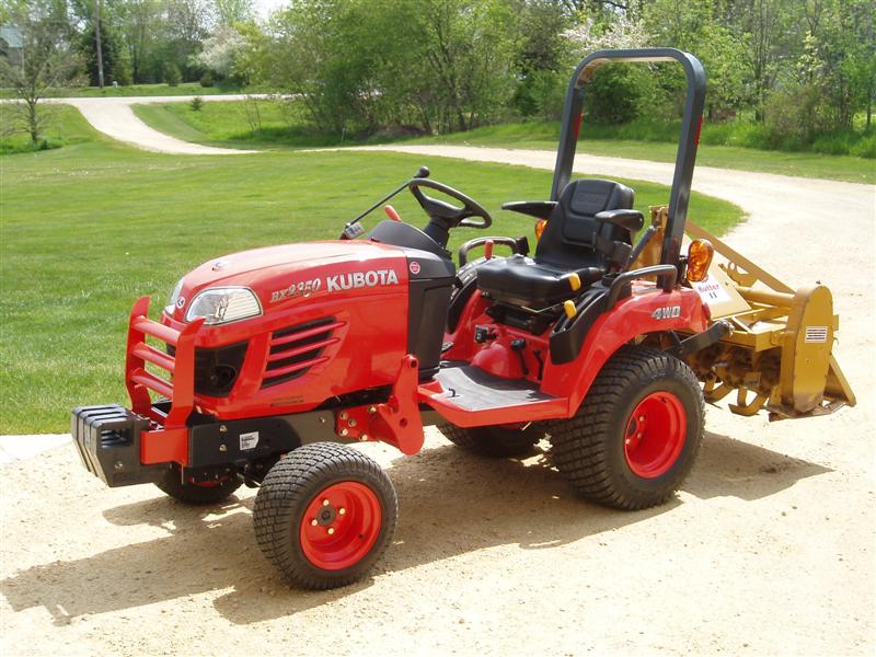

I run a KKII 48" gear drive on the BX2350 which is comparible to your 2200. No problems to report, works fantastic. The 2200 should have no problem with a 48"-50" Tiller.

/ tiller for bx2200 #8
Sheesh jc, how did you wash your tractor in the middle of tilling??:D
Seriously, did the field look like the wildflowers in the background? Nice work...
I'm teetering on the edge of buying a LandPride tiller myself for my BX, these pictures aren't helping.
