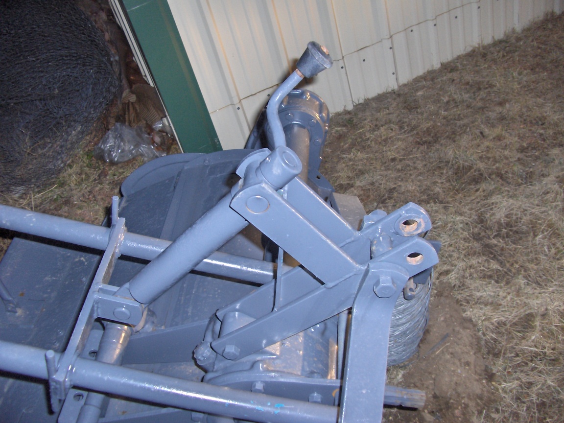

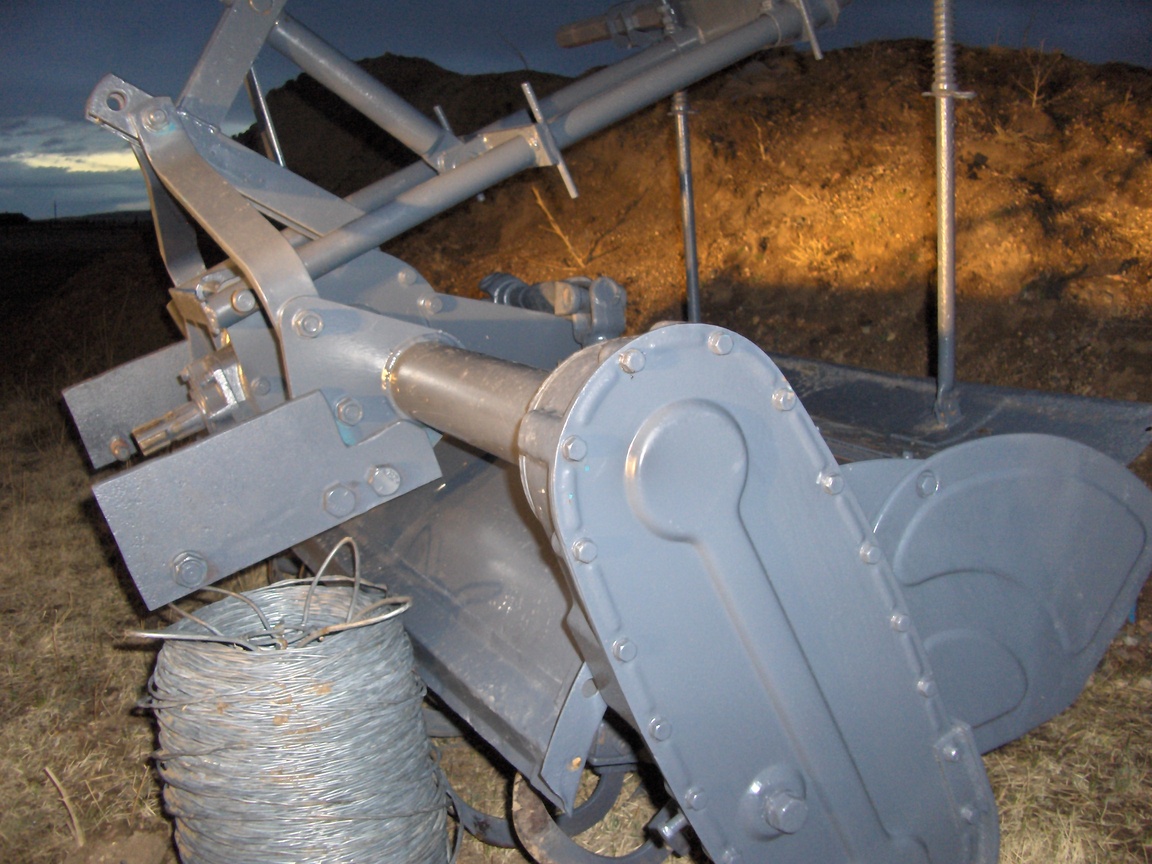

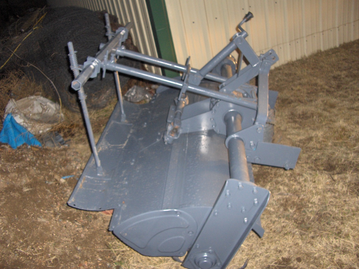

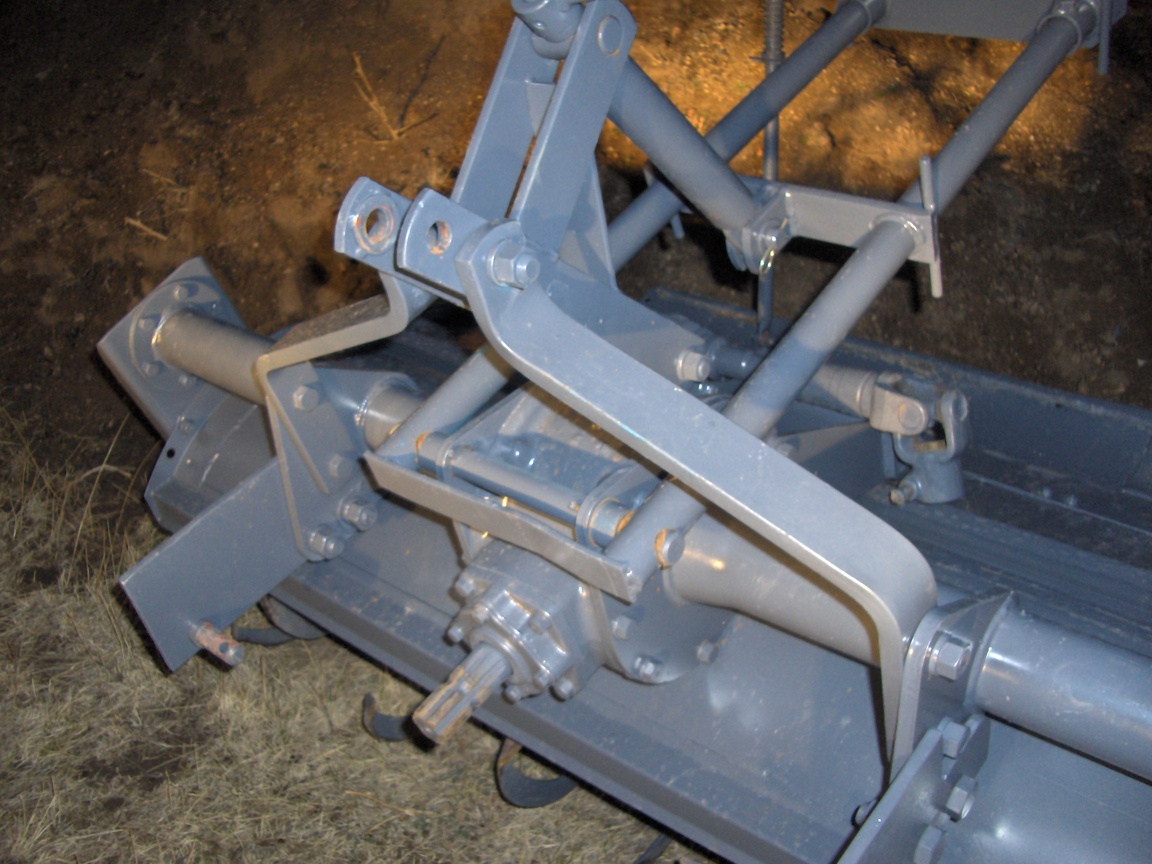

I have been looking at used tillers for quite a while now in my area (about 7-8 months actually.....I've come across a few of them but they have for the most part been badly beat up and overpriced (see my original tiller help post).
anmyways, I came across this tiller locally and I made the plunge and purchased it. Unfortunately the gentleman I bought it from wasn't exactly sure of the make/model etc. The guy he got it from told him it was a Ford/New Holland brand but I'm not so sure about that...
Anyways, if anyone can help identify this I would greatly appreciate it.....and any suggestions on how to operate/adjust it.....should I change all the oil on it prior to use.....check any items for wear etc etc etc. It was hooked up and I was able to test it before purchase and it seemed t run very well with no noises or apparent strain so I'm hoping I got a good deal here. One item of concern is that this does not appear to have a slip cluthc or shear pin....can anyone confirm that and if true give me any advice on how to add one?
Thanks!!

Looks to me like a Yanmar that may have started out life a 2pt mount and has been converted to 3pt.
As to what to check or do. Is there oil in the drive train? Is it clean? Maybe not anything needed here but couldn't hurt to change. Have you hooked the tiller up and see/hear how it operates? My Yanmar tiller is vey quite and I have to turn around and look to see when it is operating to make sure it is operating.

I have a yanmar tiller on a 1510 and it looks different that mine. However, it certainly looks like a homemade 3 point conversion on an imported tiller. I know that mine has already taken some hard licks and has not wimpered.
(I hit a BIG square of concrete that was buried and in the grass. That was a bucking ride 'til I got it stopped.):eek:
I say homemade because the 3pt mounting bracket is not cut straight or even (pic 4) and the brackets are squared off and not centered. That is NOT to say that it will not be a great tiller for you for years to come.
Check oils and give it a go!!;)

It's got to be a tiller from the far East. The tines are for tilling rice fields. At least looks clean and not beat up. They have put some thought in the 3 point home made design. It looks quite functional. For sure I change the oil in the chain drive mechanism. To remove possibility of water in it due to tilling rice field I will open it up to inspect inside and may be remove rust if any. Probably you'll have problem with locating OEM gasket but am sure you can use RTV instead as long as you allow it to skin enough. There will be some sort of ball bearing for the rotor shaft on the opposite side of the chain drive assembly... I make sure to lube that up good . By the way how much this thing set you back $wise.

Yep, that looks like a grey market tiller that was used in rice paddies. It also looks like it was gussied up for sale with a new coat of problem hiding paint. Around here these have been popping up for sale in the $200-400 range for 4' models. The chain housing sometimes leaks and everything in there gets rusted up - be sure to check that out!

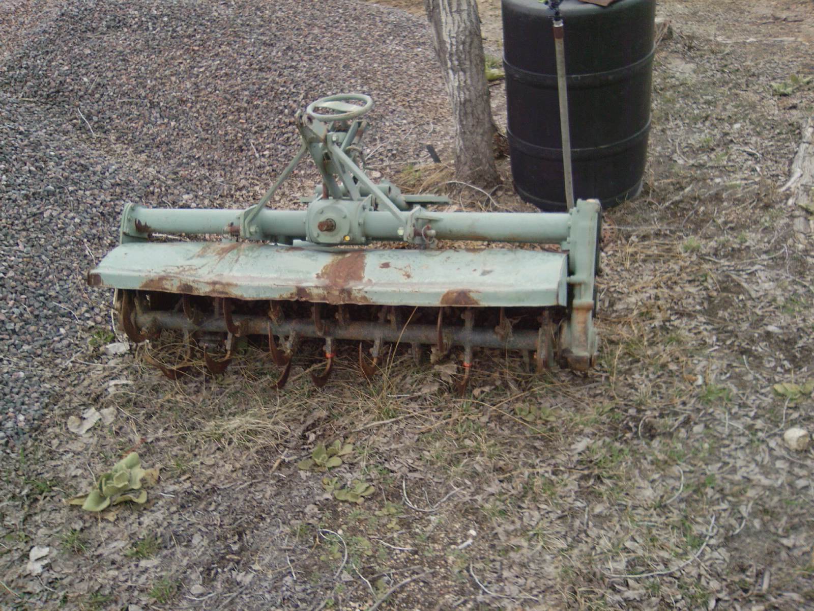

Well...this is a 60" model....as mentioned, I got to see and hear it run and it tilled the ground very well and has no readily apparent leaks....i paid $700 for it...maybe a little too much...but when compared to other used tillers around here it seems like a good deal....I just couldn't justify paying around $1400 for a new tiller that will be used about 2 hours per year to till a garden.....
And here is what is being sold around these parts in the $600 range....so I think this was a decent deal....but time will tell for sure.

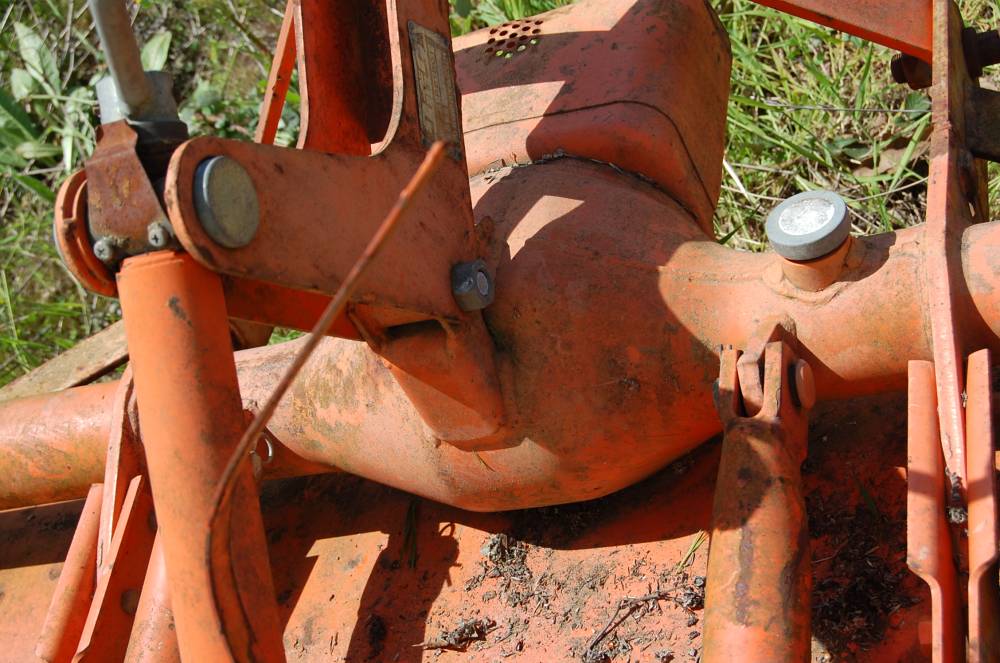

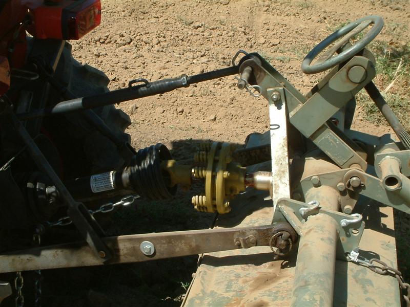

Here're a few photos of my used Yanmar RS-1200 rototiller (48" wide, $300 from my local grey market tractor dealer). I've used it on my 21-hp (engine) Kubota B7510HST to till the veg garden and the new lawn area around my house. No problems with the tiller, but I did plow the ground with my middle buster before using the tiller. Makes it easier on the tiller.
That tiller you're looking at looks similar to mine, but not identical. Could be a rice paddy tiller.

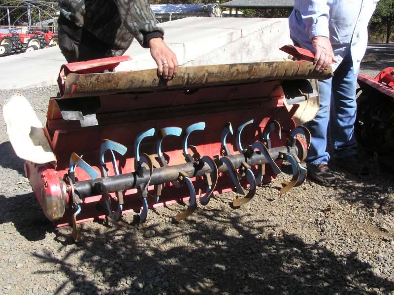

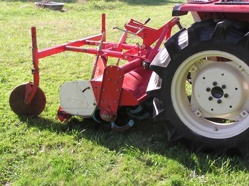

Here ar a couple pics on my Yanmar tiller. 4.5' wide.
First couple pics are what it looked like at the dealer with first off-loaded. Last pic is of it with "training wheels" on and mounted on the tractor.
Paid less than the $700 mentioned in a previous post for an older model in somewhat poor shape. As I previously mentioned, I can't hear it running, it's that quiet.

Ok...I "serviced" the tiller this weekend....drained the main gear boc and refilled with 85w gear lube....also, took the chain housing cover off completely...and man, was I glad that I did....there was about 1 handful of lube in there and about 2 handfuls of dirt/sediment.
Got it cleaned out....no rust....chain and tensioner were in good shape, and refilled with 85w gear lube.
Thanks to everyone for your help with this....and one other question...is the 85w lube going to work in this thing? I was told to use 90w but neither my local Big R (think TSC) or auto-parts store had 90w....noly 85.

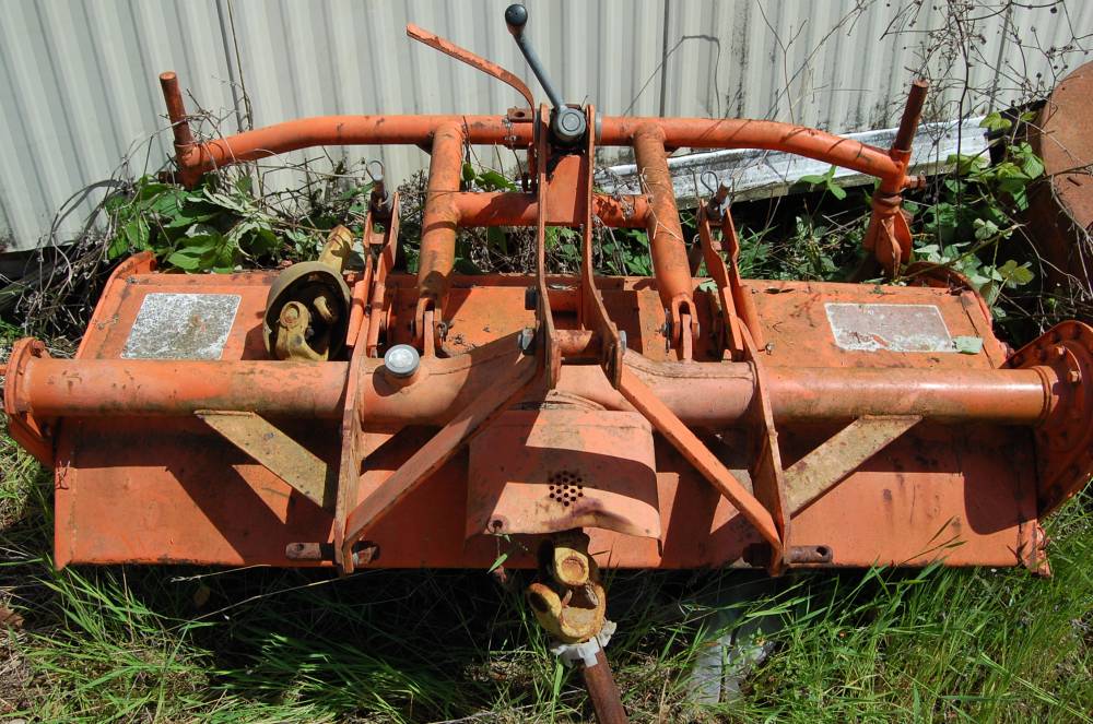

A few pics of that old tiller we have out at the ranch. I like the idea of the adjustable gage wheels, wouder why no present day tiller manufactures haven't done something like this? I think this matbe an old Yanmar, can't read the writing!
