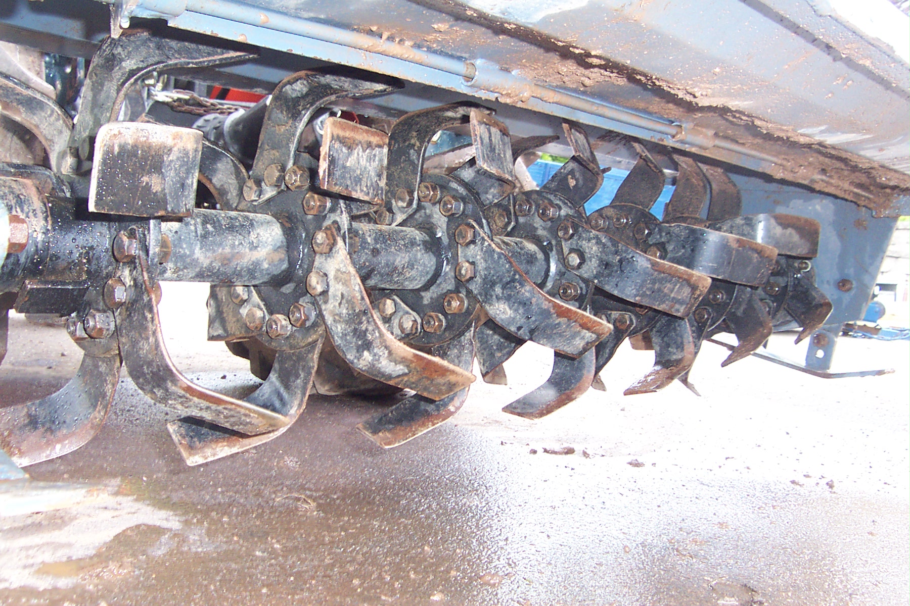

If anyone has either a King Kutter or Dark Horse tiller ( Basically the same unit other than color and assembly) and is leaking oil, then I can help you with the fix. Seals are $5.00 each.
Breaking tines?
If anyone needs help through the process, I would more than happy to help!
I have done two now and I consider my self educated on these machines enough to help others. Both these tillers are working great.
Post up and I'll walk you through!
If you happen to run across a Dark Horse tiller leaking oil as is a being given away, grab it. ( grab it for me , if you don't want it)This has the basic material for a good tiller, but you will need to disassemble and reassemble it. Some TSC have them on clearance price, grab it, if you don't mind reassembling it.

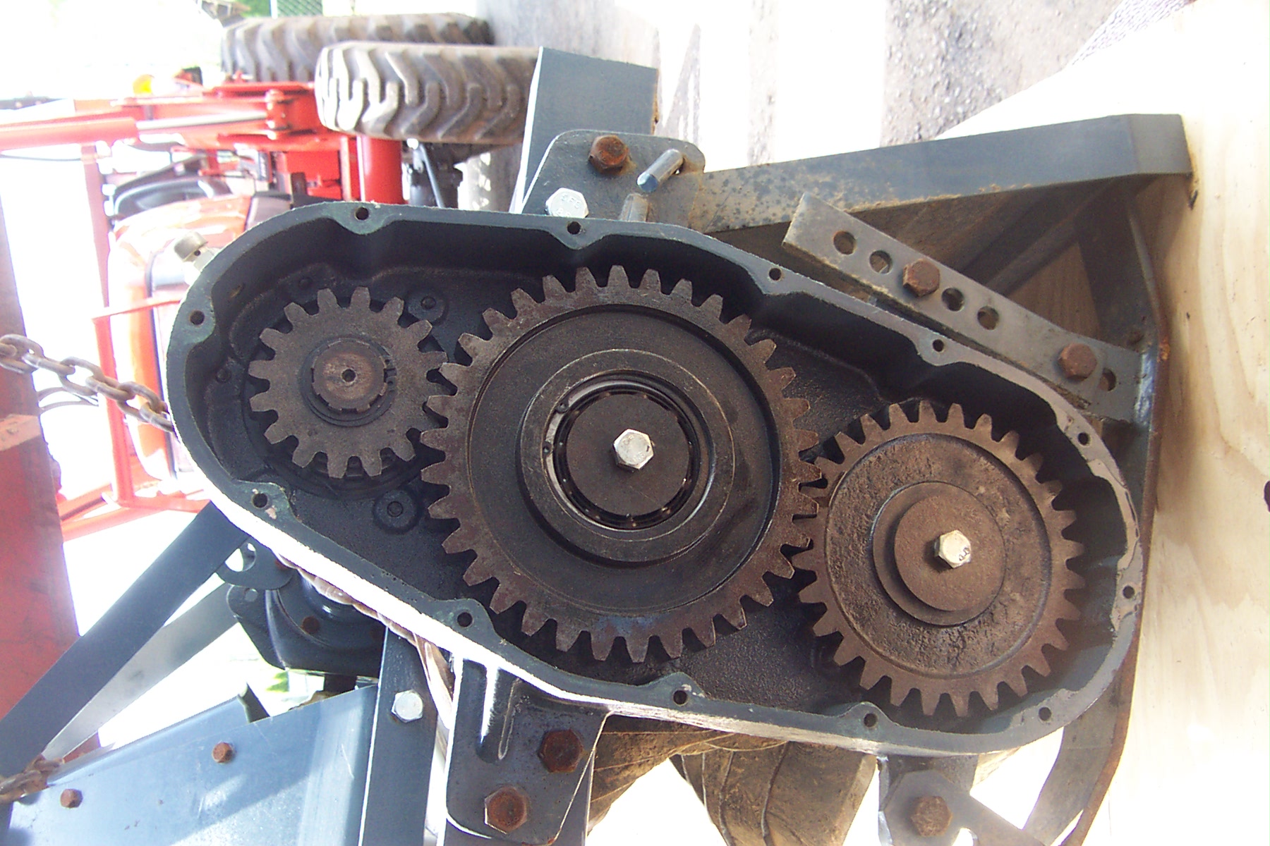

The ironic part about your tiller, is that it uses only one seal, much like the Dark horse tiller. King kutter come with and now my Dark horse have two seals in series. This ends the leaking problem.
I bet you will have room for two seals as well. This should solve your leak problem. How much use has your tiller had before it started leaking?
About 2-3 hours to take apart and 2 hours to reassemble.
The tiller with be out of commission for at least a week waiting for seals.(I have a good source for the seals...ups to you)
You need to take cover off and drain oil.
I wrap a strap around tiller shaft and up around whole unit to hold it up.
(this maintains position of shaft once the side hub is removed)
I also loose bolts on top gear box than slide a 2x4 block of wood, plus wood shim under top drive shaft to keep top shaft raised and maintain it's position.
Now remove top gear in side gearbox. and bottom gear.
Now loosen side gear box cover and remove. This might need a little heat and tapping with a wood block.
Now you will have the hub with bearing and seal in it.
When you get to this part I use heat and tap out bearing.
Now you can get at the new seals, etc.
I freeze the bearing for 24 hours to help with the reinstall.
