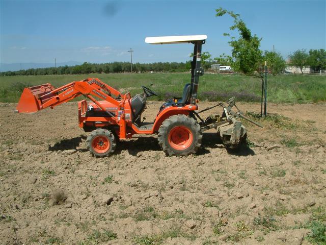

My Mahindra Max 22 rear PTO has 18 hp. What tiller can I run off of the 18 hp? I looked at the Mahindra 4 ft tiller but requires 20 hp. Thank you in advance for your help.
I ran a 48" wide Yanmar RS1200 tiller off my 2005 Kubota B7510HST (21 hp engine, 17 hp pto) with no problem.
That tiller had no shear pin so I had to add a slip clutch in the pto driveline. The lower arms on the 3 point hitch that came with the 7510 were too short. So a used the longer arms from my 1964 Massey Ferguson 135 diesel tractor, the silver-colored things in the photo).
You might think about getting a middle buster plow for your Max 22. In hard ground it helps to plow the soil with the MB before trying to rototill.
