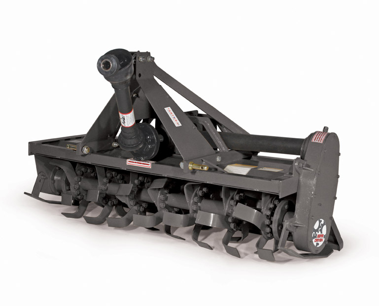

We can ship a Grey in color, 72 inch Tarter Brand, made in the USA, with Gear Drive and slip clutch for $1793 to any business that is in your zip code that has 8-5 hours and offload capabilities. Ken Sweet, Sweet Farm Equipment LLC., Munfordville, Ky.
