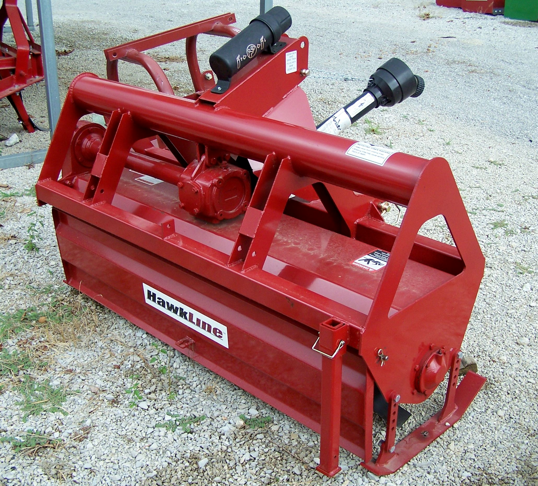

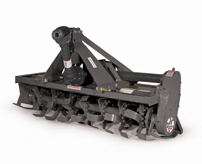

We have the 6 ft Tarter for $1795 and the 6 ft Hawkline by Behlen for $1695. Both geardrive and slip clutch and 6 tines per rotor. Ken Sweet
