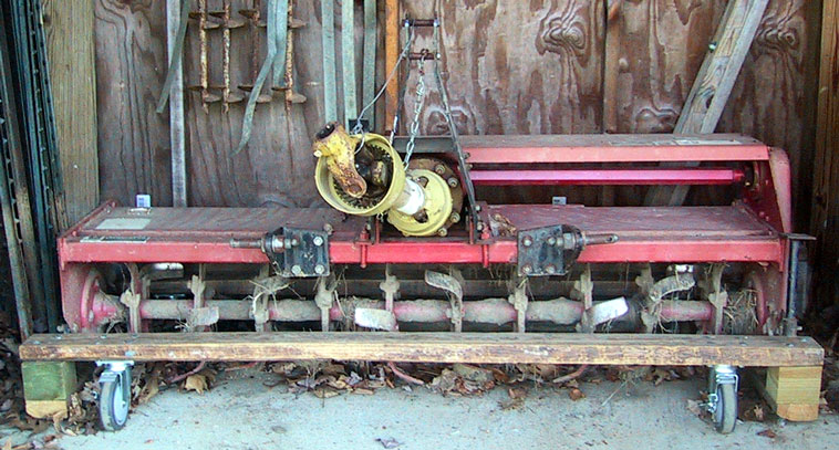

Here's the dolly I built for mine.
The side rails are set to catch the skid shoes and hold the tiller just high enough to clear the ground. Mine has a jack stand as you can see, but I find it's pretty stable in the dolly without using it.
