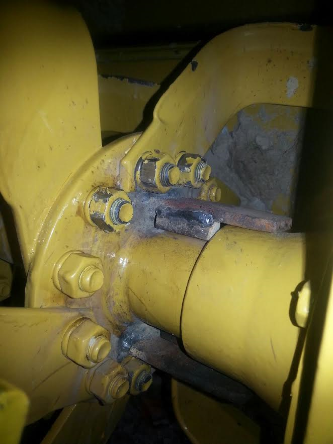

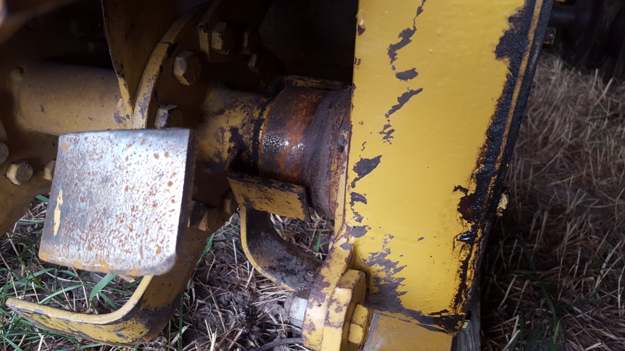

Put this up in parts and repairs... Thought I would put it here also

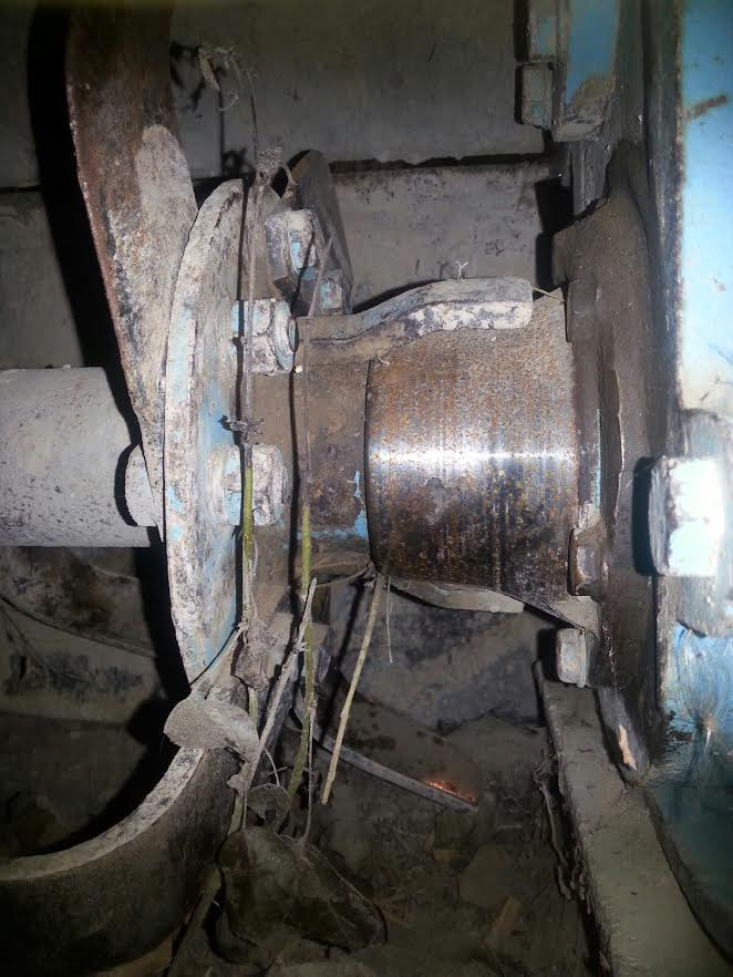

Bought a new KK 60 inch tiller I am very pleased of the build, design and performance. But the Brand new KK lacked something my near 40 year old maletti had, Some extra metal that protect the tiller bottom output seal from damage, oil loss and emanate repairs.
For a lack of a better name, I call them trash guards. I have never had to re seal the maletti tiller and i have had the junk wrapped around this one a time or two:rolleyes:
So I fashioned up some for the new KK give it a go in some alfalfa and nothing made it close to the output seal on the gearbox:D

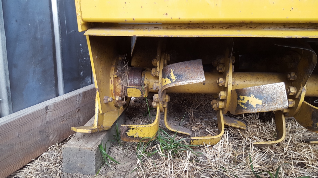

I posted these pics on the other thread, but they apply here as well.
I toured the local Farm/Home lot couple days ago looking at their KK tillers. They had a 5' KK and a 6" KKII. Neither had any sort of guard. Not sure what that's all about.
Here's my 11 year old KKII tiller's guards.

Thanks ovrszd for the pics:cool: Makes me wonder why KK did away with the guards on the tine shaft...
I see the bearing side has guards too.... I just might be inspired to put some over the bearing side now on my KK:D
11 years and the KK tiller looks to be in good shape, must be the trash guards....:laughing:
/ Tiller "trash guards" #9
Not sure how much use it's saw. Pretty sure it hasn't had any repairs done and the seals are good.
It's tilled the occasional rock from looking at the pimples in the top shield. :)
