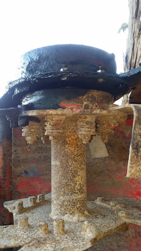

hi folks,
just picked up a tiller which needs a fair bit of work and noticed it has a clutch at the end of the blade shaft rather than where the pto attaches, is this common?? most if not all the others i have seen have the clutch at the splined bit where the PTO shaft attaches,

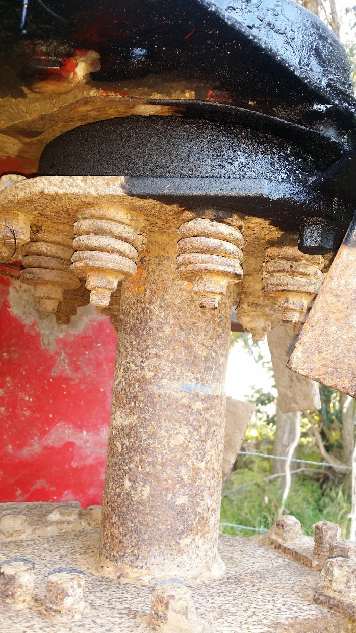

heres hoping i can free the clutch , have backed all the bolt springs off so will give it a go and see if it slips.

- Clutch Not slipping at present, will need to disassemble this and inspect and free up the clutch plates.

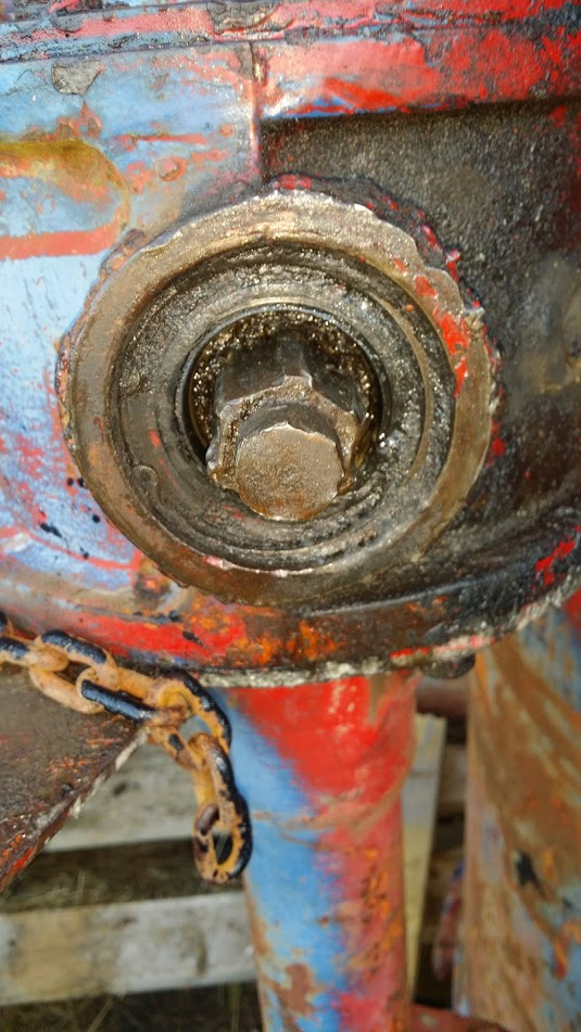

- input spline incomplete and slightly butchered, will need to cut a thread on the end of the input shaft and make up a splined yoke to attach the PTO shaft and mate against the oil seal to keep the oil in and weather out of the gearbox.
