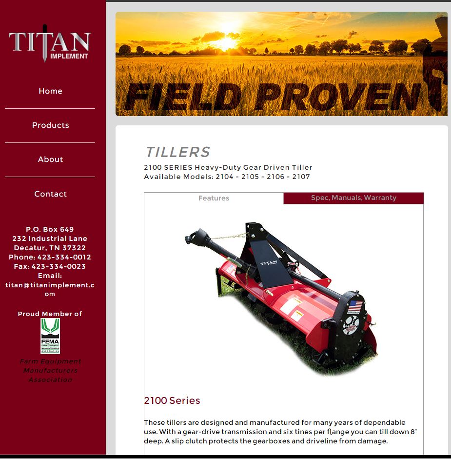

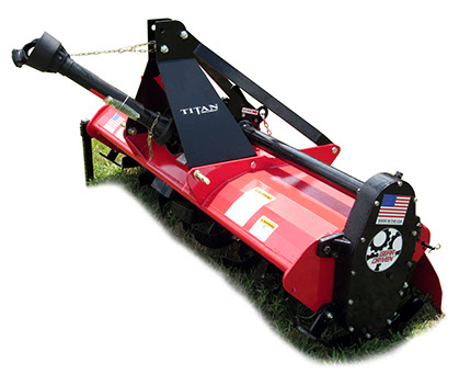

Looks like a different Titan than the forum sponsor: Titan 2100 Series
Sure does look like a KING KUTTER, and several others with gear drive. Guessing they're all made same place, different place.

Think the Titan is just now coming out with the tiller they are some guys that split from another attachment place and started their own in Decatur Tennessee that's what I am hearing

Go back up and read post #10, note the picture. This is what comes up when you click the link:

There are two companies named Titan , one in Memphis Tn and one in Decatur Tn
I did find a dealer selling the 72" Titan tiller for $1700 plus shipping.
It is hard to tell, but from the Titan pictures it looks like it might not be quite as ruggedly built as my King Kutter.
