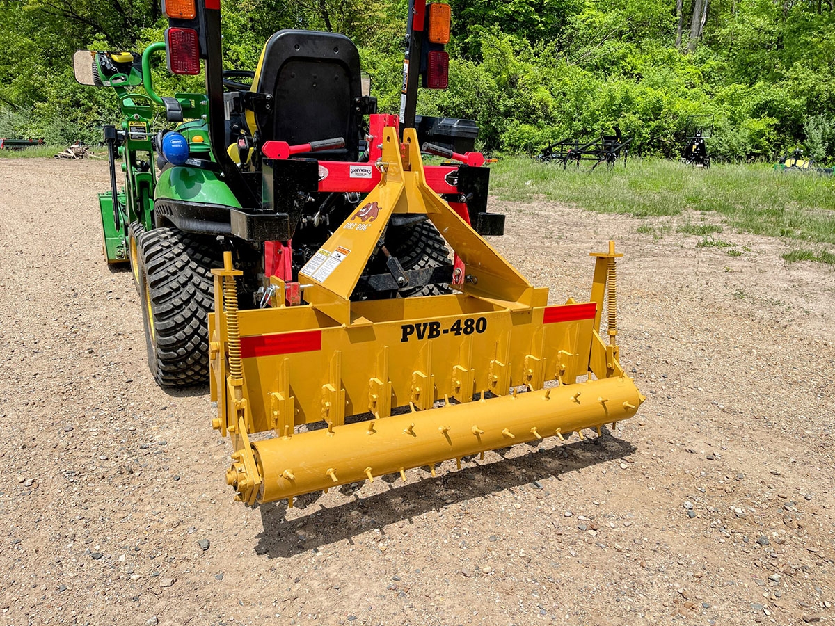

Revisiting this a year later..
In the last year I picked up a 6ft pulverizer… so my thought is to use it to soften up the dirt.. then till it.. that should be a good means to prep it for grass..
Thoughts?

What is a pulveriser???
I am in a different country and have found that US terms are frequently differnt to those in my country. ie US = disc harrow wtf???
To me discs and harrows are 2 completely different cultivation tools with 2 diffferent jobs.
This is a pulverizer

RadarTech, I have never seen an impliment like that before.
