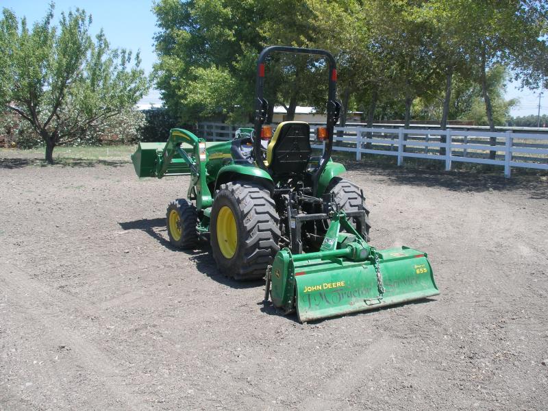

A 655 will cover the tire tracks on a 3320 or 3520 or 3720. With the R-1, R-3, or R-4 tires, as long as the rims are NOT flipped around to wide stance. A 655 has a cut width of 55 inches plus skid shoes on either side = 62 inch width.
The only time you will see tire tracks is when turning. If your property requires a lot of maneuvering then the 665 will cover the tracks no matter what. A 665 plus skid shoes on either side will come out to a 72 inch width.
The John deere commercial tillers are the best out there. I've hit concrete, rebar, wood, car parts, and pretty much everything else without one problem.
In Pic-3320 R-4's, 655 Tiller
