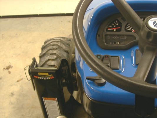

I recommended in an earlier post that the tilt-o-meter might be mounted in an area other than in line of sight on the hood keeping the clean look of the tractor. This is a shot of how I mounted mine on the left FEL support on my TC-40D. As you can see from the picture it is easy to see from the operator position. I used a bit of RTV silicon to mount it so that I didn't even have to drill any holes and if I need to remove it for any reason use a piece of dental floss to get behind the tilt-o-meter to saw the silicone lose. /forums/images/graemlins/grin.gif /forums/images/graemlins/grin.gif
