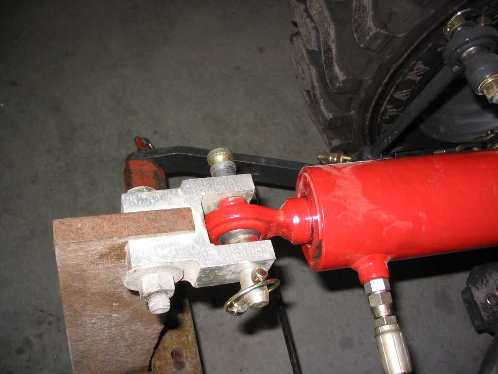

I had a top link that rather then the end break off, just bent the rod, I would have preferred the end break off. You are correct. Looking at the weld, there was very little penetration in Jinman's link . You could do a critical weld and do a grind but bare in mind, you will be heating that rod very hot with the amount of welding that will be needed to do root and filler passes.

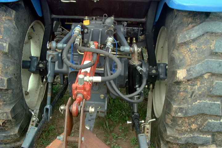

Jinman; You bring up an interesting point. I have a HST and a HLT pair of cylinders on my tip and tilt. I always wondered why the tip cylinder was so long and that it only retracted a short distance exposing approx. 3 inches of cylinder. Your post reminded me of this making me wonder if I got the wrong length cylinder and why it doesn't retract more. It only needs about 6" of travel to be effective. If it would ever fail I would be planning how to clamp it in the bandsaw. By the way... how did you get enough traction to break it? At times I wonder if my 45 could pull the hat off a chicken. jr

</font><font color="blue" class="small">( It reminded me that I need to get in touch with you about a new toplink. Mine is just "okay" and I'd much prefer to have one of yours with the piloted check valve and some small 1/4" hoses. I'll try to give you a call tomorrow. )</font>
I placed my order with Mark and received my new toplink on Monday, 1/3/2005. What a nice experience! /forums/images/graemlins/grin.gif /forums/images/graemlins/grin.gif /forums/images/graemlins/grin.gif
Mark asked many questions to ensure I was ordering the right part and the shipment arrived in good shape and much quicker than I ever expected. Thanks Mark! /forums/images/graemlins/cool.gif
I'll get the toplink installed this upcoming weekend and post a photo. It looks exactly like what I wanted. /forums/images/graemlins/grin.gif
ALSO: I picked up my welded/shortened sidelink from my NH dealer last week and re-installed it. It's much better being 1-1/2" shorter. /forums/images/graemlins/cool.gif The handcrank adjustable link on the left side can now be shortened so that it is in no danger of coming unthreaded from being extended too far. It now sits just over mid-adjustment. The weld on the cylinder's rod also looks very good. They disassembled the cylinder while welding to ensure the seals didn't get overheated. /forums/images/graemlins/cool.gif

Mike, the one I had repaired was my sidelink, whereas the toplink is the one I got from Mark. The sidelink I have works great and seems to be rock solid. Since our lift arms are controlled by a single-acting cylinder in the 3PH, the sidelink is just not as critical ( since if you drop the 3PH too far, it's going to float anyhow).
When I go forward and backward with my boxblade I normally see at least 1" play in the toplink cylinder and that's what I want to prevent with the new cylinder in addition to the fact that my old toplink is really too long for my tractor.
