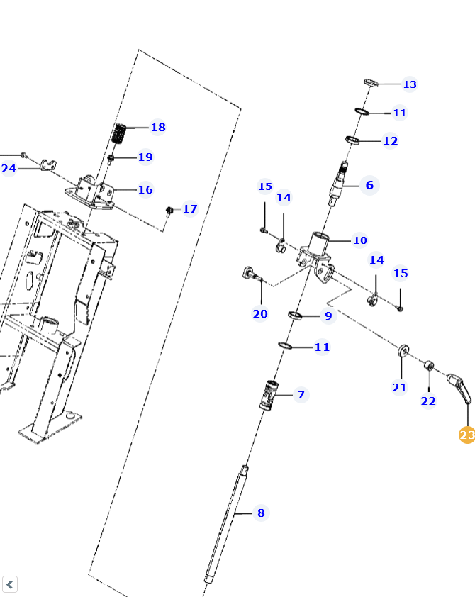

I contacted my service manager, who offered this solution, which worked:
"The steering shaft that comes through the fire wall down to the steering gear is frozen. On that shaft you should see a couple of knuckles. I would bet the knuckles just need some lubrication. Try using a non lithium based lubricant and see if it will work its self free."
If anyone has issues with this, it may be your answer.
Thanks for all the help & suggestions!

I did lubricate #7 from the diagram, as well as #'s 14 & 20.
   / Tilt Steering Won't Tilt #14
Thank you. I will add these pivot points to the list of places to lubricate while I'm doing my greasing.
