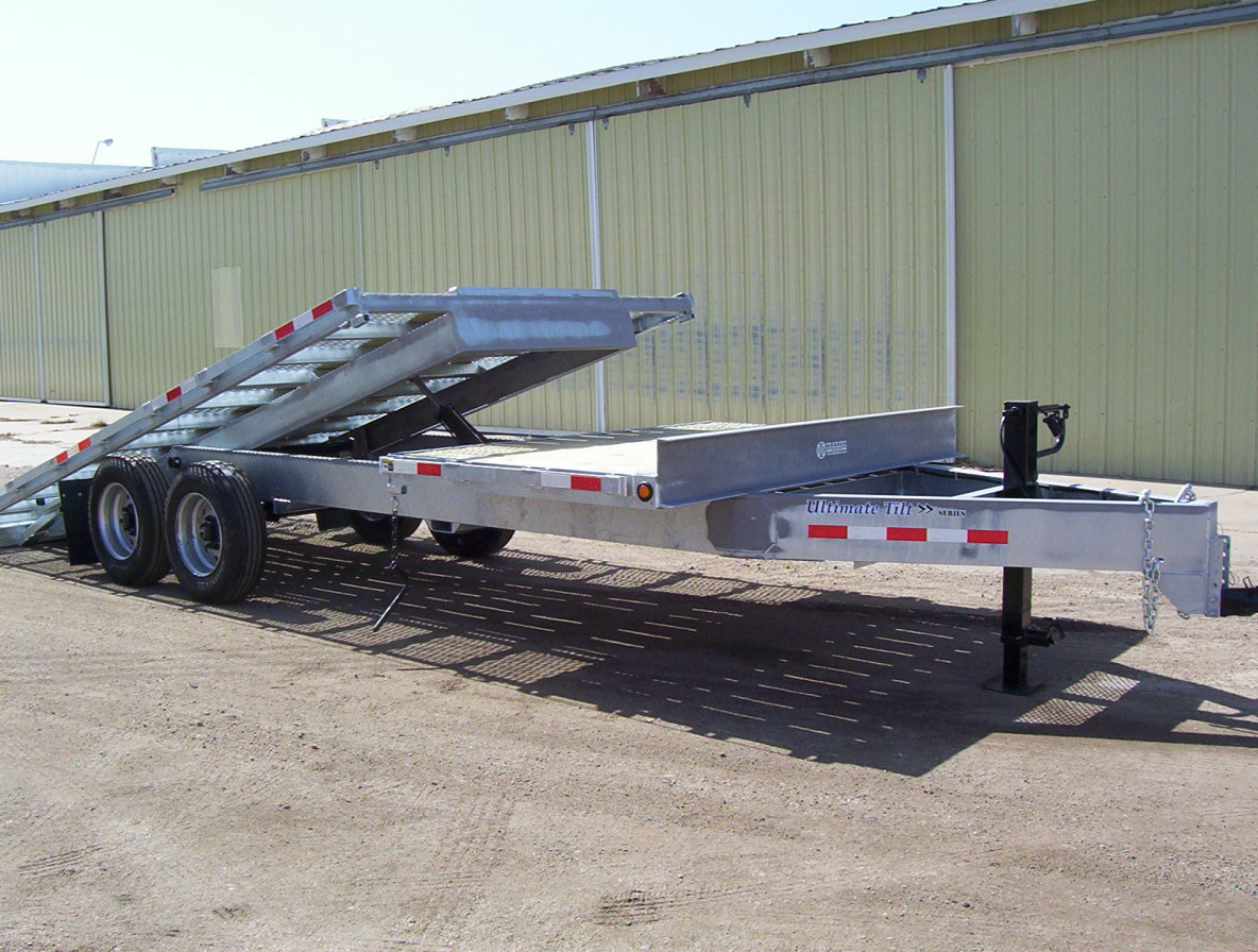

   / Tilt Trailers and load balance #19
Has anybody looked at these guys?
D&K Trailers - Tiltbed Trailers
The tilt pic of the bobcat T300 looks slick.
Thanks,
D.
Yep, this is where I saw the grating deck. I also like the galvanized option.

   / Tilt Trailers and load balance #20
The guy is in Nebraska. I am up there on business on occasion. I might have to go check them out.
