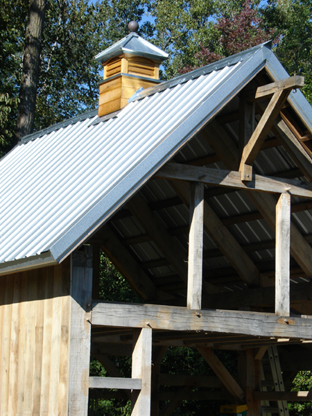

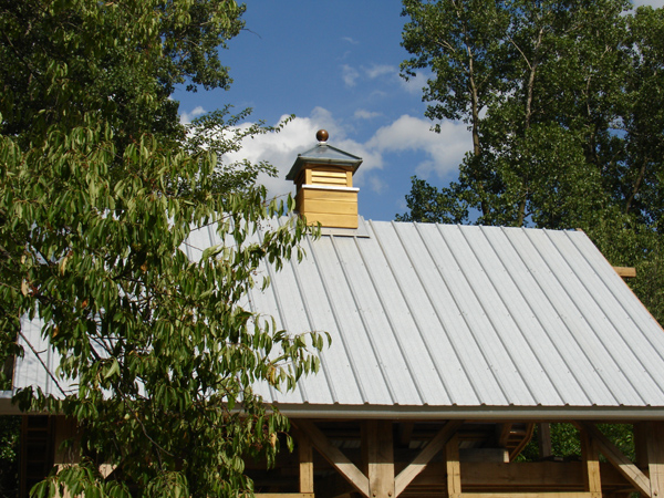

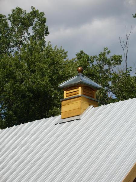

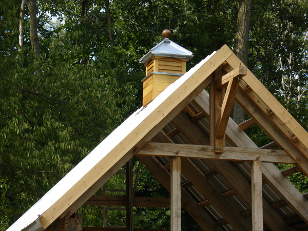

Well my fingers are all sliced up but after another 8 hours the cupola is now complete. The roof is now completely clad in galv. steel and the copper ball is soldered in place. My only concern is I decided not to incorporate the ball in the lightning protection so if it ever gets hit I hope it doesn't start a fire. I guess there is such a slim chance that I'll be okay.
Here are three pictures of the finished cupola.

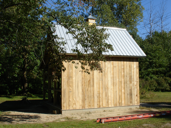

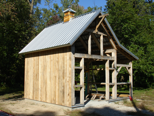

Time for another update. Took a new job and I am commuting between MI and AZ so progress is even slower. I am finally done with the roof and am ever so glad to not be hanging from a ladder anymore. Siding started today and I got the windward side done. I was really afraid that the oak had dried out so much that I would never be able to drive siding nails. Well, the Gods must be shining on me cause the new nail gun and the stainless ring shanks drove right in making the first side done in only a few hours.
The attached pics. show the completed roof and the sided wall. The vertical siding really makes it look tall.
