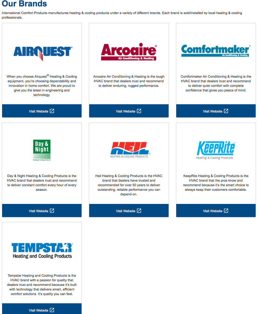

The owner stopped by and specified Tempstar... we bought several which I had the pleasure of installing... ducts, refrigerant, concrete pad, attic pans, electrical etc...
The irony is they don't tell you that Tempstar is Carrier, added they have cheaper lines available than what is listed here...
I can assure you, the name does not make the quality on how long the equipment will last.
BTW, the sound of forced air being anoying is either a question of equipment or duct size not being correctly sized.
