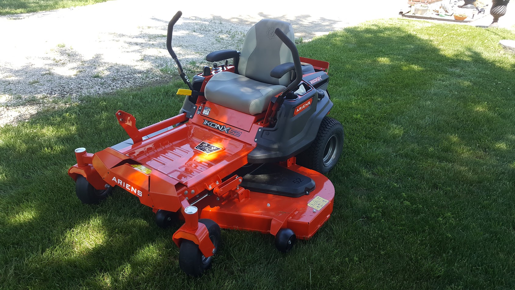

If I was mowing that much I wouldn't get anything smaller than a 60" deck. I mow around 2 to 3 acres and bought a new Ariens 52" deck yesterday to replace my 50" Toro. I would buy a Ferris if money were no object with a Kawasaki engine. Here's what I bought for $3k at Hom ariens.jpge Depot yesterday.
