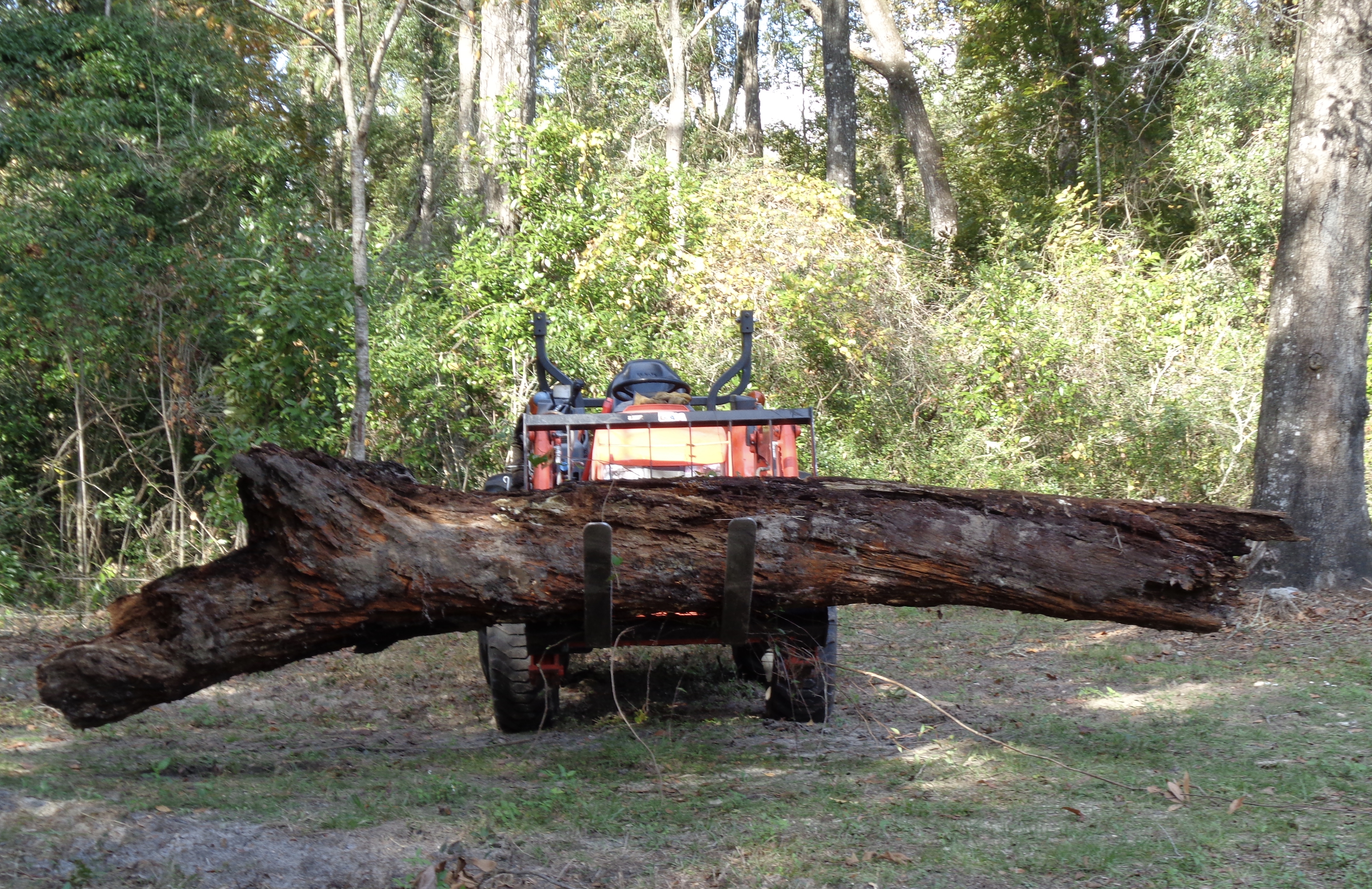

Long Pallet Forks are much more cumbersome when used to pick up brush and trees.
Long Pallet Forks often pierce the ground and get under tree roots when used for brush and trees, preventing lift until withdrawn and repositioned above grade. Consider 42" and 38" tine length.
( Debris Forks are 19" to 22" in length.)
When picking up 40"+ green tree trunks you will regularly hit 3,000 pounds with just one trunk loaded on your Pallet Forks.
When loading and moving brush, the ability to change the distance between fork tines easily is useful. Having optimal spread, narrow for fluffy loads, wider for compacted brush, reduces brush spillage during transit.
SSQA (Skid Steer Quick Attach) coupled Pallet Forks place load closer to the Loader pins, increasing lift, relative to bolt on Pallet Forks. SSQA forks include a rear operator guard which prevents logs from rolling off the forks and onto the tractor hood. Few who use bolt-on Pallet Forks for moving debris will not have had part of a load roll over the bucket and onto the tractor hood.
You need a lot of Three Point Hitch counterbalance weight to pick up heavy Pallet Fork loads SAFELY.
