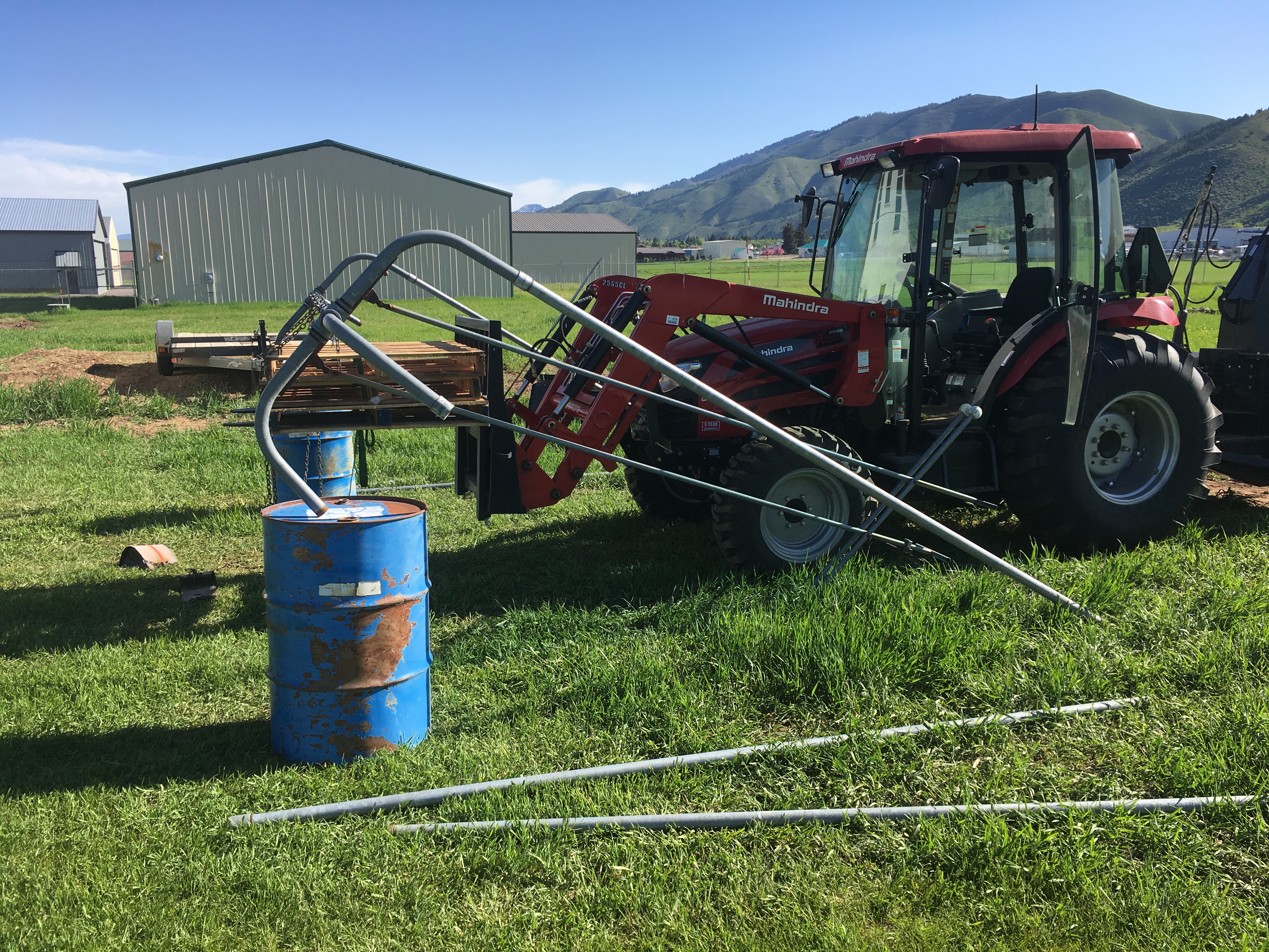

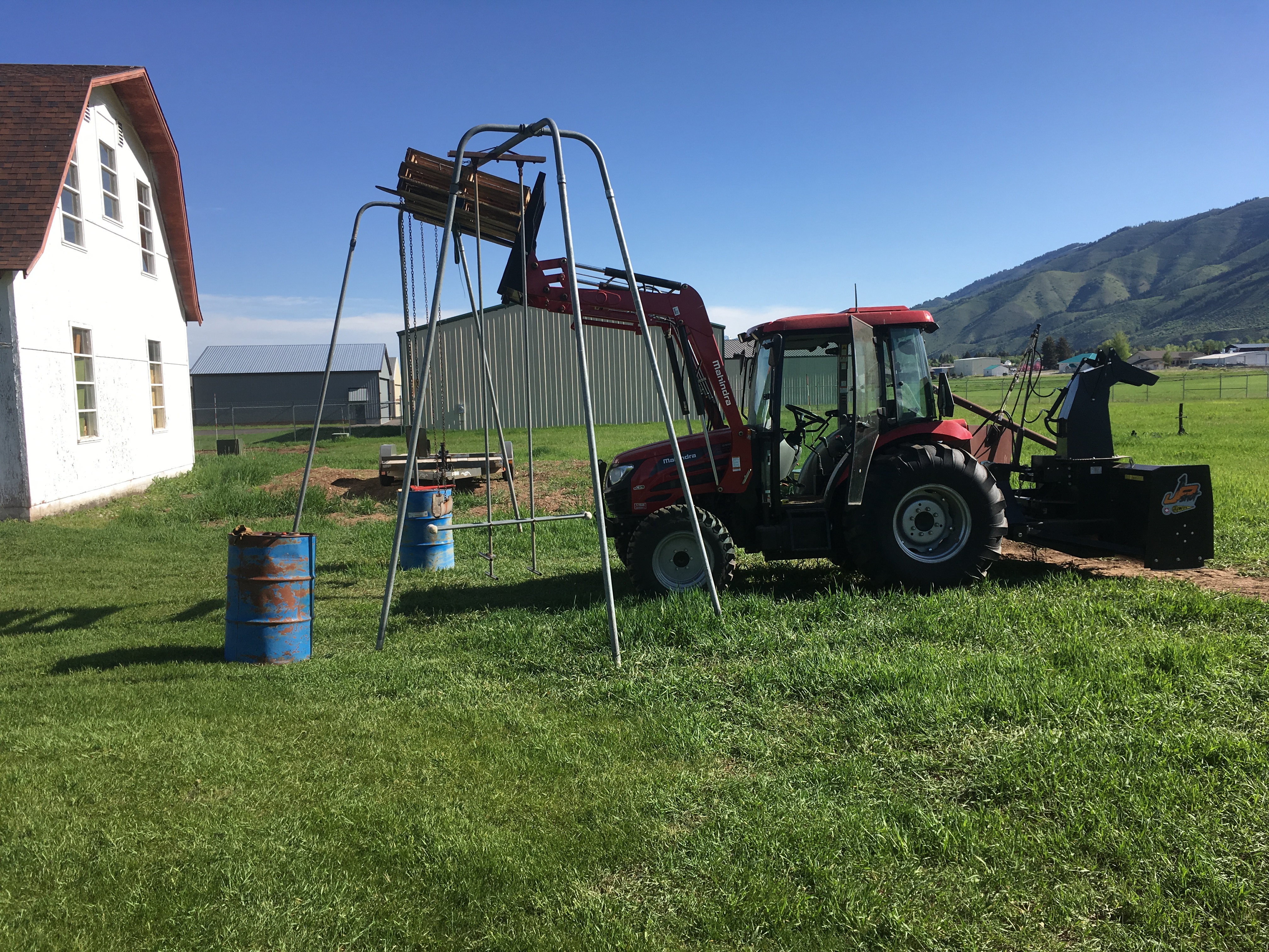

I don't remember what brand mine are but one nice thing about them is I can turn the forks upside down on the back frame if I need extra lift height. As shown in the picture, I get about 2 ft. more lift height by doing that. I've had 3 occasions to turn them over and later this week will be the 4th when some stone masons come to work on my chimney.
Edited to add a closer picture of the forks turned upside down.

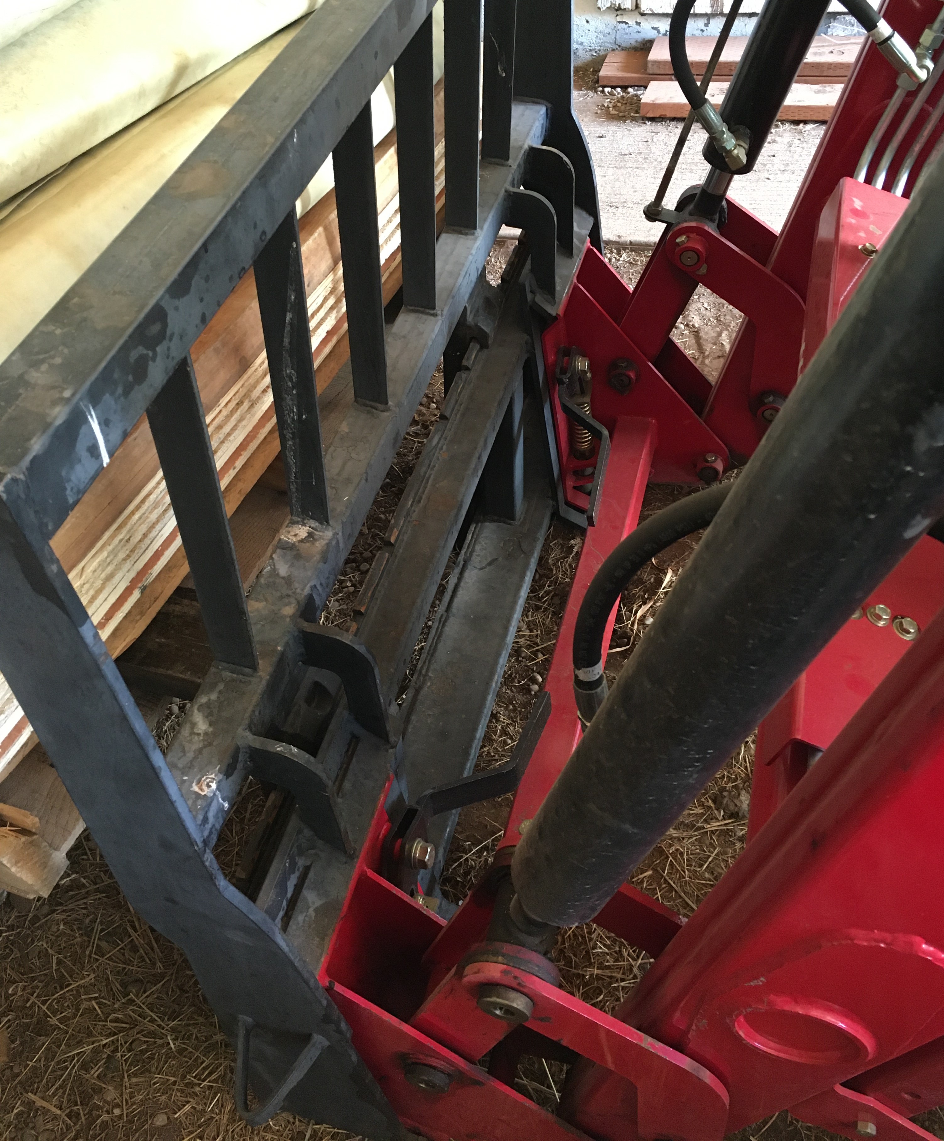

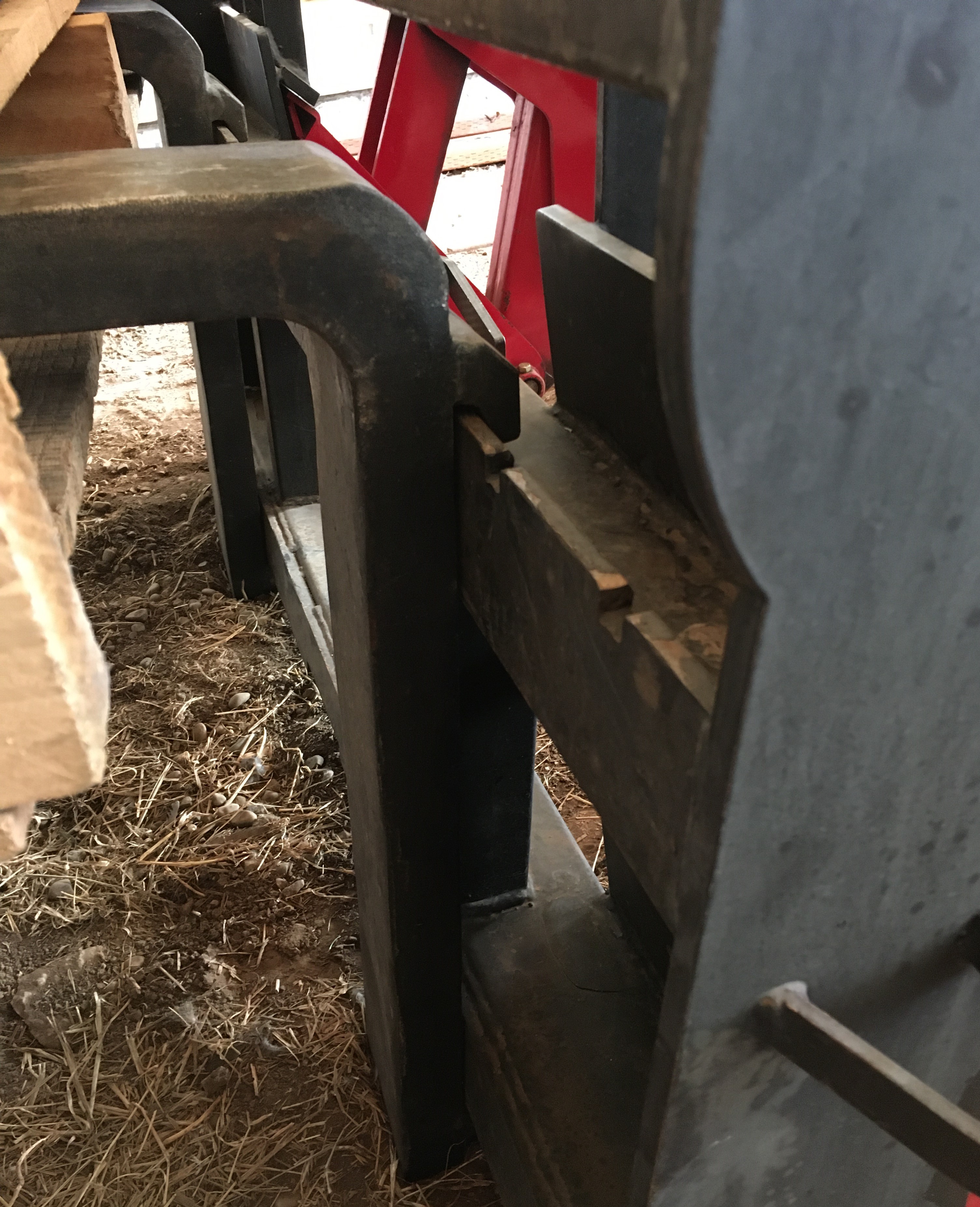

Last night I took a look, no marking on the forks indicating who made them. I also looked up my receipt, no brand was listed, just said 4000 lb. 48" forks. Attached are a couple pictures that may give you an idea of what to look for.

Thank you for looking and posting those. Makes me wonder if many brands can do that??
   / Time. for A Set Of Pallet Forks What about them?? #28
I suspect most brands will do that if they have the upper and lower hooks on the forks. The hook spacing will be the same regardless of which way the forks are mounted.
