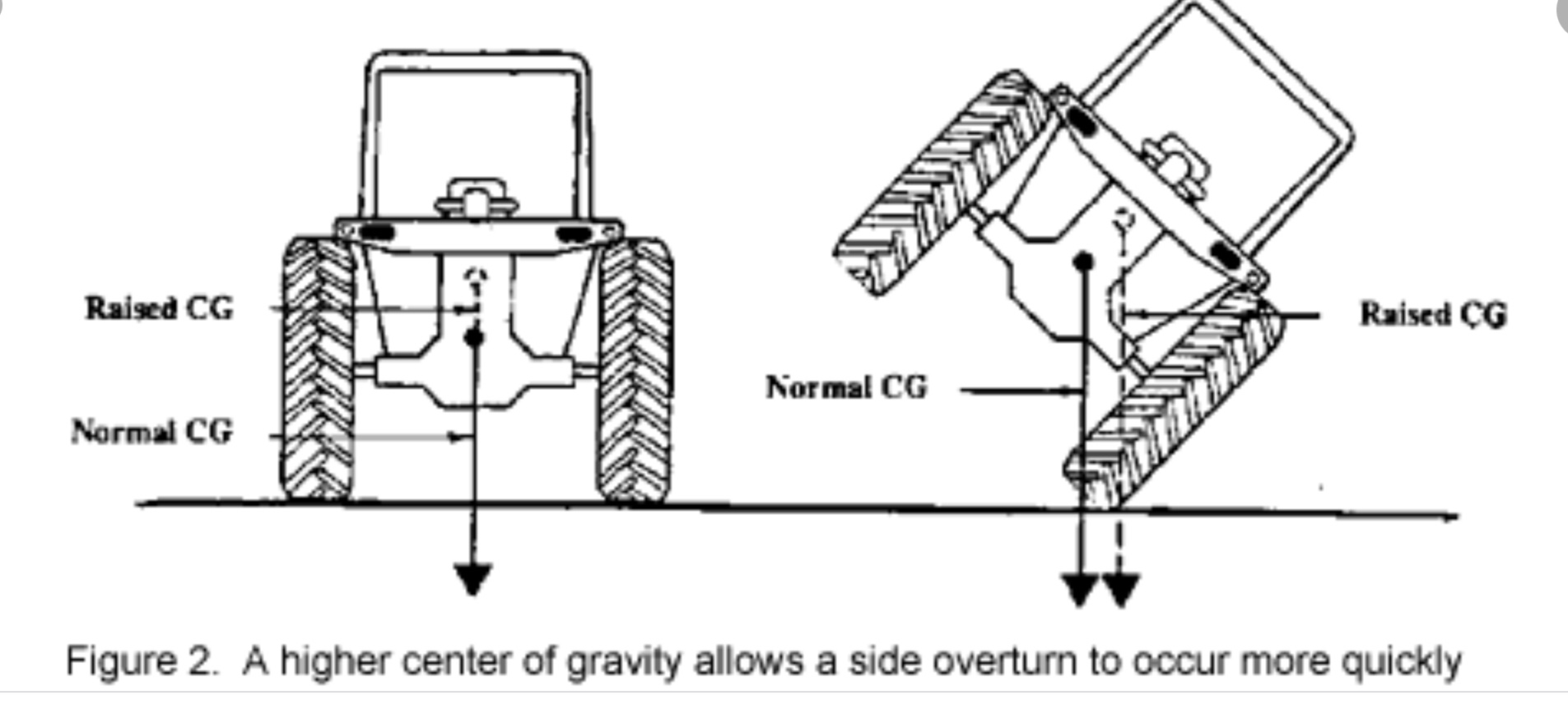

This is what I was referring to before with my before and after pics. When the tractor tips such that the vertical line that extends down from the tractor’s center of gravity moves to the right of the downhill tire, she’s going over.
Widening the tires just a few inches makes a HUGE difference in what that tip angle needs to be before it goes over.
