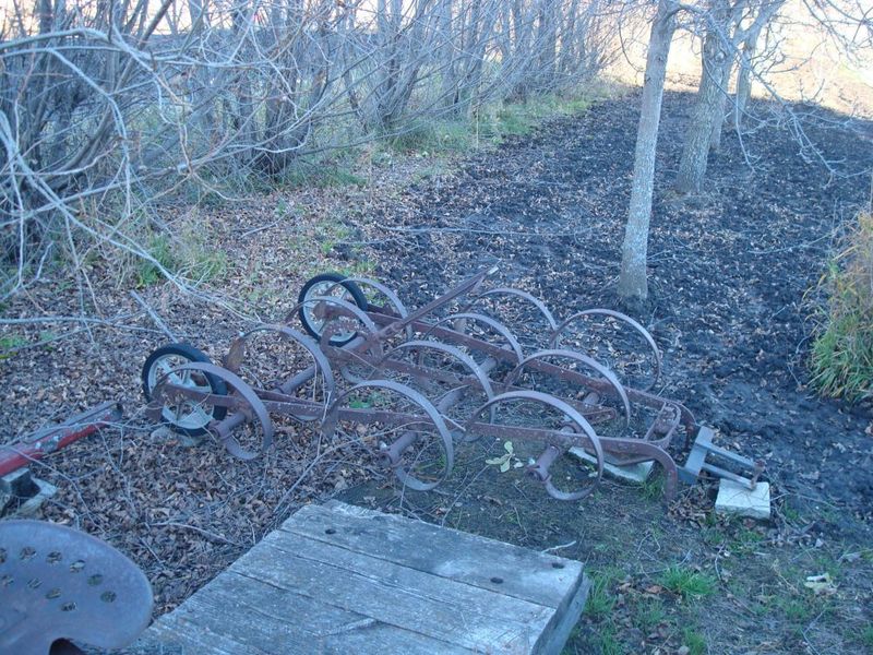

hey all so its time to start thinking about changing from weeds to grass, over the summer i had a skid steer on my property and there are now ruts and trenches that need to be leveled out. I have been thinking of buying an old spring harrow to rip up the weeds/grass and dig deep to break up the heavy clay, then run the tiller over it to get rid of the chunks, harrow, seed and run over with a railroad tie.
Is the spring harrow necessary? i feel that using it will have alot less stress on the tiller/tractor on 3 acres of land of constant high rpm tilling?
the spring harrow i am describing looks like this:
