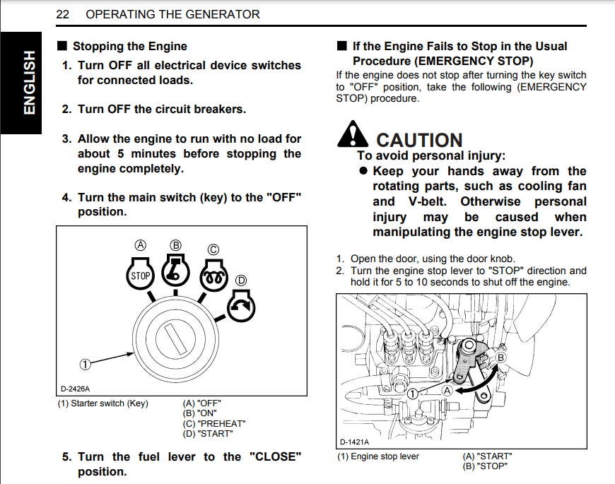

Genset warmups have been discussed, but what about cool down? The manuals in several I've looked at recommend running the engine for 5 - 10 minutes with no load before shutting down. This is the manual page for the Kubota GL11000:
I understand the need for a warmup period, but cool down? In any case, an automatic transfer switch takes neither into consideration.
As posted by several others, it may well be that the relatively low run time of a consumer grade genset is low enough to make these warm up and cool down cycles less important. However, IMO, it's the number of start-stop cycles that counts. The actual run time is irrelevant.
The number of recommended monthly, or quarterly, start-stop maintenance cycles will add up over time.
   / Time to check out the generator. #116
The big UPS generators I was involved with, that had literally zero seconds warmup time, were programmed to run 5 minutes cooldown after the load switched out. They were turbocharged engines though.
   / Time to check out the generator. #117
An automatic transfer switch does take into account warm up and unloaded cool down. But the times arnt very long. Generac uses a temp probe that allows a longer warm up time if ambient temps are very low, but only allows a 1 minute unloaded cool down time.
But one thing, when the home standby is running, and if the enclosure is allowed to remain closed and sealed, the unit pushes a massive amount of air over the engine. This helps keep the engine cool. Running it unloaded places less stress on engine and helps it cool down a bit more before shutting down.
   / Time to check out the generator. #118
Many (most?) automatic transfer switches have the ability to have warm up and cool down timers on the load transfer. For some reason, lots of folks skip the warm up in favor of an immediate transfer, but that doesn't make it good for the generator. Same for cool down. Most of the bigger generators that I have worked with have a 5-10 minute cool down ramp. Given the cost of the generator, the cool down periods always seemed to me to be a smart thing to do. I think that older engines were not as highly optimized for cooling, and often developed hot spots that needed to be cooled to reduce warping and cracking, but that's just an opinion.
Personally, if I have been running an engine under heavy loads, I give it a chance to idle down and cool off, but check your owner's manual, as I have seen advice to the contrary, especially in new engines.
All the best,
Peter
