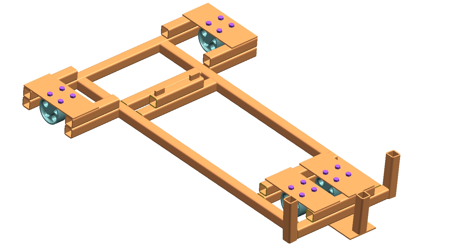

No, my drive is all gravel. Thought about the dolly idea but I'm the kind of guy that overbuilds. Have you ever seen my BH dolly, it's a monster.
You are correct, that is a monster! My dolly solution consists of a stack of Harbor Freight furniture dollies that I pull from. I buy them then they are on sale, stack them so they only take up 2sf of space, and have enough to use under most things in my barn when needed. The snow plow gets 3 although it would probably push easier with 4 under it. Cheap, but they work fairly well.

I think the HF wood dollies would do a good job for most applications and I use them myself. However a BH is big & heavy and for that fact I wanted something with a low center of gravity that would not be apt to tip over when moving the BH around. The one I put together works great.
It does work great. I built mine from Mike's plans and my BH fits like a glove. It was my first major welding project and having Mike's detailed plans gave me the confidence to even start such an undertaking.
I've got the rest of my stuff on wood dollies and that is better than nothing. I need to get up the nerve to design some made out of steel.
