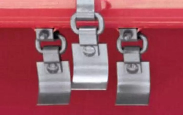

A six foot HINIKER flail crop shredder would be a better option as it has a tight turning radius due to its CV Joint PTO shaft and it will shred the brush up and not leave windrows. It can be equipped with a ratchet jack height adjuster or a hydraulic height adjuster.
