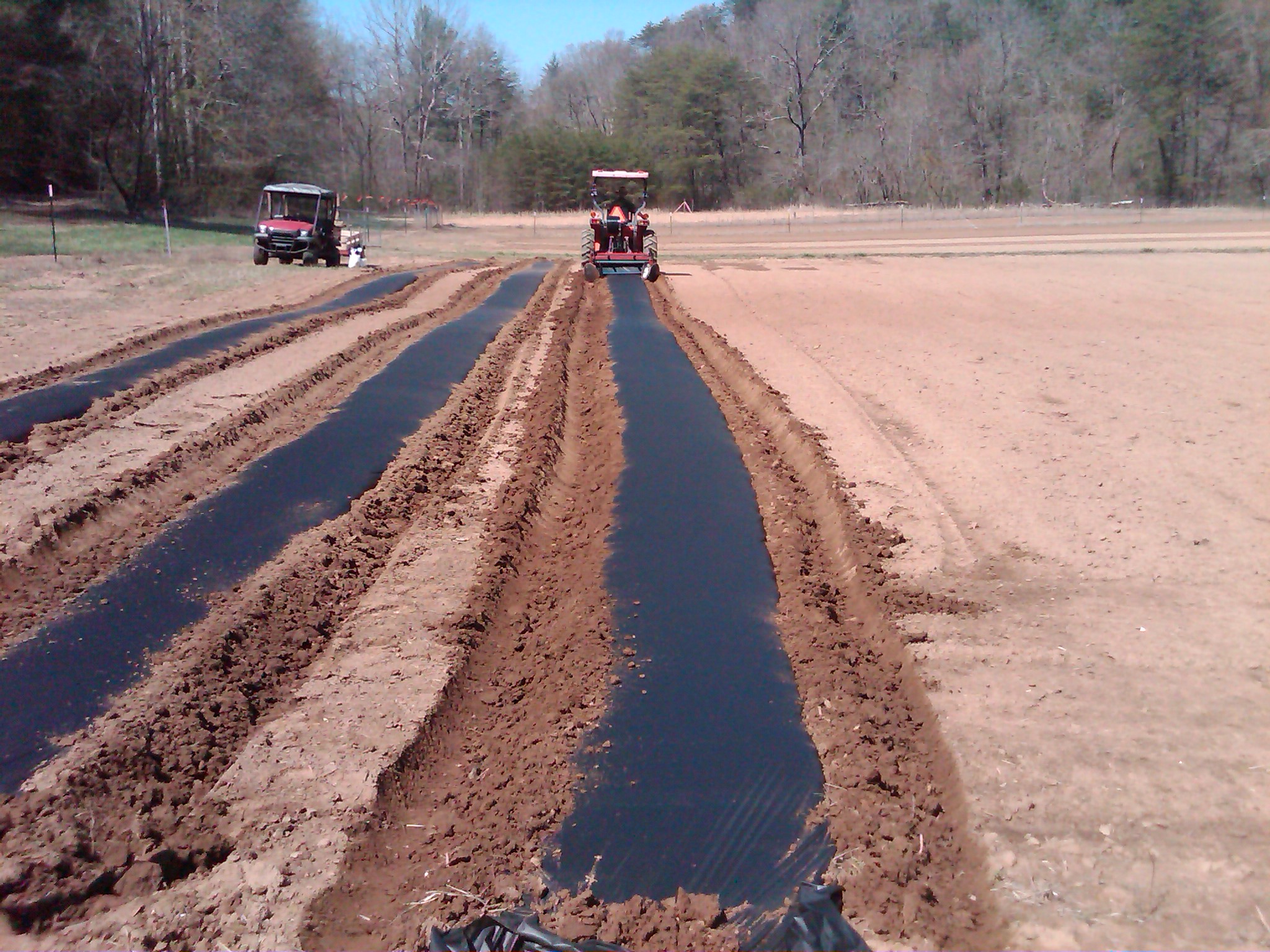

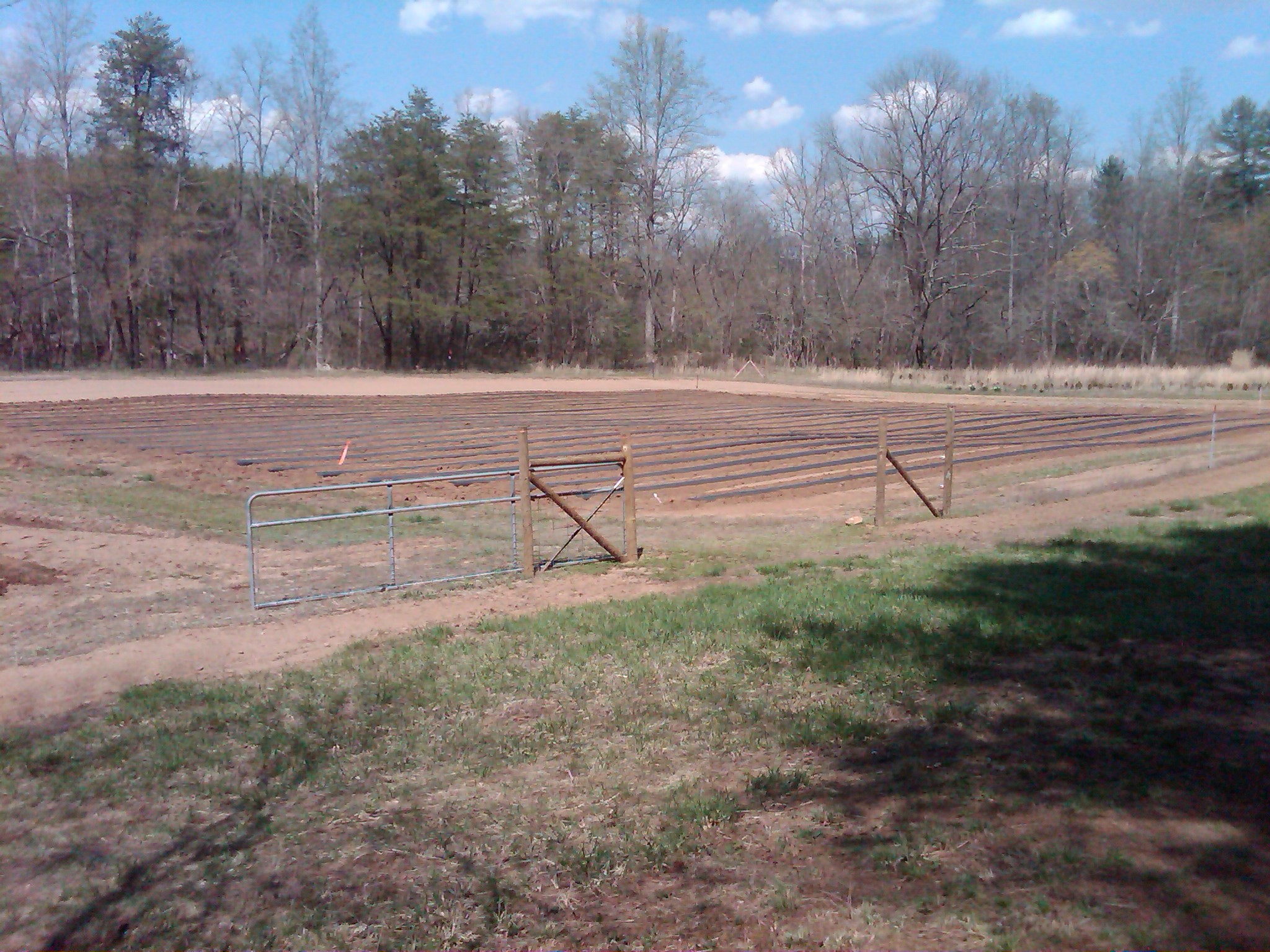

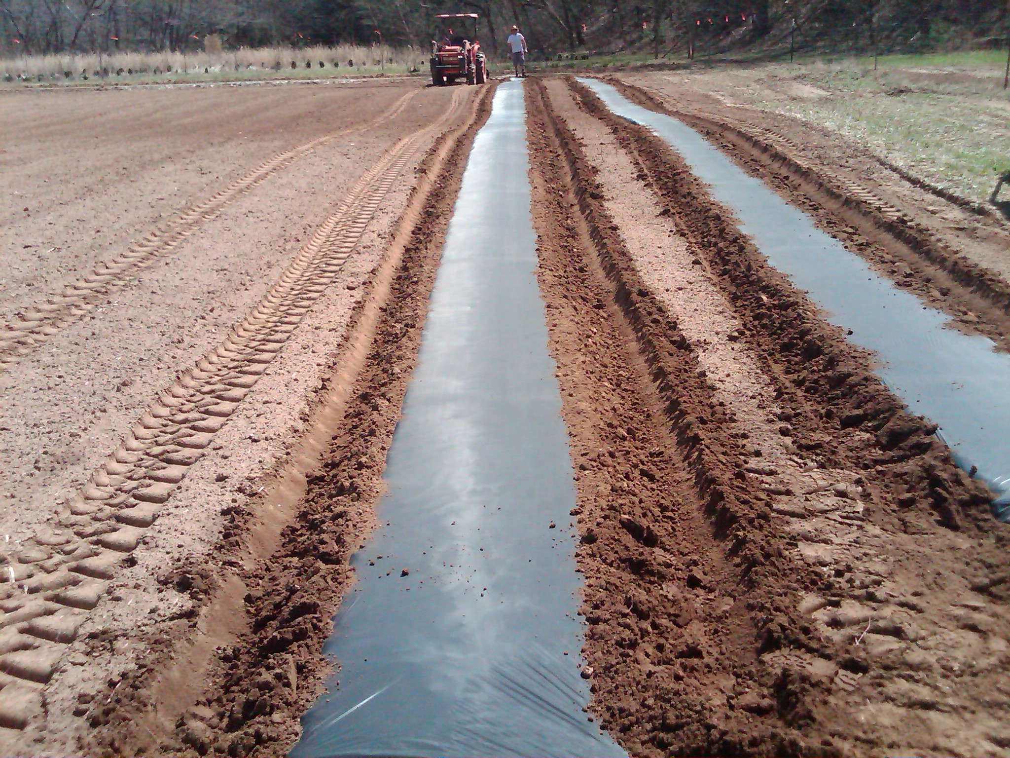

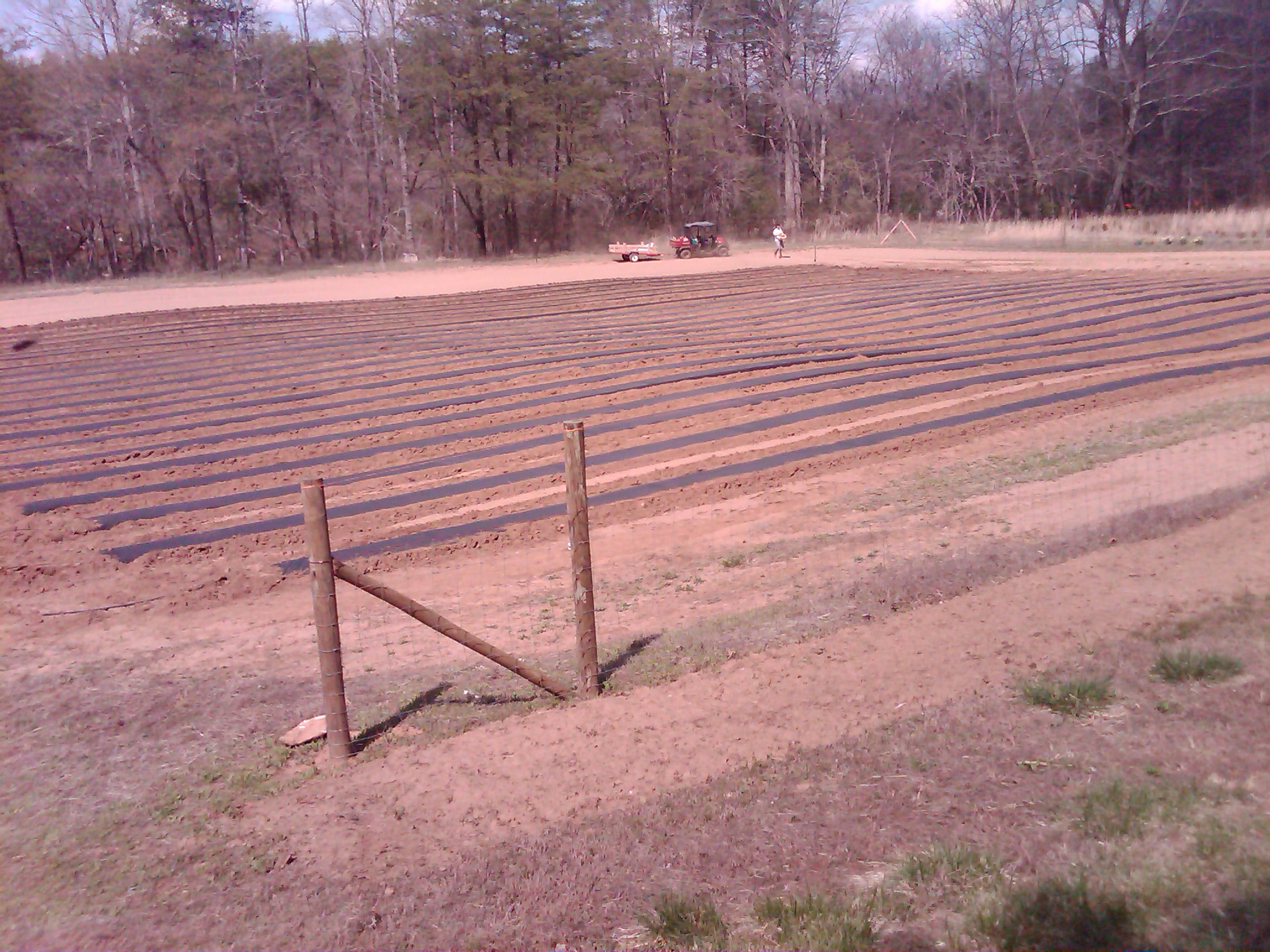

I was able to lay a few rows of plastic Saturday and work the kinks out of my new mulch layer. It took about two or three rows to fine tune all the adjustments needed. Considering this is the first time I have ever used one and basically watched a YouTube vid to see how others did it; I think it turned out ok.
We laid 18-20 short rows (125')and two long rows before other projects called:D. The L3130 pulled the attachment with no problem, and there was no issue getting enough soil pulled in to form the hills. I used 48" plastic and put the drip line slightly off center for the tomatoes and centered it for my double row crops.
I will lay more rows this weekend if its not too wet. I also had the recommendations for lime and fertilizer from my soil test and tons needed per acre. I figured the amount need per square foot for an acre the the square foot for the width and length for the bed. I don't have the numbers in front of me now but it was around 6 lbs of triple 10 and 22 pounds of lime per row. So we would spread that in the row line before bedding the row. No need fertilizing the weeds between the rows and it save a few $$.
I will start laying the mainline and sub-main line for the drip this week or the first of next week. Test everything and run the irrigation 2-3 times before transplanting the last week of April.
I may use this thread to document my harvest as compared to last year when I did not use plastic or drip. This is a learning experience for me.

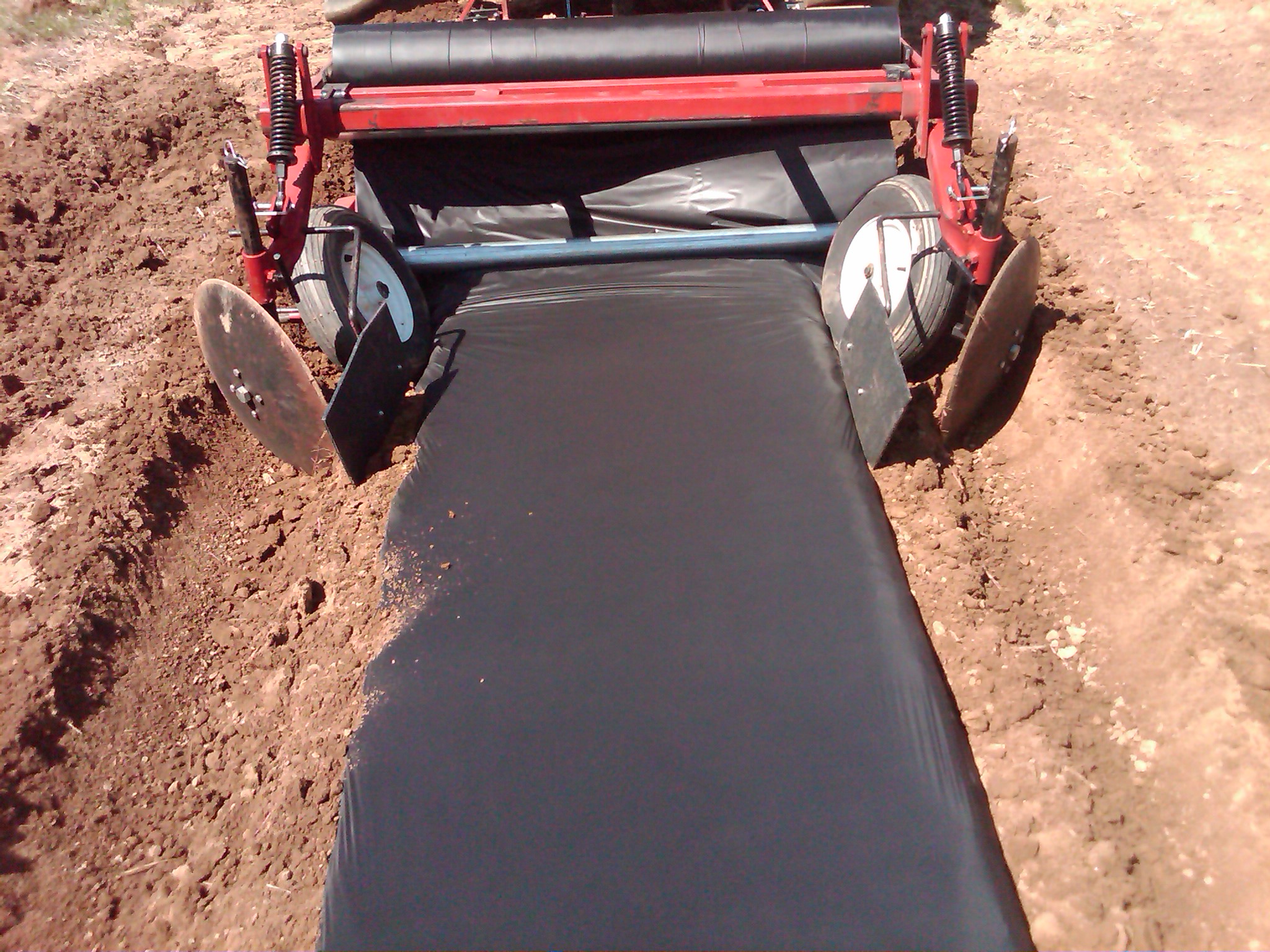

So I guess this mulch laying implement will develop the shape(mound) of the row, lay down the tiny drip feeder pipe, then roll the dirt back over to secure the edges of the plastic. By the size of what you have already completed, in the pics, this is not a home garden. I remember last year the thread where you purchased the machine. Prior to having this ability did you do all this by hand? Will you feed the fertilizer & lime thru the drip irrigation system? I've never seen anything like what you have and we have some pretty large Chinese gardens in this area.
/ Time to Put Down Plastic
oosik,
Yes, this implement does it all. I can lay the drip line ( adjustable depth and offset) and plastic at the same time. It is wider in the front so to pull the dirt in and mold the shape of the bed. The tires holds the plastic in place and the disc cover the plastic with dirt to hold it down.
The initial fertilizer was put down by hand. However I will purchase or make a fertilizer injector to pull the liquid fertilizer thru the drip lines.
Total under plastic will be 1-1.5 acres with the balance in conventional type rows for a total of 2.5-3 acres.
I did all this conventional last year and this should really cut back on my labor...hoeing:D weeding:thumbsup:. I work around 45 hours per week and occasionally have to travel overnight somewhere. So we will see how this goes. Weeding and hoeing like to have got the best of me last year. And once harvest is in full swing the weeds start taking over.

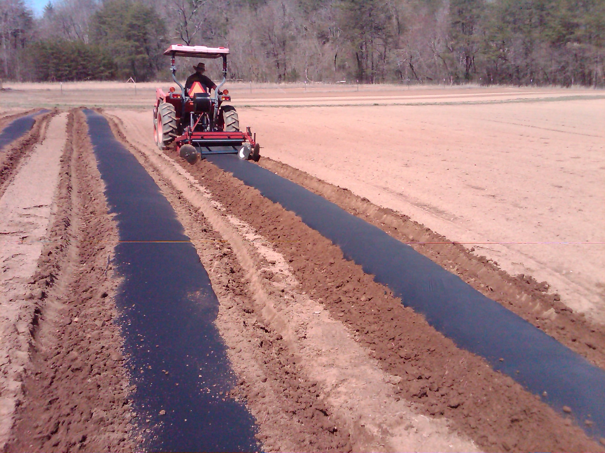

David, your rows are crooked!:D Sure looks good:thumbsup: and that machine is "neater than a sqeeters" p**ter"! You wont know what to do with all the free time now!!

Dennis, The rows are not crooked, my son held the camera at a slight angle:D. Actually he gave me a hard time about not keeping the rows straight, however when I offered to let him drive the tractor...he said they looked fine. Trick is don't look back for too long:D.

On the plastic I will plant around 400 tomatoes, 5 types; 350 pepper most will be 4 types of bell, with the balance being banana, jalapeno, and a few (5 plants each) cayenne, and piquine peppers; zucchini and yellow squash, cucumbers, green beans, okra, and a few other things. I am not sure if I will put cool season crops broccoli and lettuce on plastic this year. I my add those to the plastic for fall once harvest is complete, replacing one of the other crops on plastic.
On the part of the field not shown in the pictures I will have two 180' rows of Athena cantaloupes, and 2-3 rows of Crimson Sweet watermelons on plastic.
I currently have 100 lb of potatoes in the ground, 1500 onions, and some garlic that I planted last October. We will put crowder peas and fordhook limas on plastic or do those conventional.
