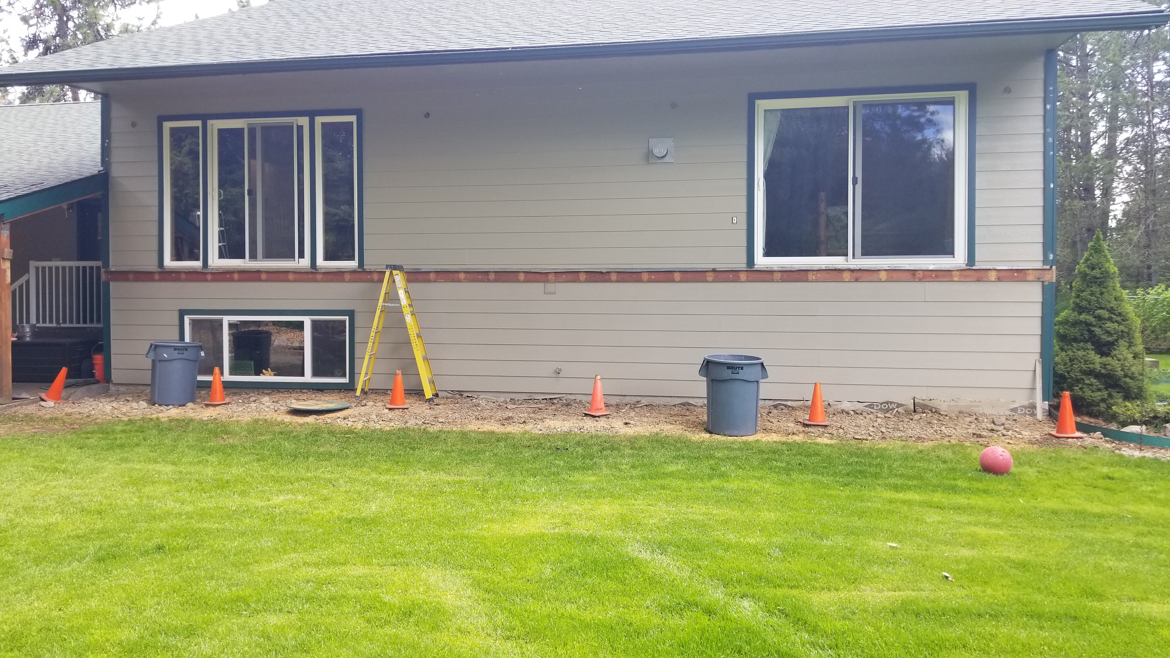

Time to replace my rear deck. 24 years of winters have taken their toll.
   / Time to replace my rear deck. 24 years of winters have taken their toll. #1
grsthegreat
Super Star Member
Jan 26, 2011
13,173
north idaho
Kioti DK45SE hst cab

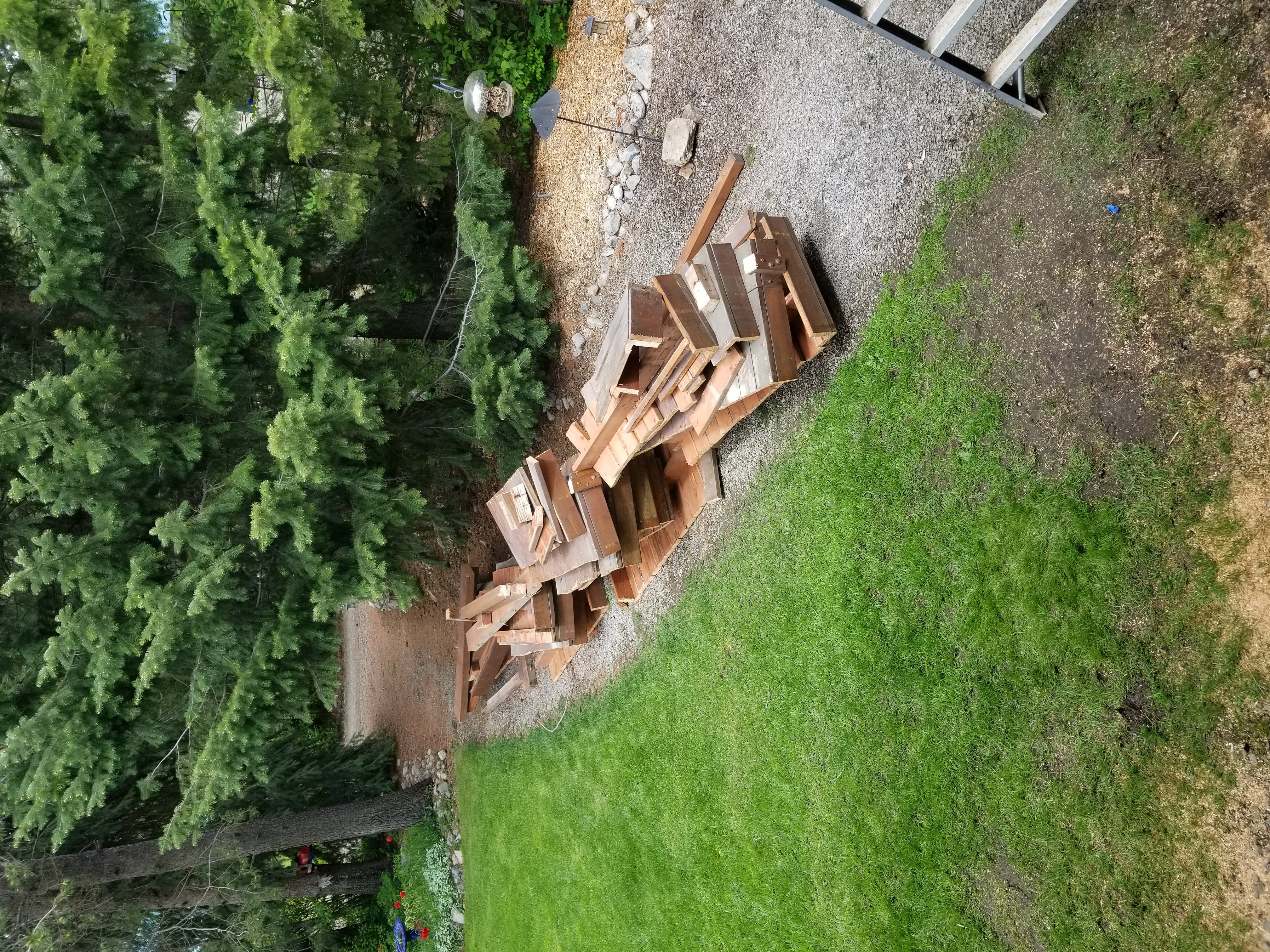

Took all day to demo the stupid thing. Tried unscrewing it.....no way.
out came the chainsaw 27EF97CE-4CBB-4942-93CA-610AF4D276C2.jpeg09AFC04F-7F97-4D94-A644-9F513C4A4B99.jpeg

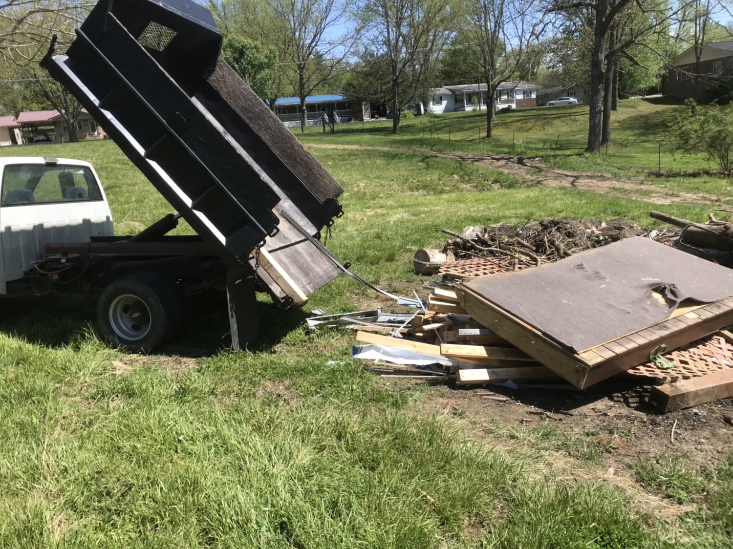

   / Time to replace my rear deck. 24 years of winters have taken their toll. #2
I’ve demoed several decks and cutting them apart is by far the fastest way. Here’s what’s left of the last one I did. I only cut it into 1/3s and loaded it with the tractor. IMG_8638.JPG

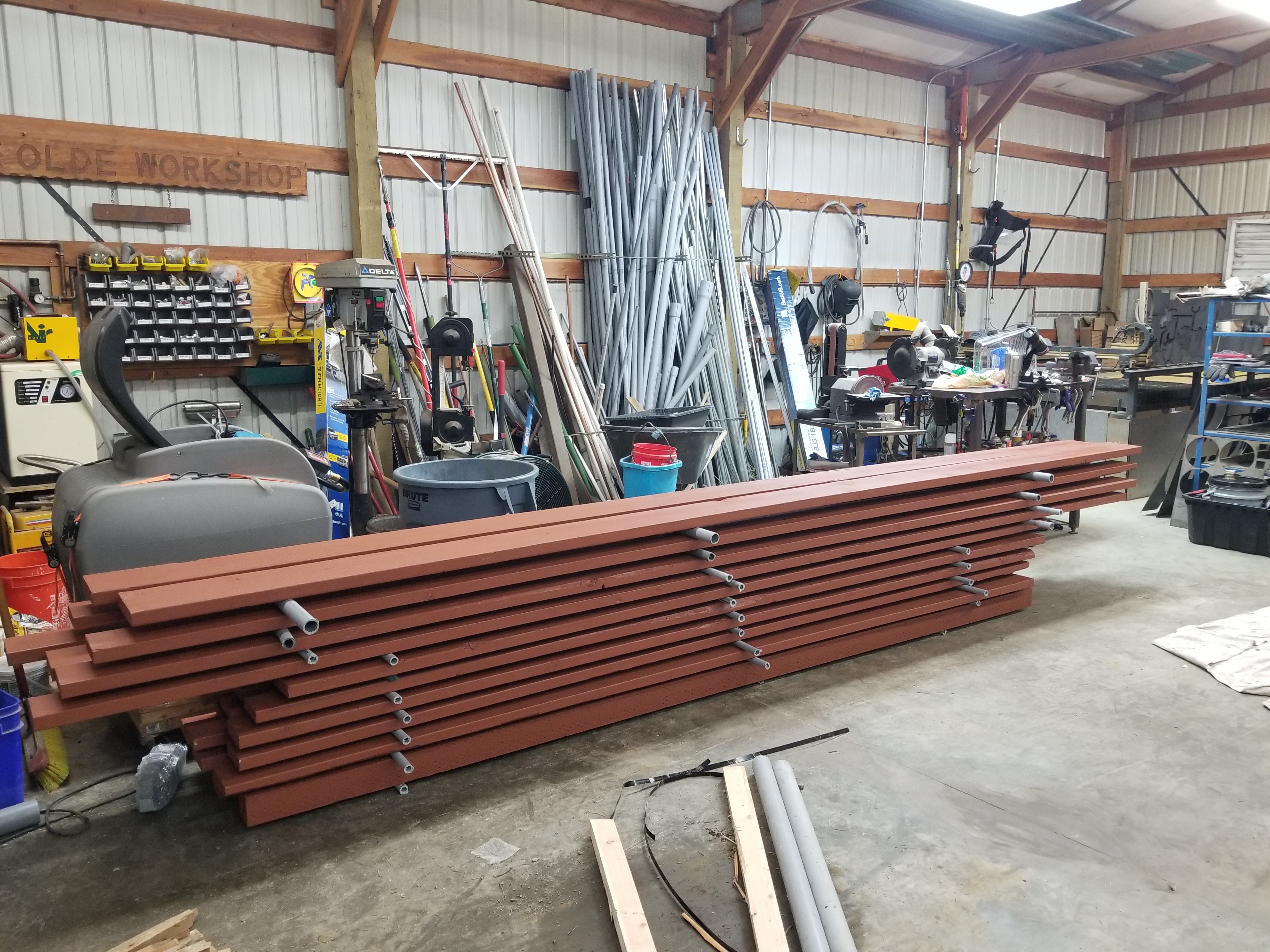

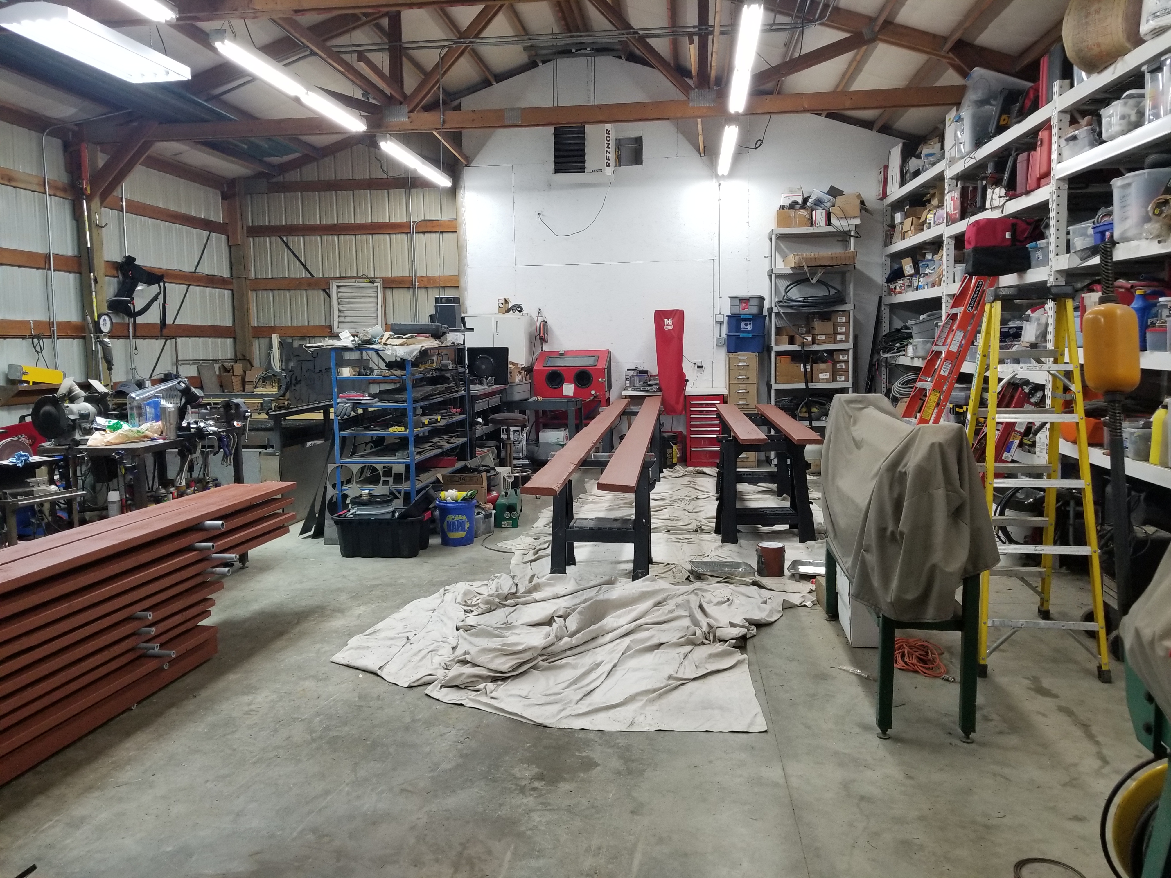

Got framing lumber delivered and painted yesterday. C60CBF1B-F527-4499-A4B8-B5B58C988AF7.jpeg. D0F005B5-4255-49A1-9954-440123721AA9.jpeg

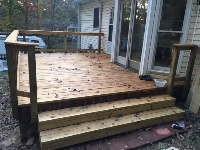

   / Time to replace my rear deck. 24 years of winters have taken their toll. #8
I just finished mine up in the fall. First deck I've built, and the old one was 28+ years old. The new one is quite a bit stronger in design. I went with code all around. No notching, side mounted rail posts with strongties and bolts. The old one was 16' joists 24" on center. I added a center beam with 2 concrete based posts to support the middle of the 16'. changed it to 16" OC and kept the 2x6 instead of going with deck boards

Hey - could I borrow a piece of conduit? Looks like you got some extra... :laughing:
Ya, its amazing how it piles up after 30+ years as an electrician. I ended up cutting some for spacers when painting wood.
