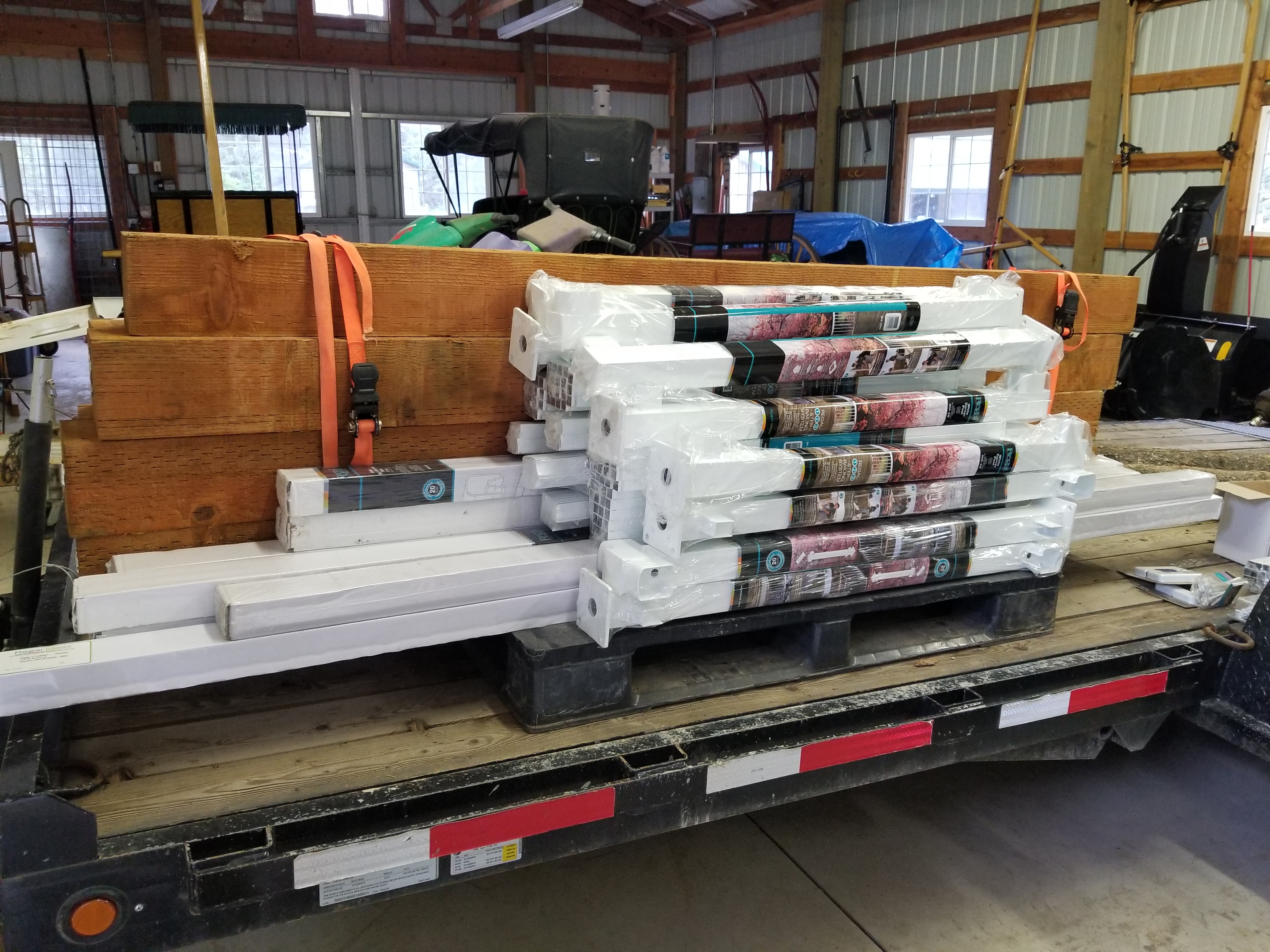

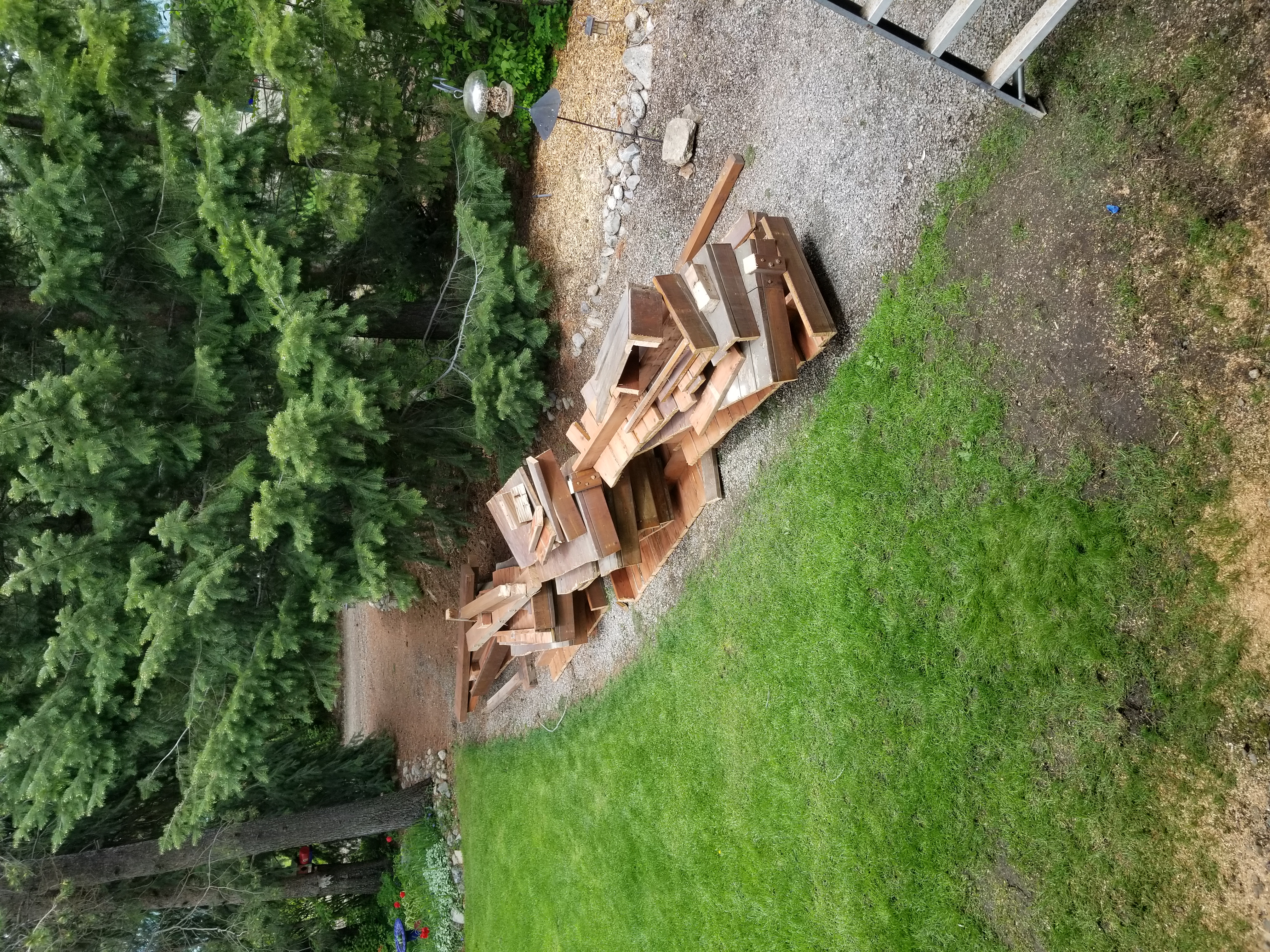

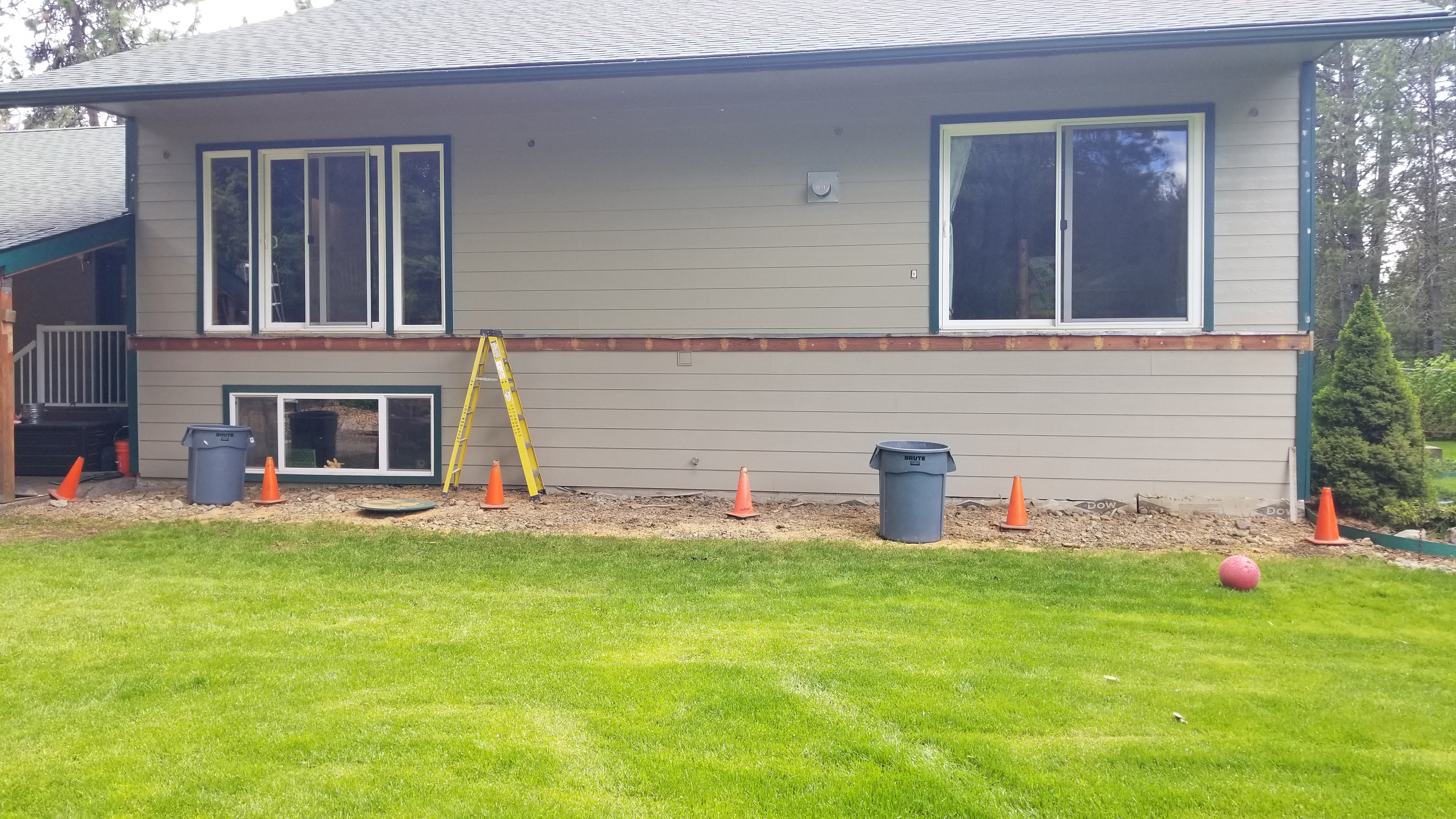

Been raining constantly since i demoed it. Framing timber is stored in shop still. Aluminum decking and the handrail system is stored in carriage barn. Some day ill be able to start,,, if it ever stops raining. Purchased the handrail today...man is that stuff expensive. 0685DD17-B20E-4CA4-9B7F-83D55BC09A0E.jpeg

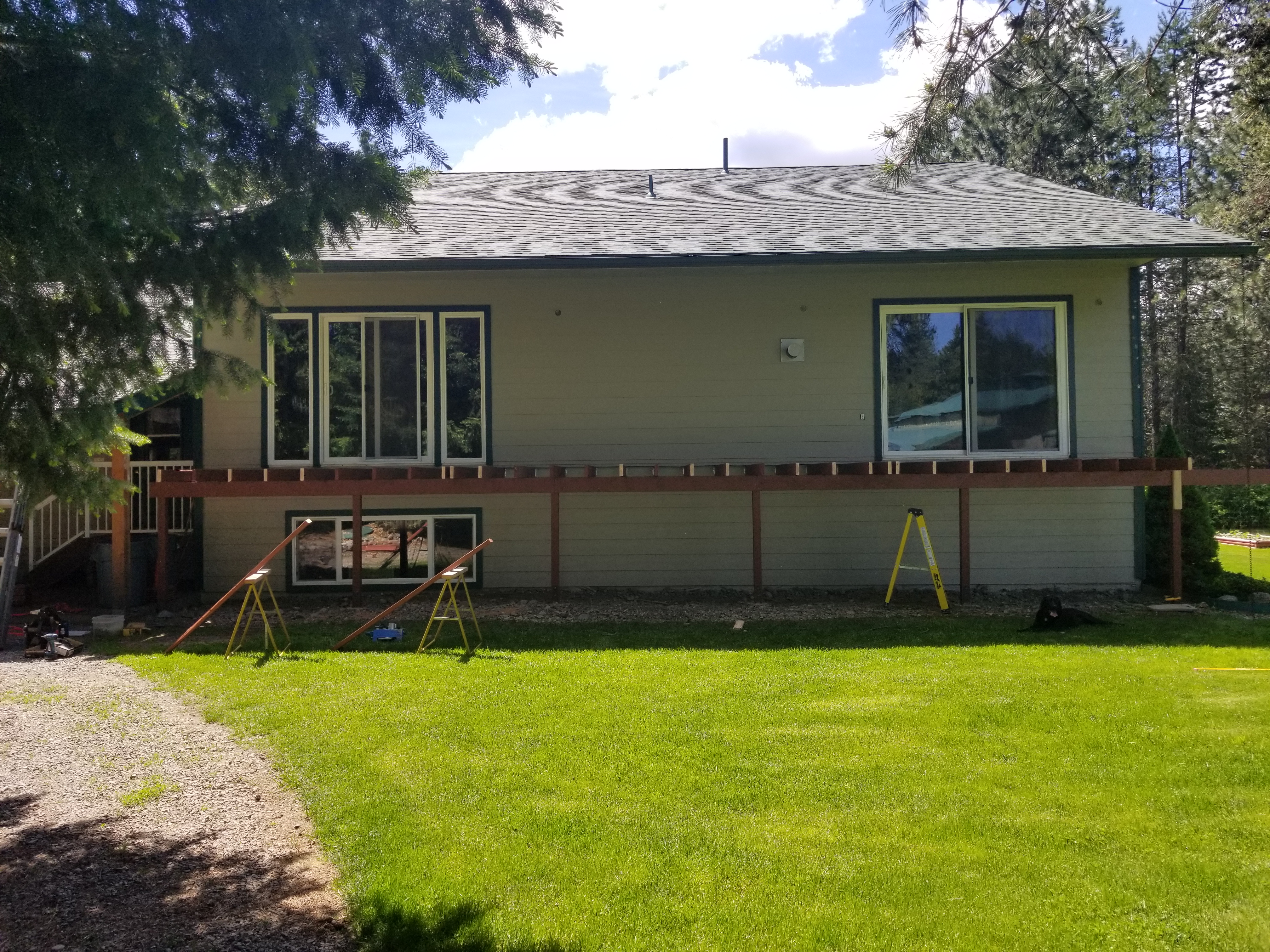

Yesterday i installed framing......92F7A5BF-F8D2-422A-B966-25CA0173D81A.jpeg. 1F3A365F-F9A0-4B18-94B2-4AEEDE898383.jpeg

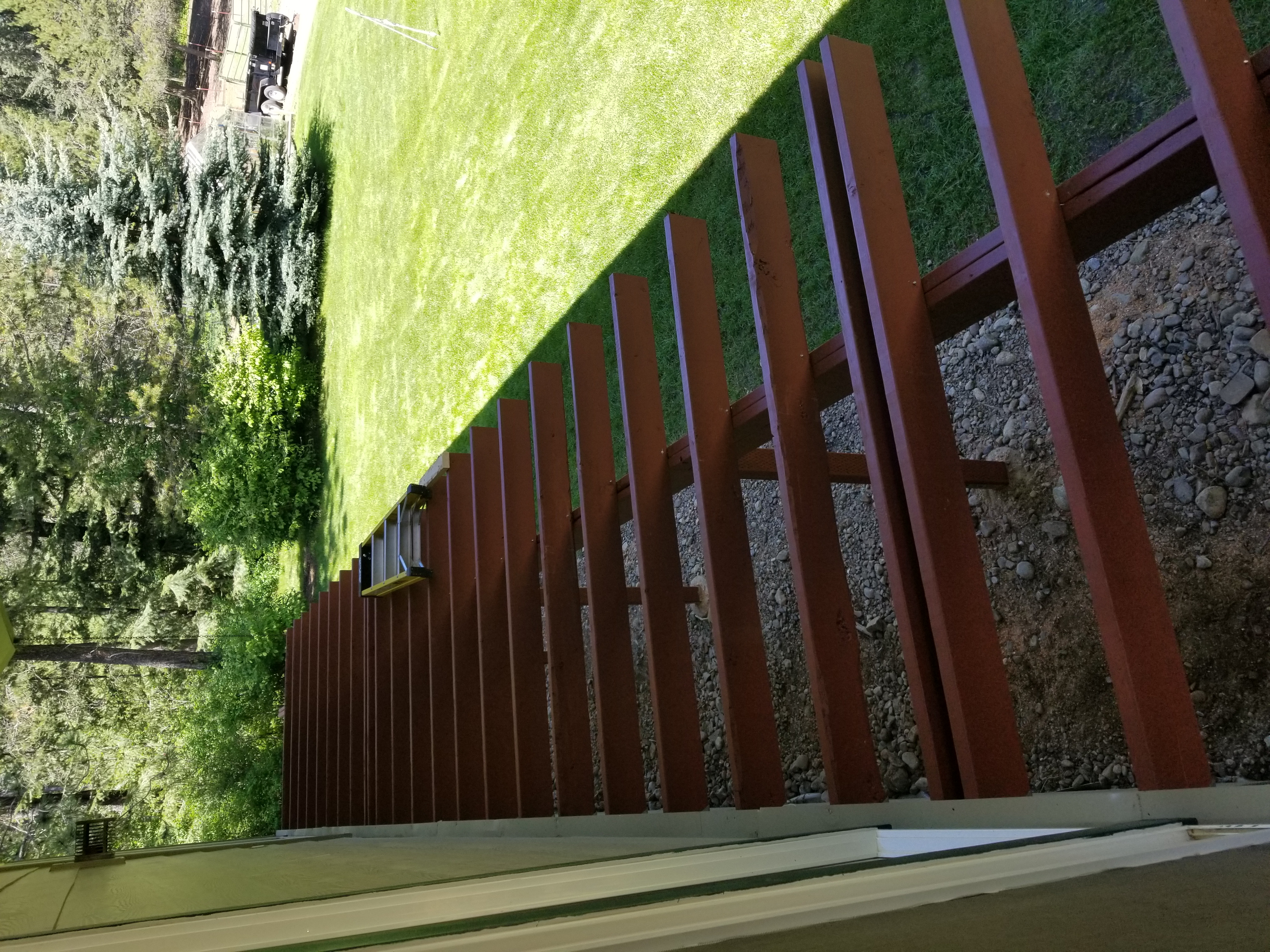

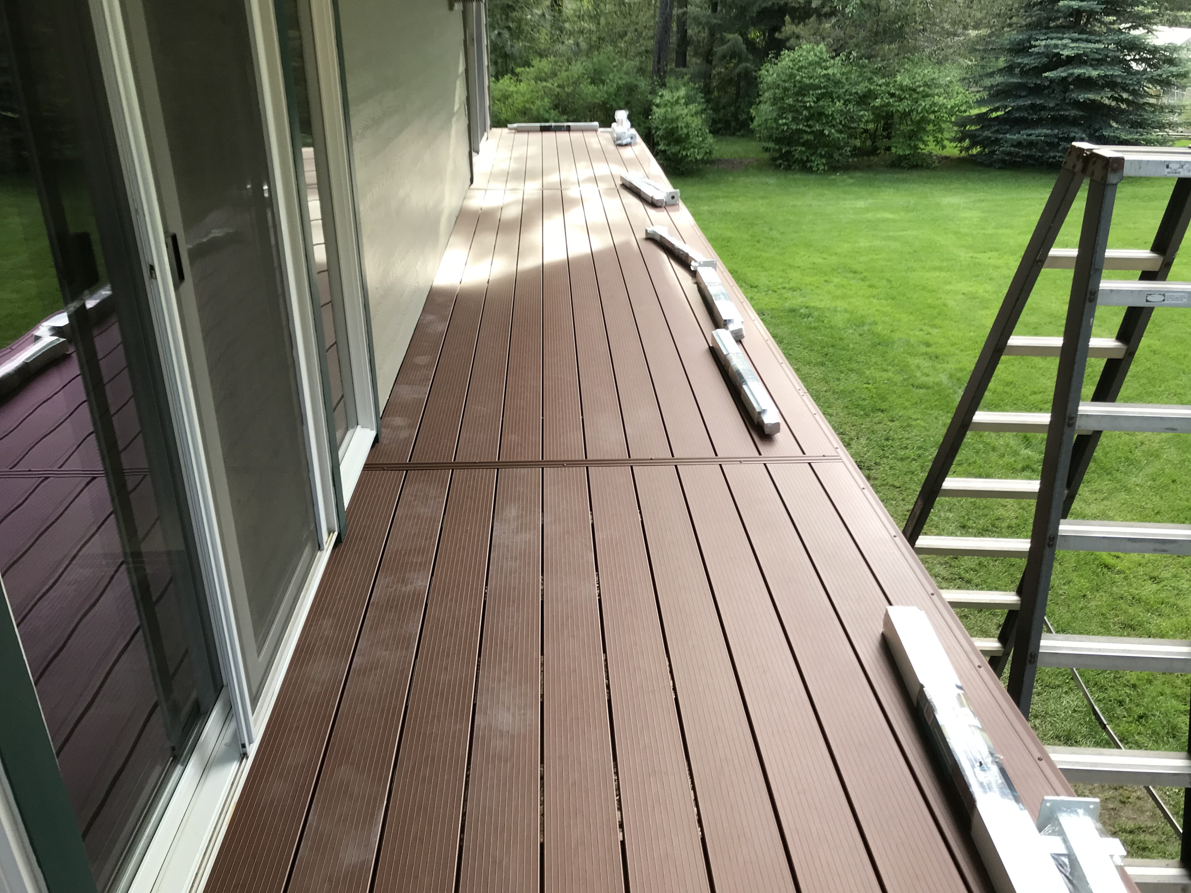

I have to install handrail this weekend

Why so narrow? It looks like it is only 4-6'wide at most. That decking looks really nice. I am with you on zero maintenance decking. I built my covered decks to be tiled with porcelain to ensure never having to stain a deck again...
   / Time to replace my rear deck. 24 years of winters have taken their toll.
#36
6 ft wide is all i wanted. The roof overhang is 6.5 ft.
