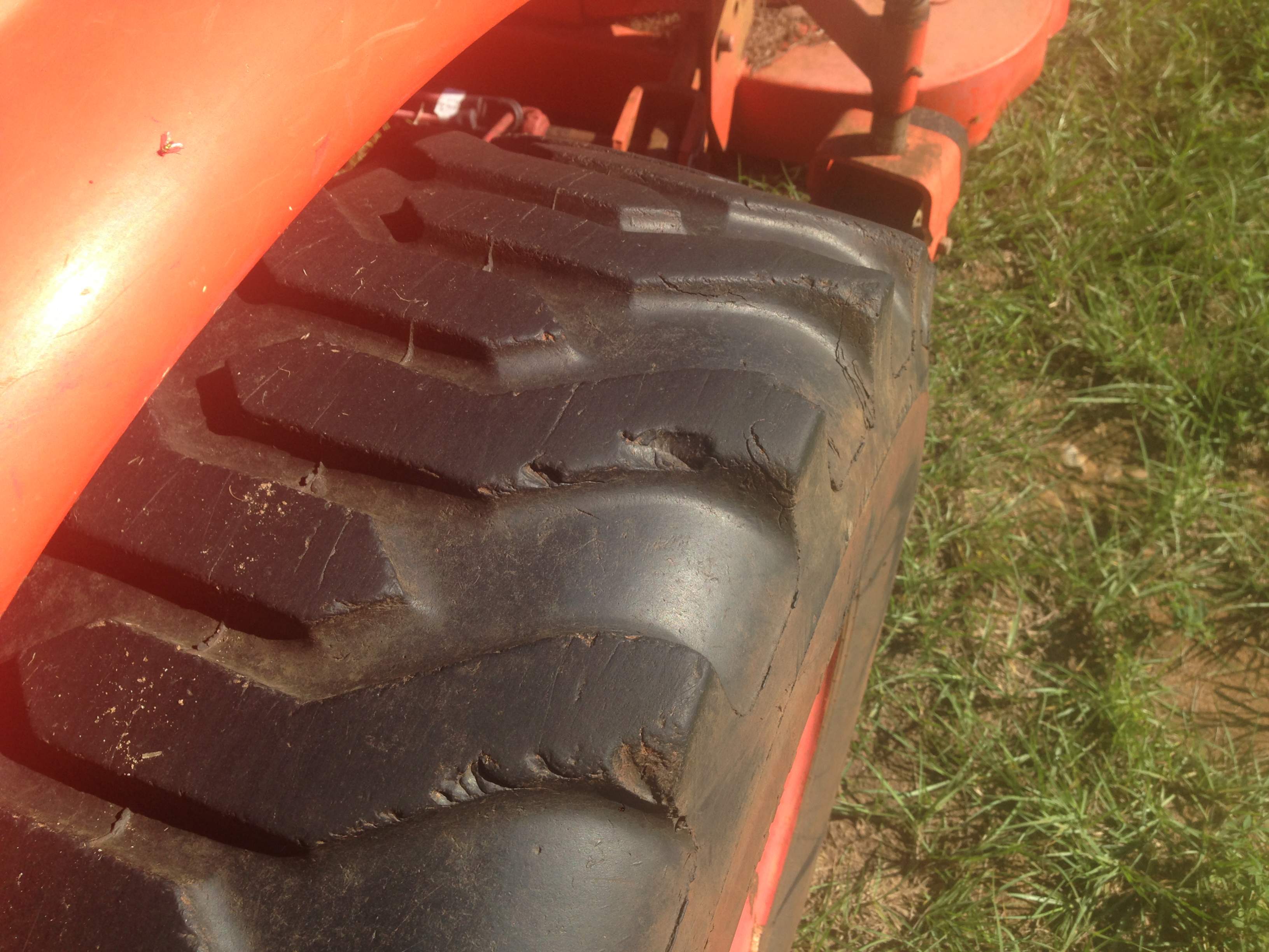

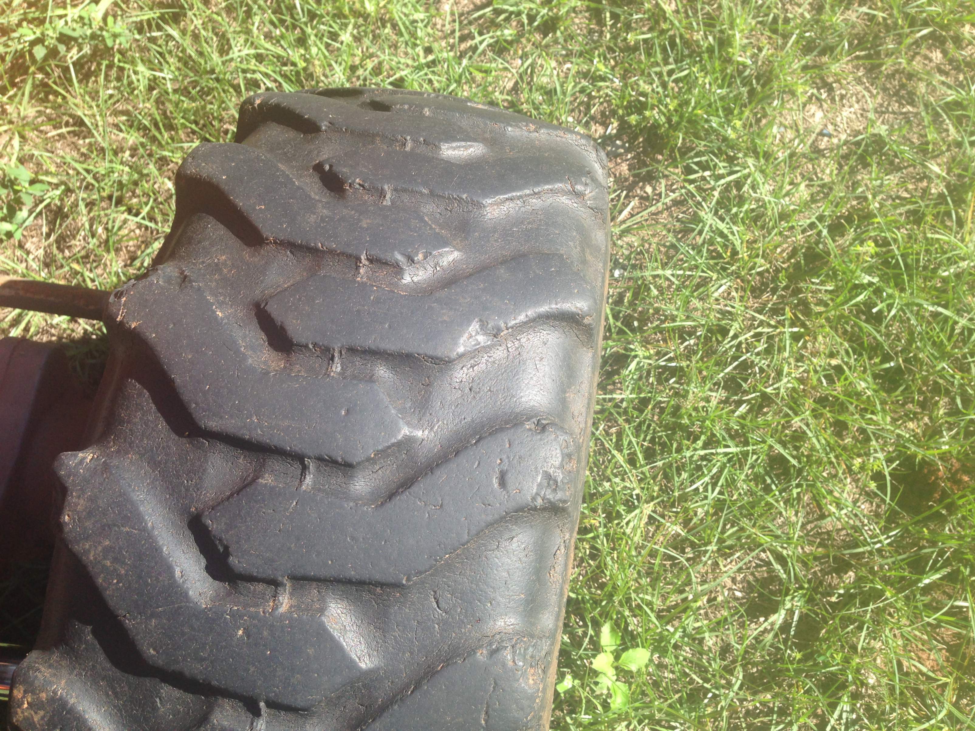

So the thread about loading the tires has peaked my interest, but before I consider that I think I need new tires. The fronts are definitely worn out and I think the rears are too...
So anybody got a good place to buy the R-4 tires (I am guessing based on what I have seen that these are R-4 tires).
Thanks
Rancho

Gee, your front tires look better than mine!
/ Time to replace the tires? #4
I'll we watching this thread to see what people with more experience than I have to say.
To me, unless you need traction you aren't getting and wouldn't get by loading them, those tires look fine.
/ Time to replace the tires? #5
I don't think I'd change them if they were mine.
/ Time to replace the tires? #6
I would load those rears and run them all. They are in pretty good shape. There's still lots of traction bar height (rears anyway) and no apparent checking. Although I have no experience with R4's, I'd say they'll go for a long time yet. You can remove fluid and put it in other tires later if you want to.
Pictures can be deceiving though..
/ Time to replace the tires? #8
They don't look dry rotted. No splits or peeling away from the cords. You still have tread. They're good for another few years unless you're plowing on ice, in which case you just throw a set of chains on them.

LOL.. thanks for the reply, but if I ever have to try and plow on ice I am too FAR NORTH..<G>

Thanks for all the replies, I do have an issue occasionally with traction when mowing and have to lift the mower to get traction back, so guess I will try to fill for now and see how it goes. Since I am below the freeze line (ground here never freezes) I am thinking a 10 to 1 solution of water and RV antifreeze should do the trick.

Is your mower bottoming out and taking weight off your tires? Maybe at a crown in the lawn or in a dip.
/ Time to replace the tires? #13
I had the problem Amvcane is talking about. I just put a stop bolt on the lift lever and that keeps the mower higher so it rides over any high spots.

Rancho,
If it were ME :2cents: I would not change the tires YET. ( It IS your money) if traction IS a problem, I would load the tires. I don't do it myself, but I have t GREAT tire guy close by. He used a 60/40 mix of ethanol and water. This keeps it from being flammable, will not degrade the tire and also will NOT rust the rim. If you decide to replace the tires, check out OTR Tires. I had a problem with a LARGE puncture on one of my rear tires, and they were the ONLY place that was willing to ship me a tire with no shipping charges. Try e-mailing my contact there angela.daniels@ortwheel.com and see what she can do for you. I know that when it comes time to replace the other tires I'll be going through her. :2cents: :thumbsup:
Most of my mowing is done with a finish mower so there is really no weight on the rear tires cause the mower has its own casters. I have a few swale area's and small slopes that I can not go up or across at an angle as I lose traction. If I lift the mower of course there is enough weight on the rear now to move forward without an issue. So loading the tires will be the next step.

They look OK to me so I would just use them as is and not load them. The added weight could cause other issues with your lawn. Sometimes things slip a little.
