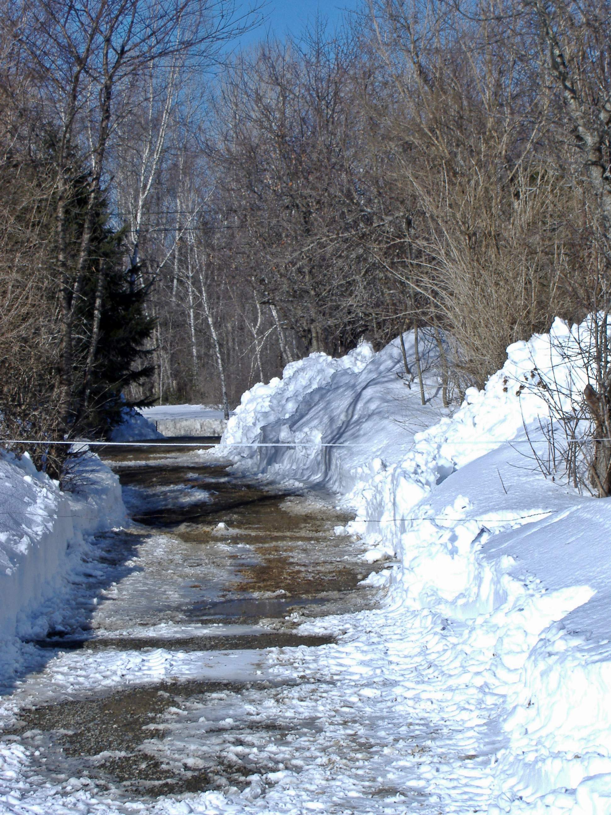

It is very helpful to have as much loader height as possible when piling snow. Here is a pic at the end of a 96" snow year. At this point, I was having trouble as to where to put it.

Working with a loader means you have to plan early and make your piles as deep as possibl and far back from your cleared surfaces. And once you get a warm up, you need to take advantage and push back wherever possible, whenever possible. It's a combination of maintaining your spaces and organizing your piles of snow.

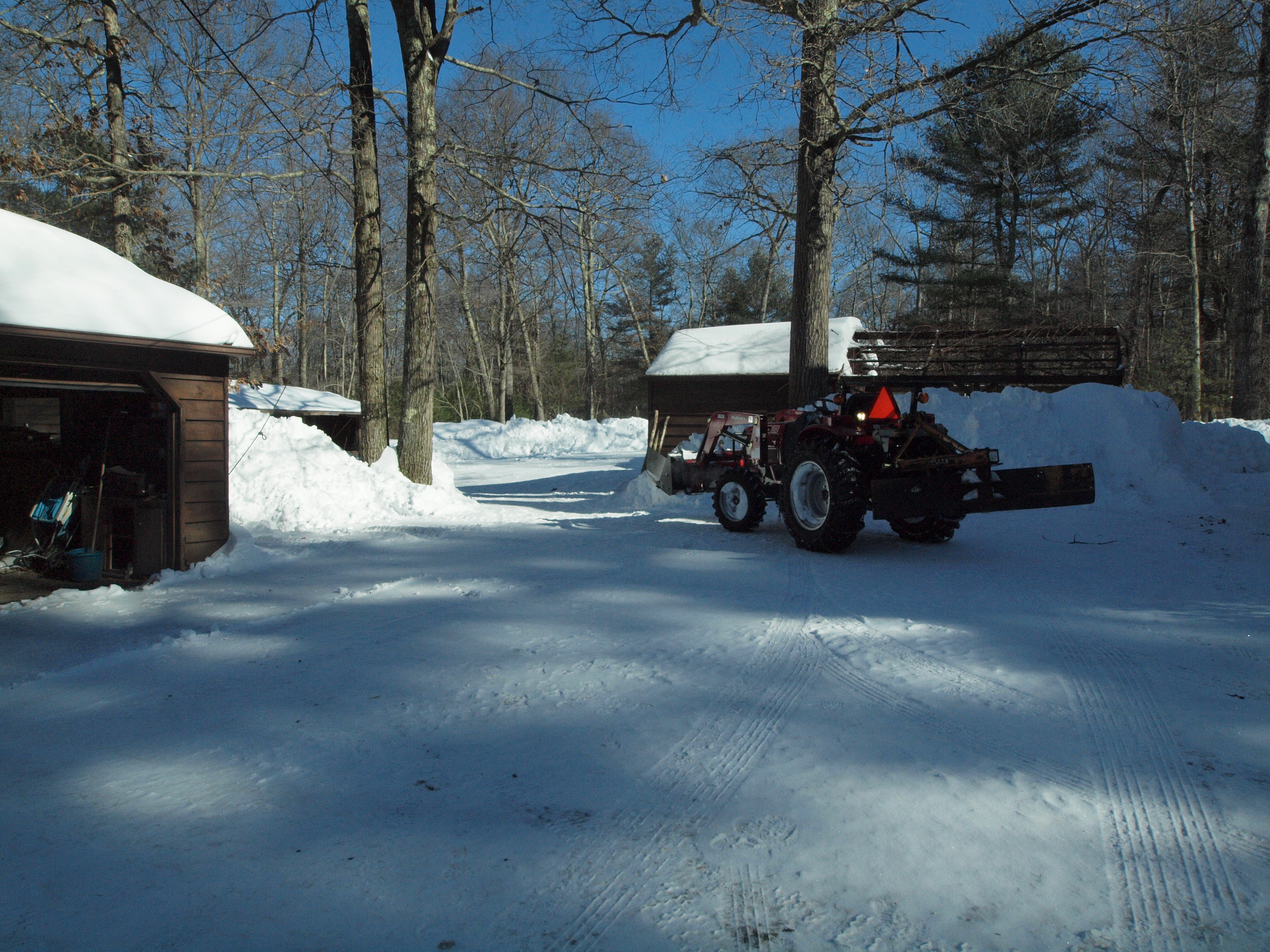

I used to have a 7' snow plow blade on my bucket but I got tired of giving the bucket up for the winter. Now I just use the 5' bucket on my 30hp TC30. It does the job. I have a gravel drive that freezes early so after 2 snowfalls, scalping is not a problem. I have filled ag tires and chains on.

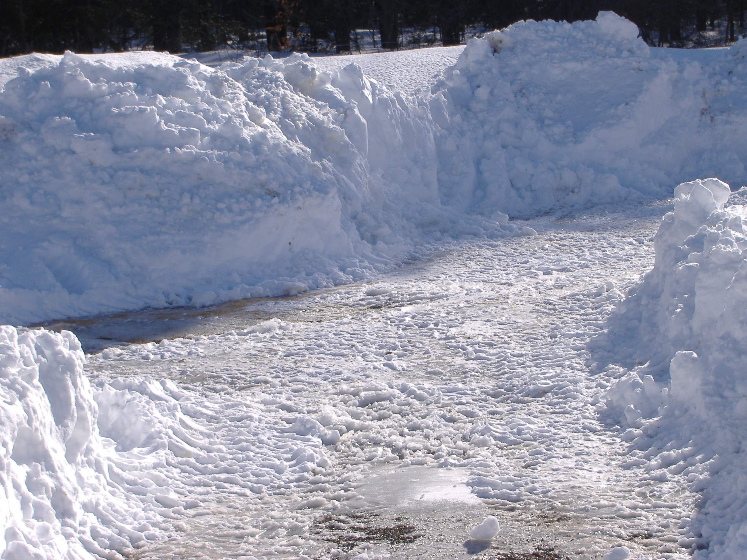

Generally I angle the bucket down and take some weight off the front tires and scrape the drive. In deep snow (last storm 14") I'll keep the bucket a few inches up for the first pass. On the second pass my rear tires are digging in and I'm down to the ground. Every pass after that I only bite off as much as won't overflow the bucket by the end of the pass. That way I never have to backtrack to clean up. Here are some pics from a couple of years ago.
