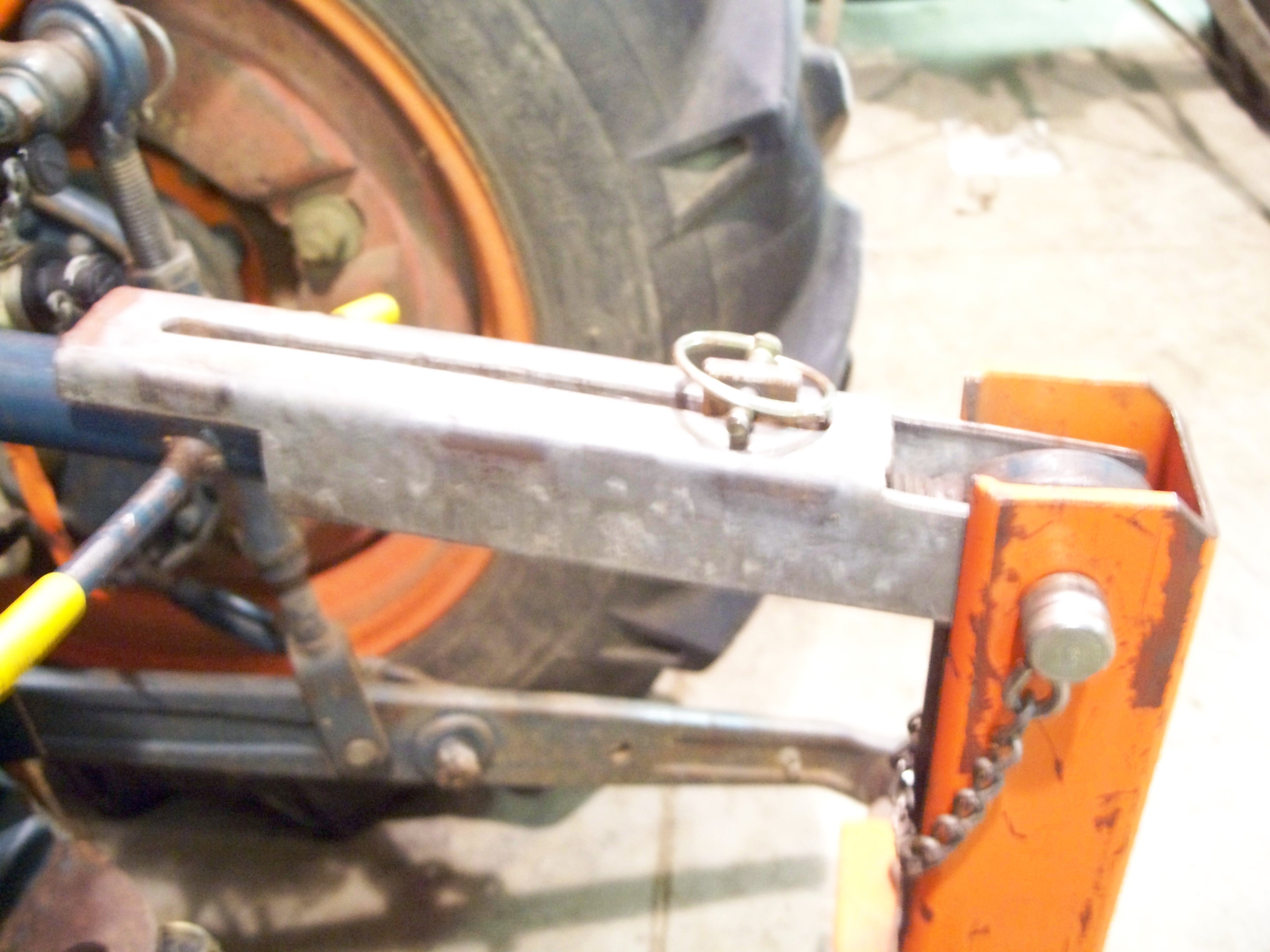

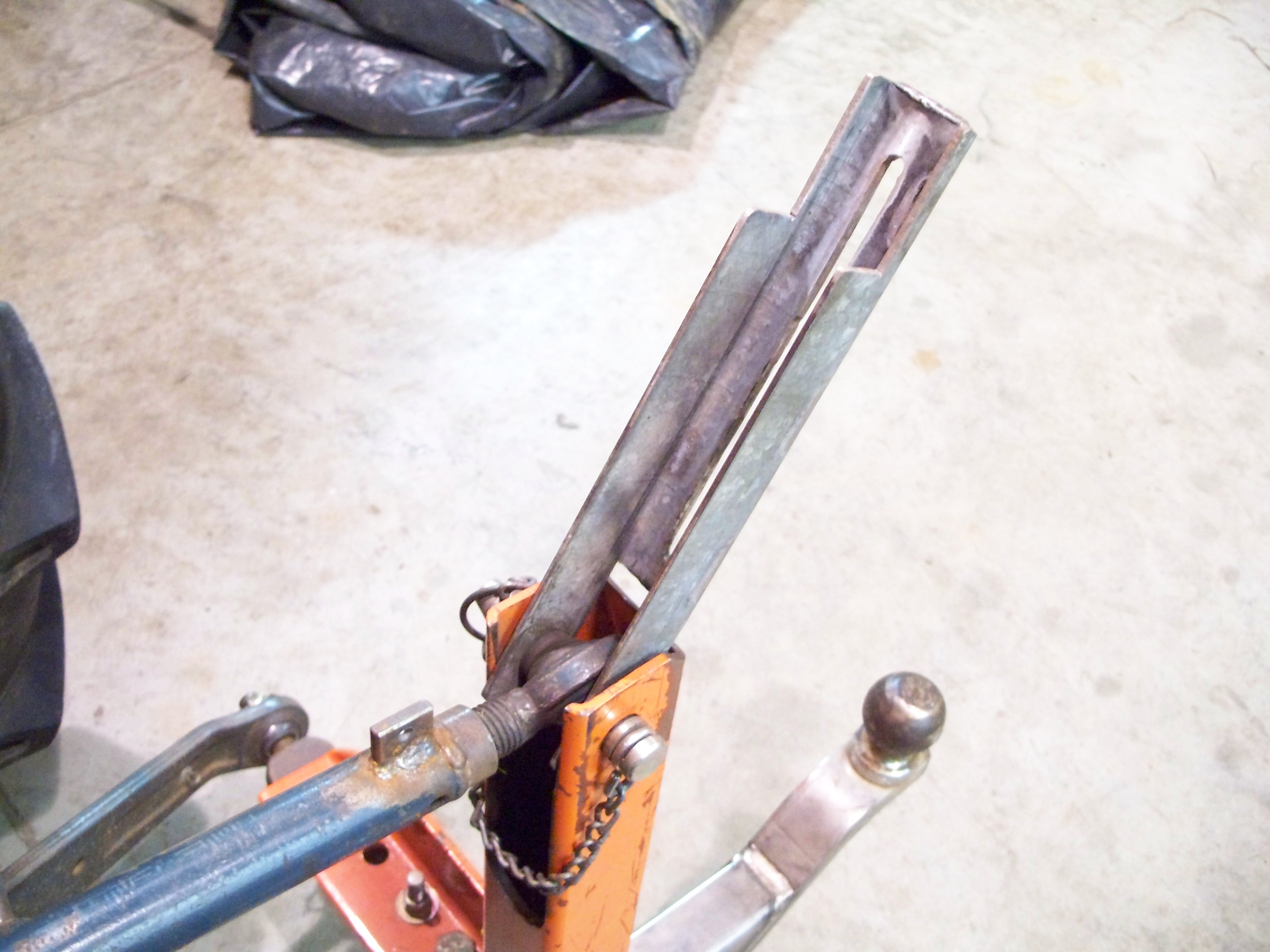

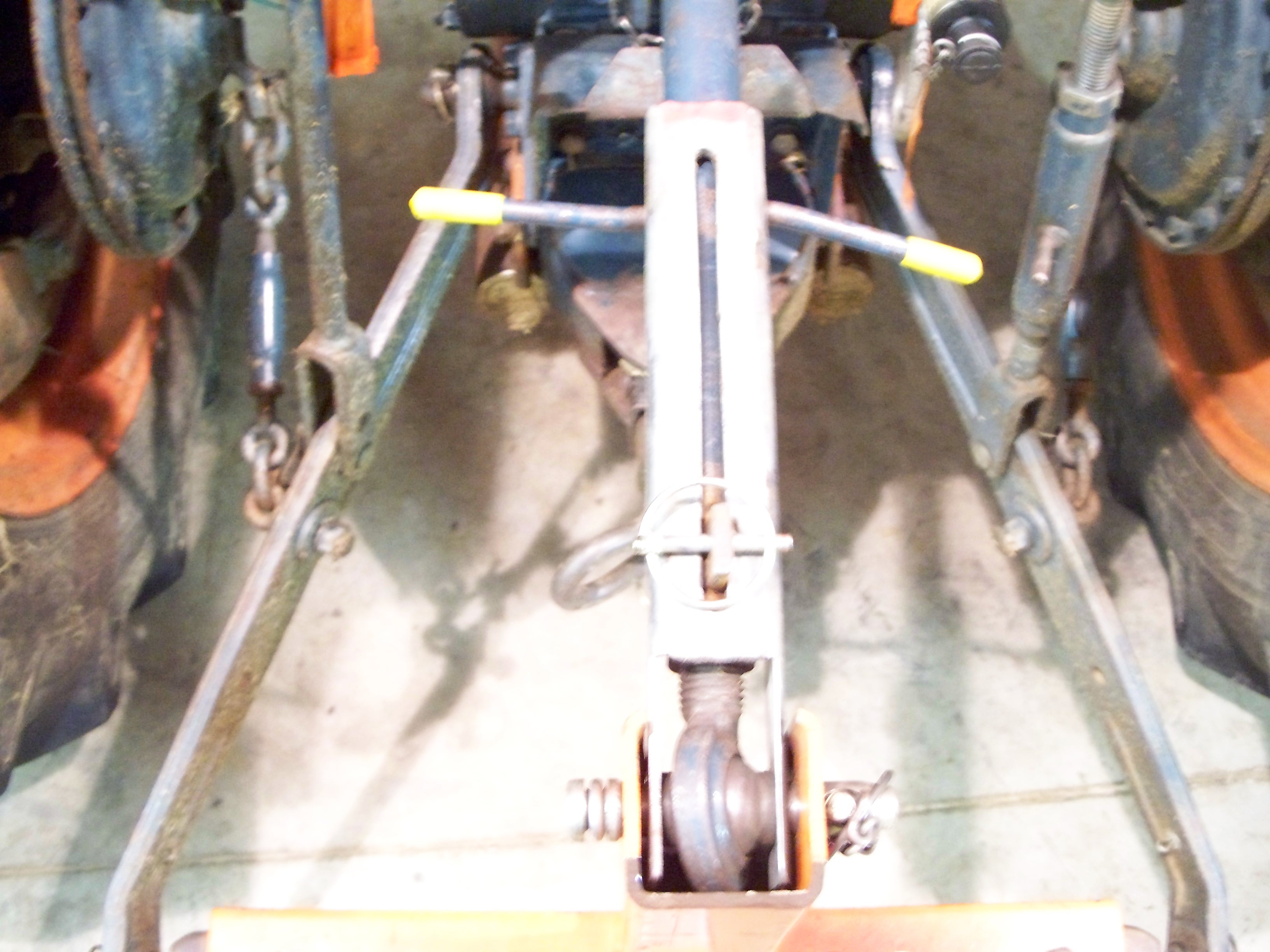

Made this latch this summer to keep my top link from backing off
