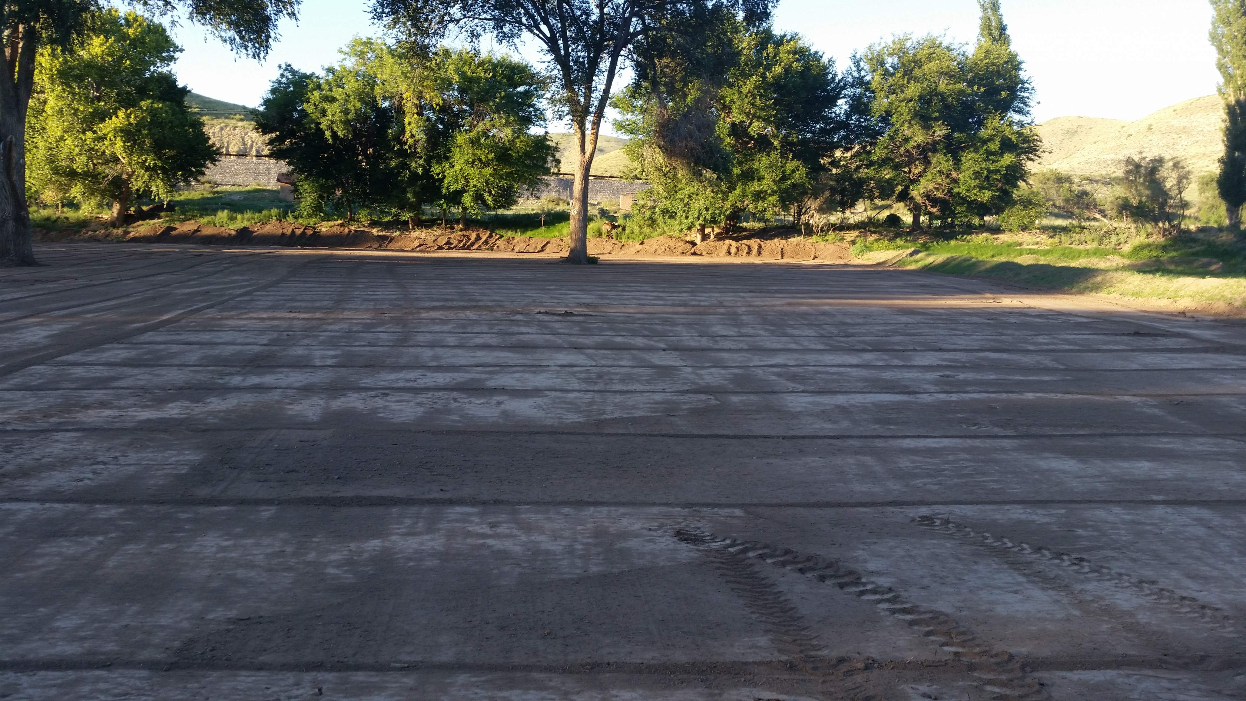

In the picture below the water flows from the background to the foreground with a .250% slope, the field is level from left to right. The grading work measured by the NRCS is within +/- .5 inch. I felt pretty good about it for the first job doing field leveling.

For accurate grading (cut and fill) you need to control the height of the box blade cutting edge on a constant basis. Simply dragging the box blade in full contact with the ground in float will not accomplish filling to the proper height.
My experience has been that there is no good way to control height because there is nothing to prevent the box from riding up except gravity. But it would then be a function of how heavy the box is, and it's entirely possible the physics of my 450# 60" box are different than someone's bigger/heavier box.
When I want to distribute material, it means lengthening the top link so that the rear cutting edges are feathered. Any material that collects in the box will be spread behind the box smoothly, raising the grade. There are angles that will empty the box, and there are angles that will maintain material height in the box (while still spreading behind -- so that means the box is scooping or collecting as much as it's spreading). Subtle changes in the top link make a world of difference.
If I want to dig, the top link is shortened so the rear cutter bites in (and the rippers in extreme cases). That means the box will fill with material and eventually start to overflow.
I guess I always come back to the reason the box blade was invented, and that was to be a device that could remove material from high spots, collect it in the box, and then redistribute/drop the material into low spots. However you can accomplish that is good, but I find having the box floating on the ground and using top link length to tune behavior gives the most consistent and repeatable results. Anytime I have attempted to operate with the box raised up, results become inconsistent and less reliable, just as the OP has described. Through trial and error, I have found that the more independent I can make box height from what the wheels are doing, the better.

I make a distinction between smoothing/averaging and leveling on grade, these are two very different things. For instance in the picture I posted earlier I leveled the field from left to right within +-.5 inches and to maintain that tolerance the field also has to be smooth. The left side of the field was cut down about 2 feet in places and the lower right side was filled about 18 inches. While that was going on I had to change the slope of the field too to prevent the water running off the field too fast. If you make mistakes it is easy to see when watering, the water doesn't lie.
I use a land plane grader scraper often to smooth out bumps and dips. Very good smoothing tool, not really a leveling tool.
