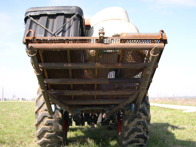

I used my 3PH hay fork, put a carryall on it, welded a gooseneck ball to the hay fork, put a grate floor on the carryall (makes it easy to chain/tie stuff down), added weights, toolbox, other heavy stuff. This rear rig goes with me everywhere except when I'm actually hauling hay on it. The carryall has pipes that slip over the tines of the hay fork and chains hold it on the fork. So, this rig is both heavy and functional. Photos below

That is great! Does that thing make coffee?!?! :D That looks like the most usefull all around 3pt implement I've ever seen. There's not a chance I could make something like that, but I love seeing it. It does give me some ideas though of some things that I might be able to pull off starting with a bale carrier like this one from TSC.

For starters it has a 2,000 lb weight limit, where as the carry all is only 1,000. It also could cary the load a little lower to the ground if I rigged up something like you have. Certainly lower than a bale on a spear. That is exactly why I was hoping for some pictures because I never would have thought about that and it's going to be more usefull than a 55 gal drum full of concrete even with pipes in it. I'm not dogging on those other ideas, I just happen to really like this one. I guess the challenge is still getting a bunch of weight on it. I bet that thing would also help out with that rear rollover issue. It wouldn't support my whole tractor at 90°, but in a partial tilt condition I can see that thing being beefy enough to help discourage a roll over. I'm going to add that to my wish list... Do you mind if I post those pics with proper credit in my "Stuff you just have to have to start farming" thread? :) That's just way cool.

Use any idea that seems to be useful to you! Post anywhere. Glad you like it.. :D yep, I couldn't leave home without it... I hang trash buckets on the frame as well..oh so handy. Also, welded chain hooks on it.. You can see them if you know where to look... also handy.
