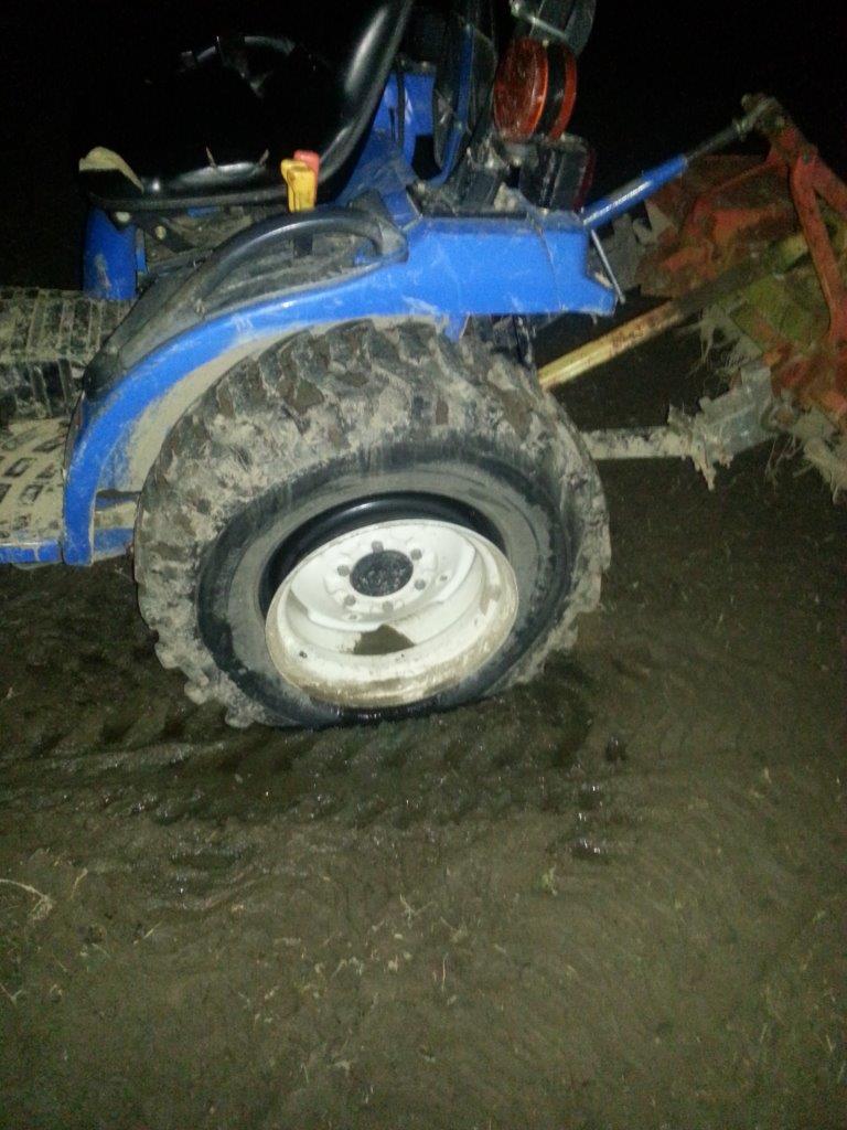

I just had a flat a week or so ago. You can see my wheels after 9 years of Windshield Washer fluid with no tubes. No signs of rust or anything.
Now as to what caused the flat, several years ago I ran a piece of barbed wire through the sidewall so I took it in to the tire shop where Dad worked. Having the windshield washer fluid in it, Dad didn't want to pump it out and have to put it back it, so he just plugged the side wall. Well it as always had a slow leak, but it gets a bit worse in the winter. I know to keep an eye on it but Monica got the tractor out to move some dirt into our new barn and this is what ensued. Dad isn't around anymore for me to have fix it again, but now that the WW is gone, I will probably pop the tire off the rim and put a patch over the plug to stop the leak. Once I know for sure then that it isn't leaking anymore I will refill with Winter Windshield Washer fluid.
   / Tire ballast and tubes #16
i'd remove the plug and go with the patch. if it won't stick.. tube it ;)
   / Tire ballast and tubes #17
I will probably remove the plug and try the patch. As soon as Dad looked at my wheels first thing he said was, you can't use a tube in those wheels. With him being in the tire business for almost 50 years, I have to believe him.
being around farm and heavy equipment and large trailers for decades.....i've never seen a rim you couldn't tube. even split rims. just requires a boot.
   / Tire ballast and tubes #19
Try a hot patch if you can find a place that still knows how to do them.
   / Tire ballast and tubes #20
good luck on that...
I haven't seen a hot patch in 25ys in my neck of the woods.
I do remember them doing them at the filling station in town though. never had one of those fail before the tire was ready to be scrapped.
