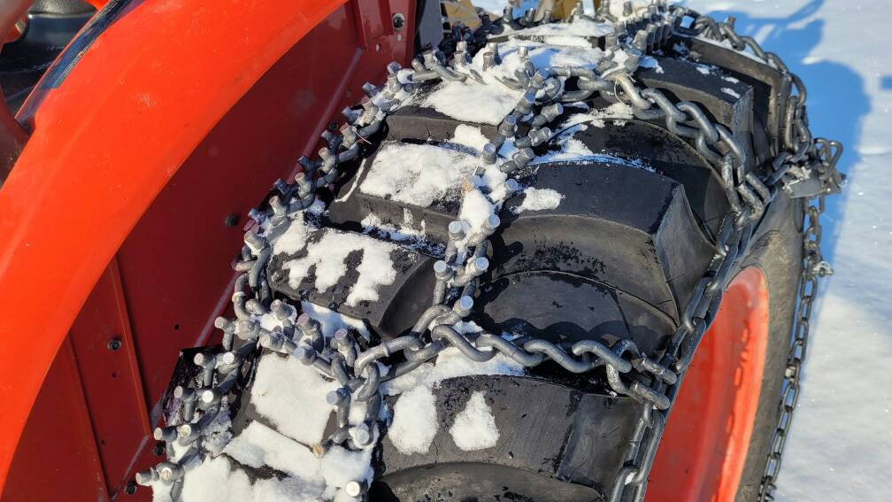

I just picked up 2 sets of OFA EKO studded chains at Austin Farm Enterprises, a small logging supplier in central NY state.
The below pics are from the shipping crates confirming each covers a range of sizes with adjustable links to fit as needed.
In my case, they had the front chains in the right size. For the rears, I was looking for chains for 17.5 x 24 tire (Kubota MX6000 with R4 tires).
They didn't have the specific size in stock, but said the 13.6 x 28 size chains would fit my tire and gave me a good price and an OK to return if they didn't fit.
They did fit very well.

They did fit very well.View attachment 732097View attachment 732098View attachment 732099
Nice chains.
