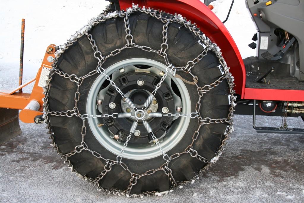

I do not have alot of experience mounting chains but I put mine on using this chain installation tool from Snow Chains Install Tool I chose a local supplier for my chain but I ordered the binder and tensioner from the tirechain.com folks. They are on tight and work very well!
That what we call a "chain jack" and they pull quite hard and get the hooks close together. But you still can't pull the slack all the way around the tire, although it would be more effective on a lighter chain then a 1200 skidder chain. With the ropes you dont have to pull hard, it allows you to roll the tire around and gather up the slack when it becomes available.
Did the criss cross spring assembly come with the chains?
Ken

Ken,
That chain tensioner comes from tirechains.com, and it makes a huge amount of tension compared to bungees. I use a nylon strap stirrup to step into to expand the springs to set them. They are tight.
