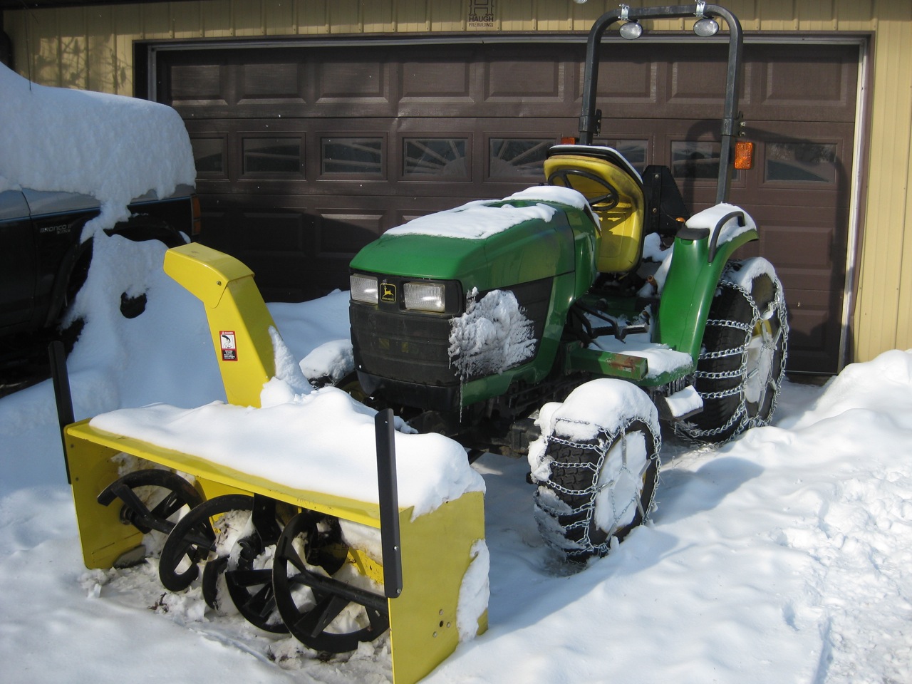

One of our members, Arrabil, uses 2 link ladders on front and rear of his Deere 4200. His drive is steep (I can surely attest to that!) and paved.
He's never slipped or slid when doing his drive since adding chains.
The pic is of his rig...and all thanks goes to Arrabil!
Ladders work good on Turfs, but if you had AG tires they are not as good because they get stuck down between the treads.
   / Tire Chains - best style #25
Yep, and the OP has turfs...not R-1's.
   / Tire Chains - best style #26
That's why I recommended 'ladders' on 2 link spacing.
I used ladders with 4 link spacing on my old Cub, they worked ok, but a lot of spinning.
And that was with a front mount blower, on a paved driveway, on a hill, with loaded rear tires.
I went with the 4 link due to cost, weight and the fact that my drive is level. Also, 4 links were what Arrabil recommended for my use.
I know they won't be as smooth to operate as the 2 link chains, but there'll be very limited use on pavement (my drive is hard packed gravel...my neighbor's is asphalt (but I only do his if requestd)).
