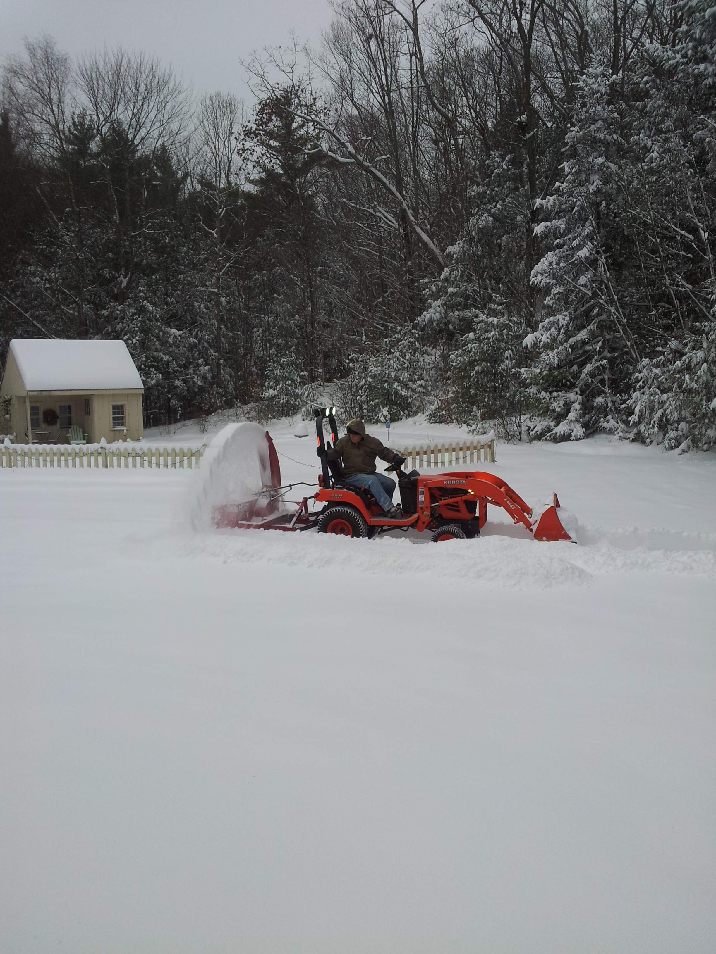

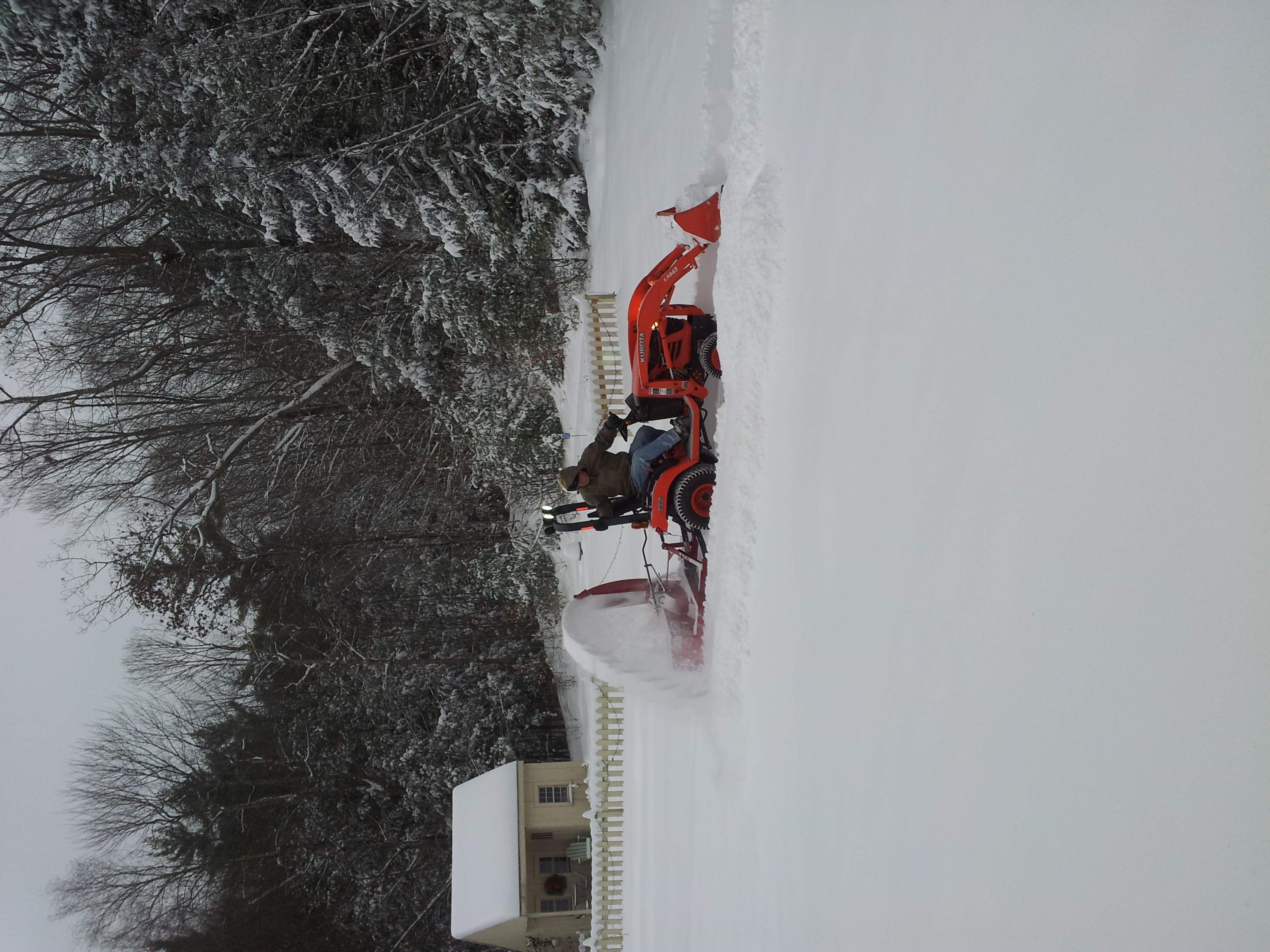

Just cleared 12"with a 60" blower. Got stuck a couple of times, so thinking of getting a set for at least the rear. Try bungee cords for tensioning. I've had luck with that before.
