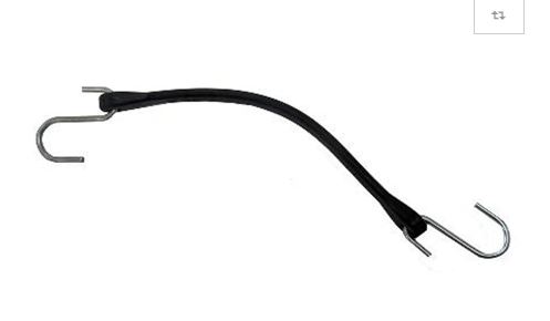

.... it's only the extra length dangling that will slap the underside of the fender if I go too fast...
I found 15" flat rubber bungies at Lowes. They work great for keeping the chains, and loose ends, tight:

I will take a picture of the box label as soon as I can-the chains I have are at least one ladder to long but I can cut it off, for now I zip tied and bungy corded it all snug.

When you put on the chains, tighten them as good as you can, then go make a lap around the yard. Stop and re-buckle them. Then repeat once more. Now they will stay put and not fly around and hit the fender.
Even then, i would add a coupe bungee cords across the diameter of the tire, to snug up any slack.
