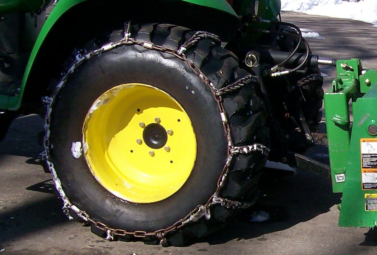

I built my own, mainly because I didn't want the side chains running down so far on the side of the tire.
I also don't like the "one size fits most tires" selection from the tire chain suppliers. They deal with the slop with chain tighteners and call it good. Doesn't work for me. :)
Was some figuring to be done, but bought the side chain, the cross links in bulk, and the connection parts. About $200 10 year ago. They work great for me.
Nice neat job you've done there - rather like the Effect I'm aiming to achieve. As Crazyal points out though, the only ones I've seen that aren't welded in some way are the simple ladder ones. Mine aren't going to be ladders, And I've got the MIG all ready to roll :)
