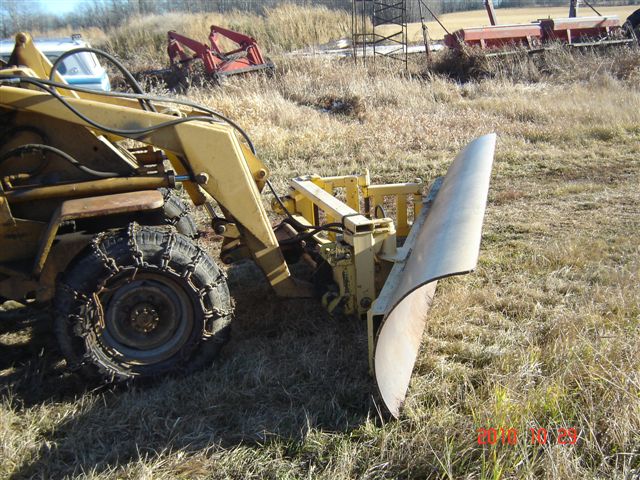

I made chains for my compact loader out of used semi chains,it don't take too long if you got a pair of chain pliers.
I added a crossbar in between every two existing bars exept by the latch(no room for one)
It got 16" ford rims and tires

Forget the chains... I love that plow mount! The angle adjustment system is exactly what I'd envisioned for a FEL arm mounted frame and plow (blade to be made from half a scrap water heater)
   / Tire Chains, Home Made Anyone done it? #15
water heater ain't strong enough,you may as well use a 1/2 a coke can
BTW,without the chains my plow is useless(spinning out);)

I think he wants to use the inner tank, not the white skin that holds the insulation on!;)

I was thinking inner tank;) 1/4" material is the minimum,and only for a quad or garden tractor.
Do it once and do it right;)
