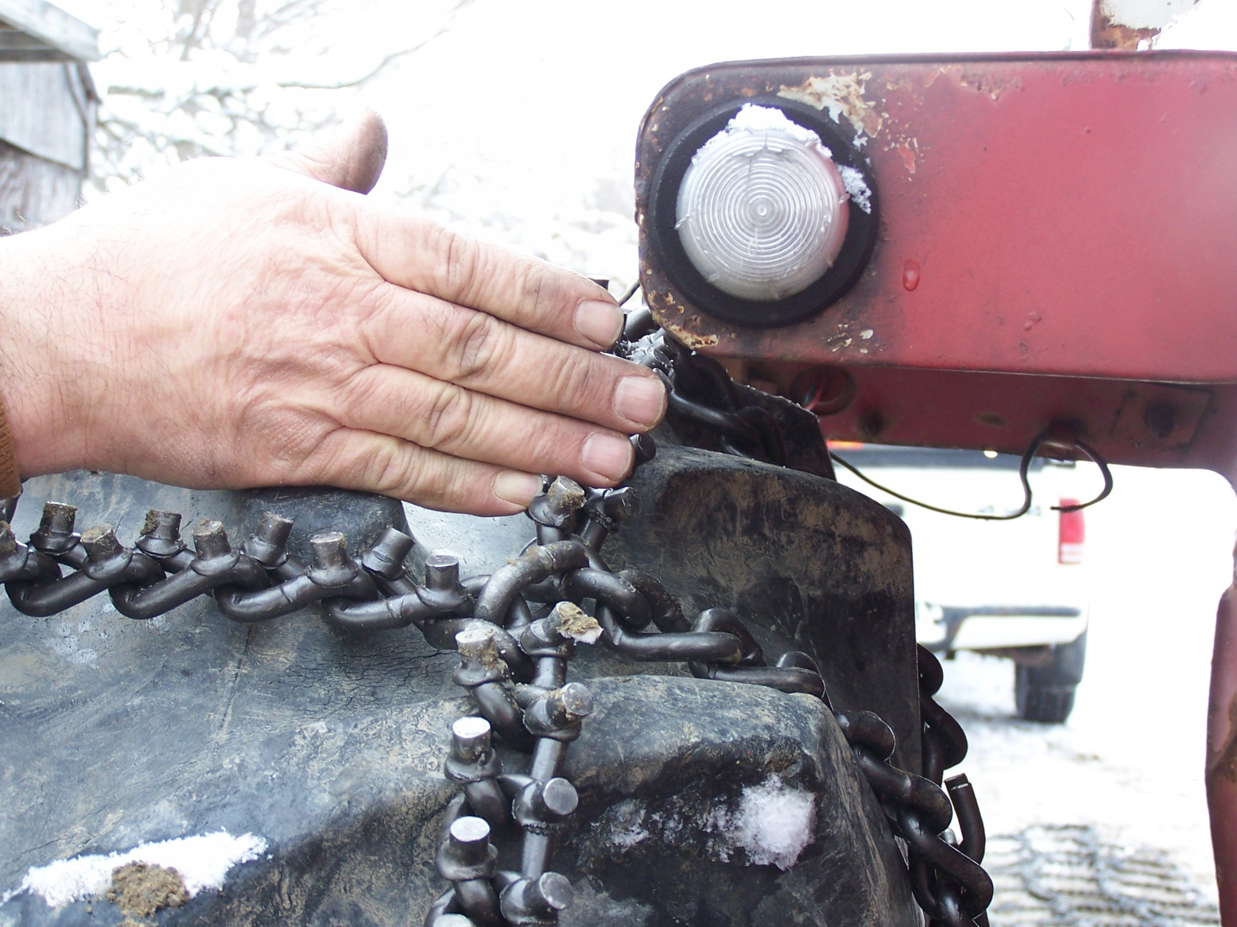

My CUT has very little clearance (cannot slip my hand between fender and tire) but I chain anyway.
I've no choice as my drive is on the hilly side.
The solution was to use binders inside and out.
OK, occasionally going downhill flat out a loose link makes contact but nothing serious.
When I hear a contact noise I simply stop and re position a binder hook since the loose cross chain is generally easy to spot.
My DIY binders are HD bungy cord loops on which I've installed a series of "S" hooks.
They've work just fine going on some 8 years or so.

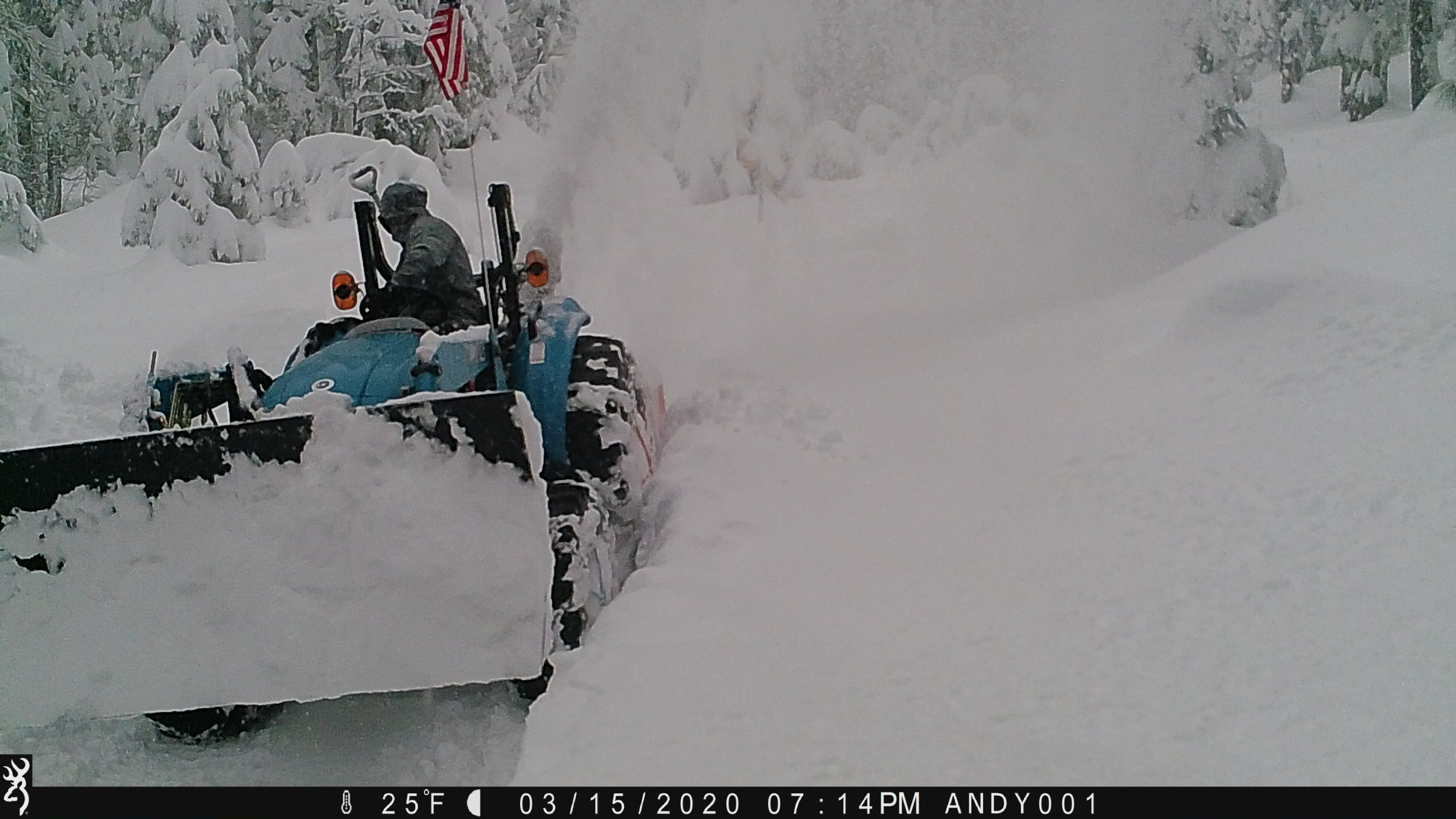

I done quite a bit of off grid plowing and snowblowing on my gravel roads some very steep . First fill your rear tires i used water and six bottle of antifreeze in each tire and yes chains are a must last make sure your in 4X4 .
