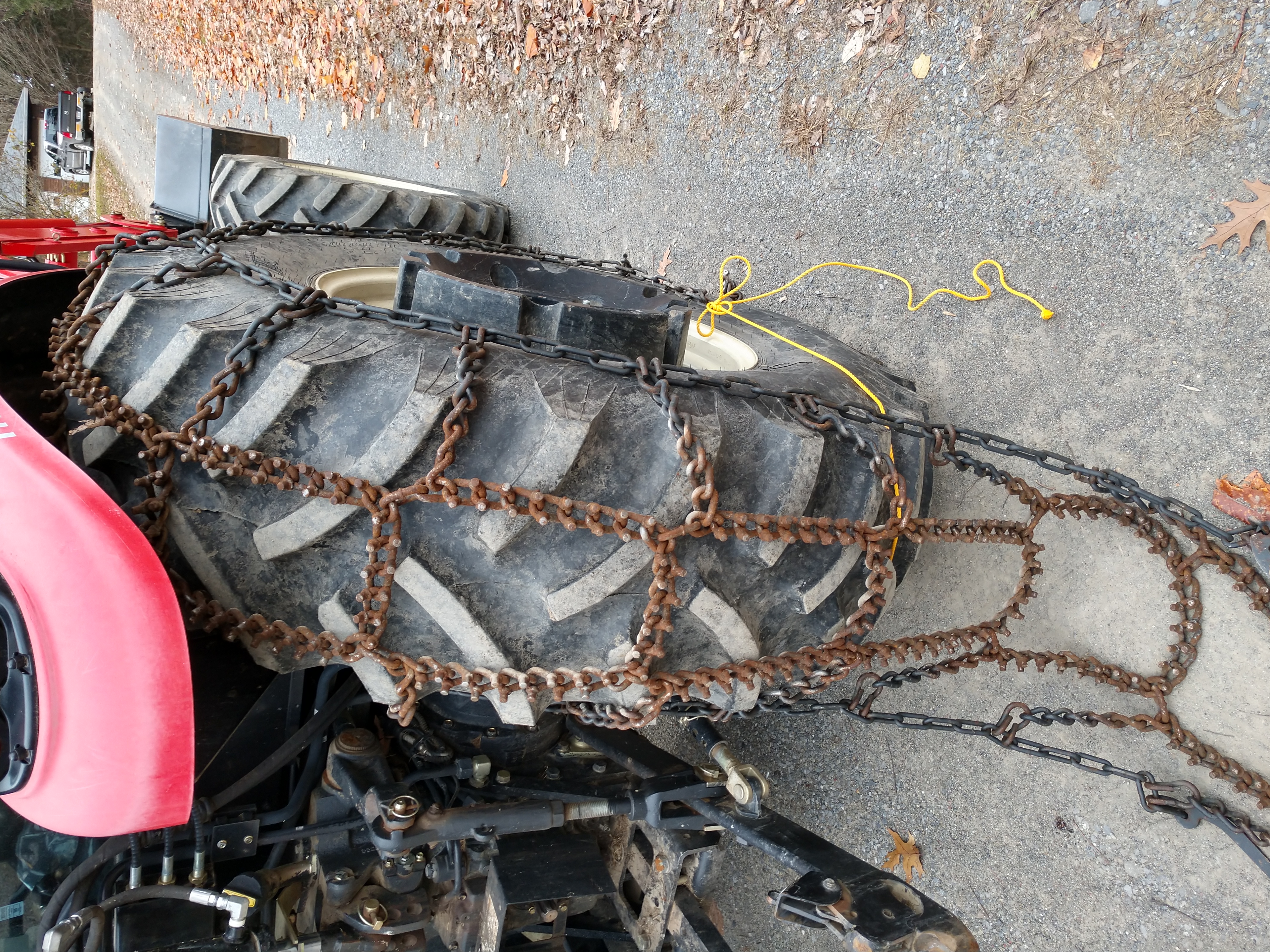

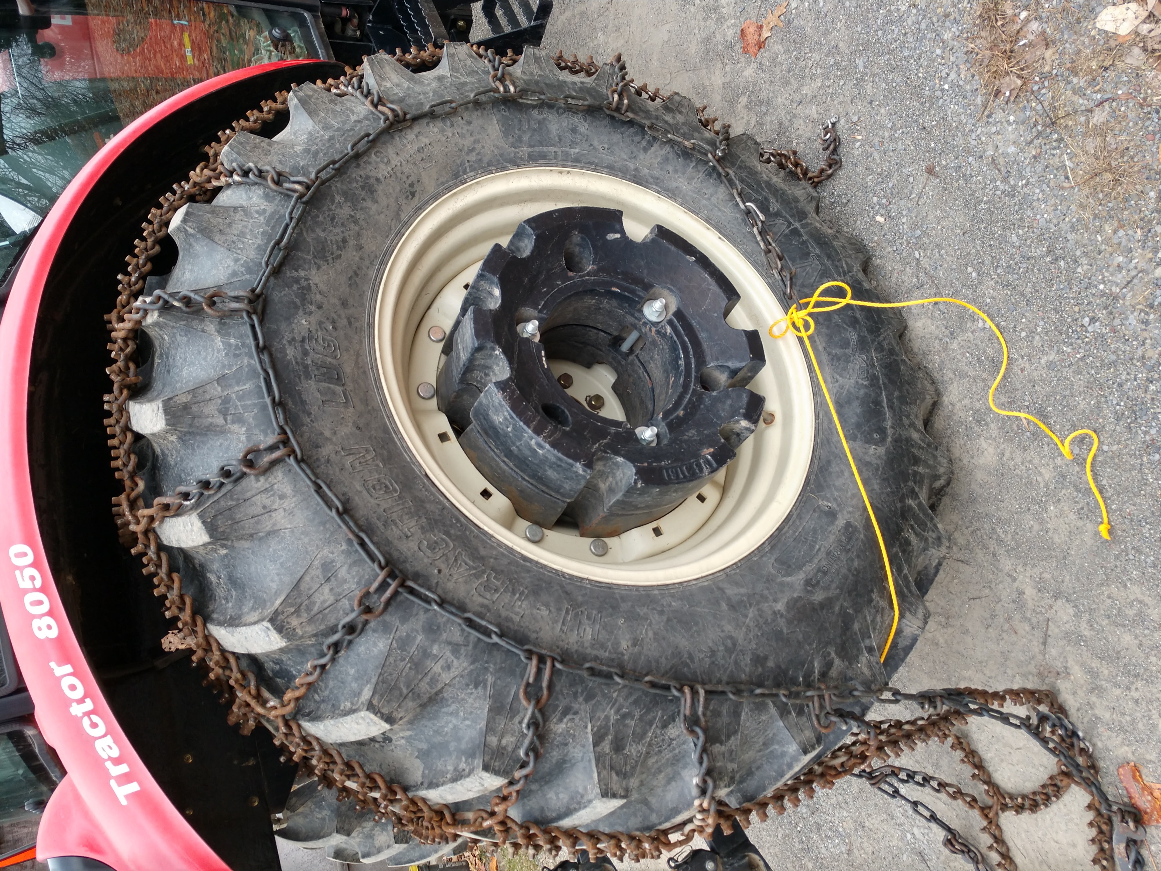

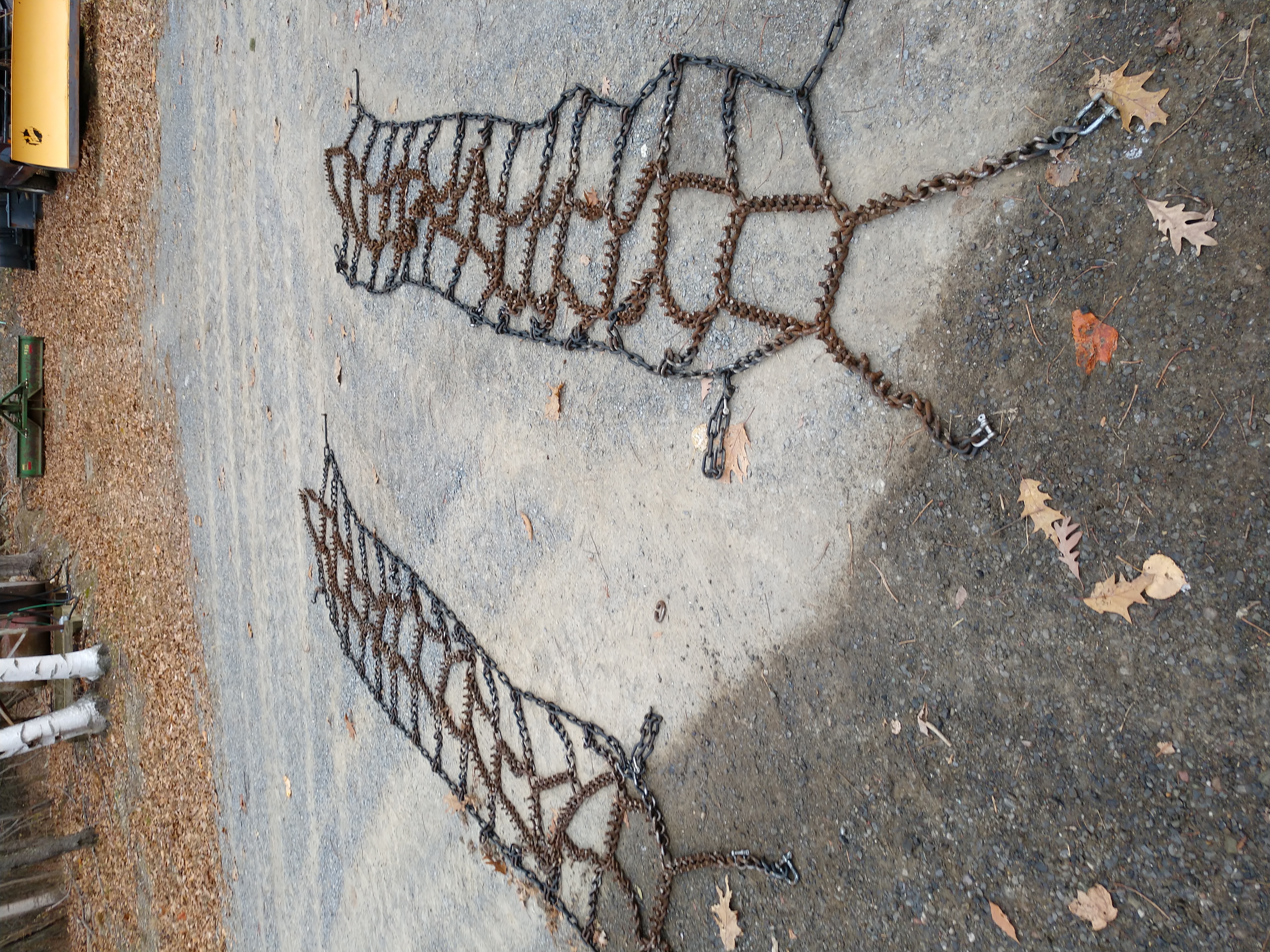

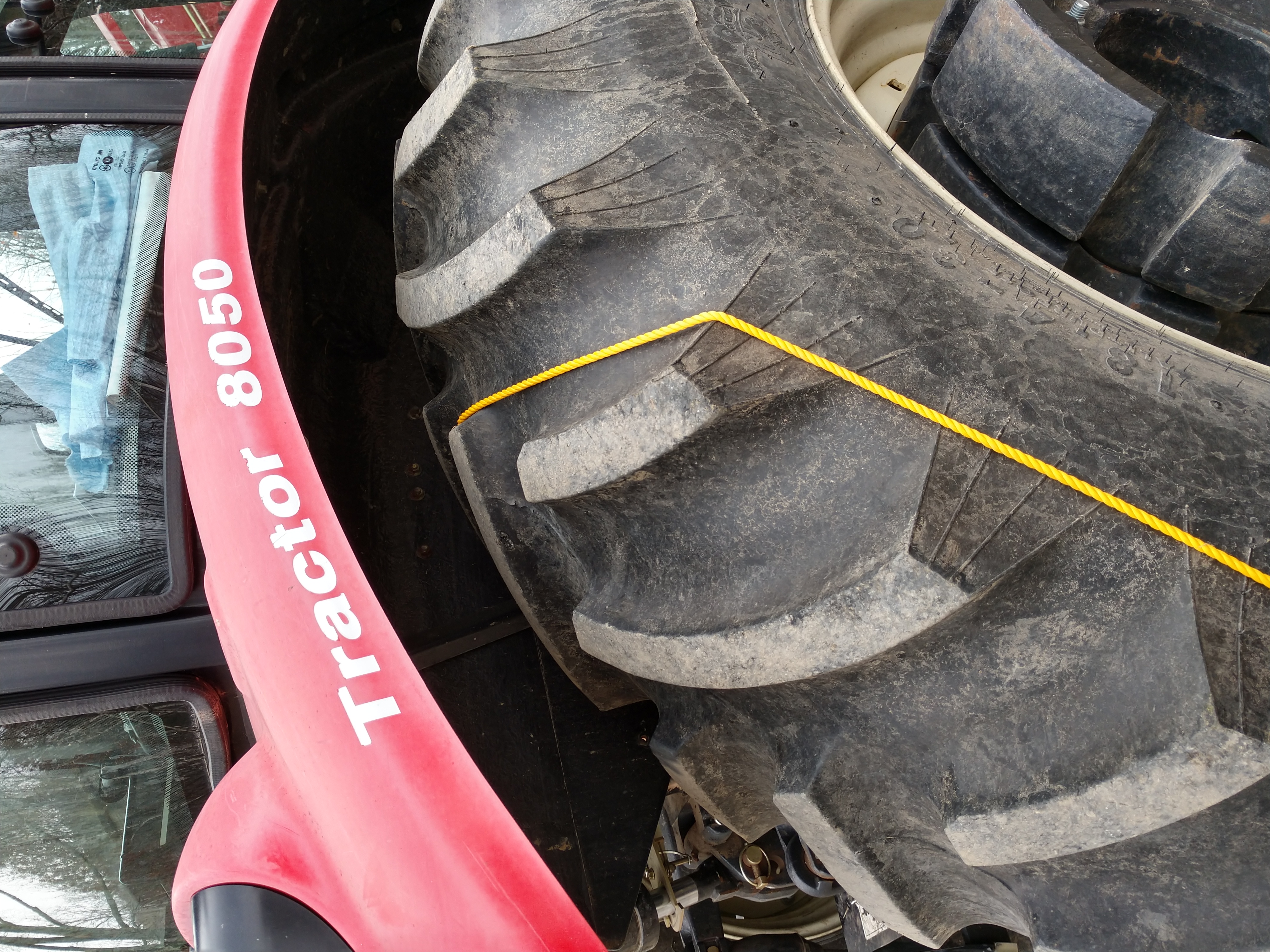

I put chains on one tractor yesterday, there are lots of ways to mount chains I thought I would share the easiest way I have found to do so.
1) lay the chains out with the outside, the ground contact side facing up
2) tie a short cord to the side chains, the length will depend on your tire size, on mine I end up with a V shape about 3 feet.

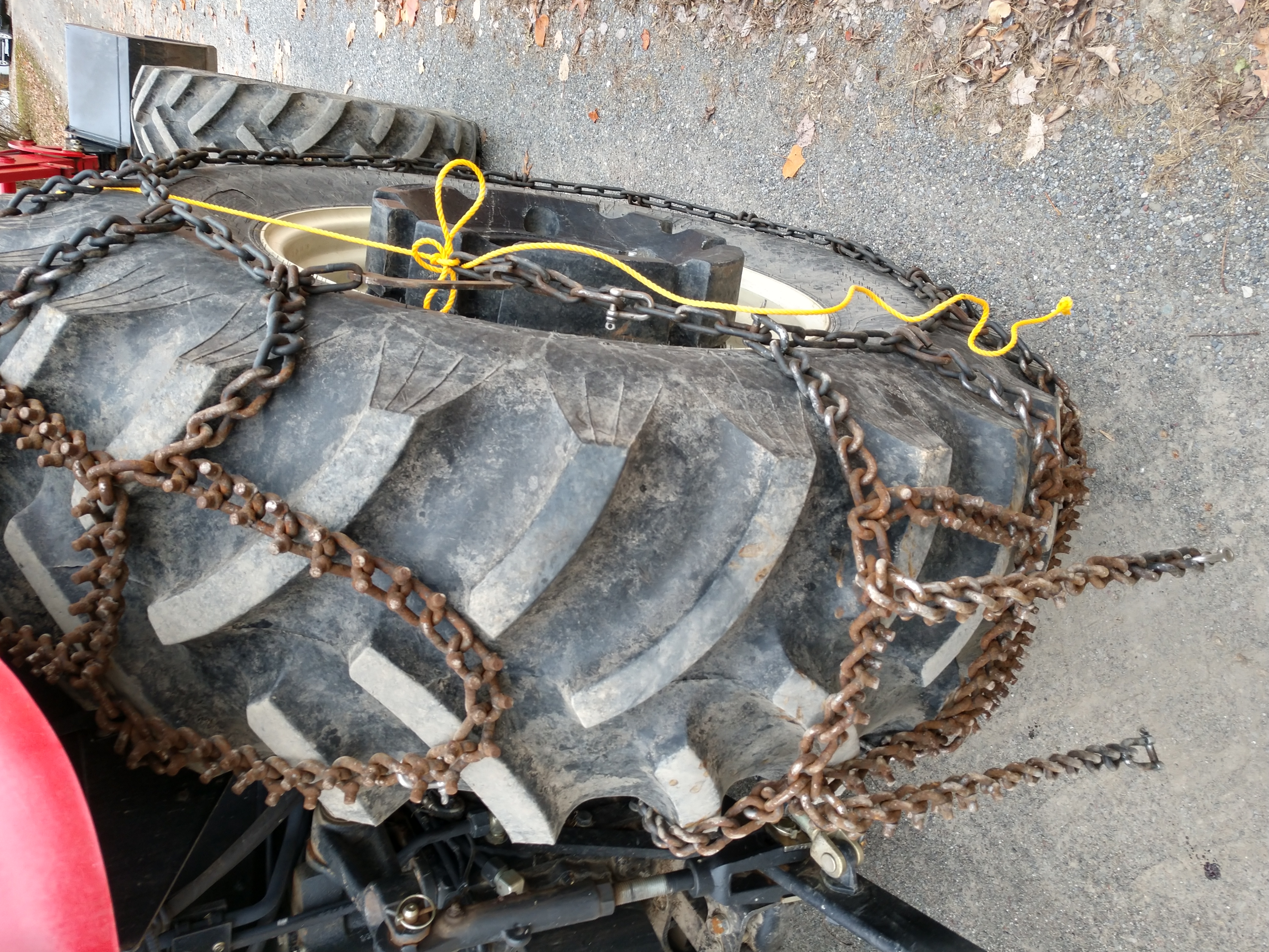

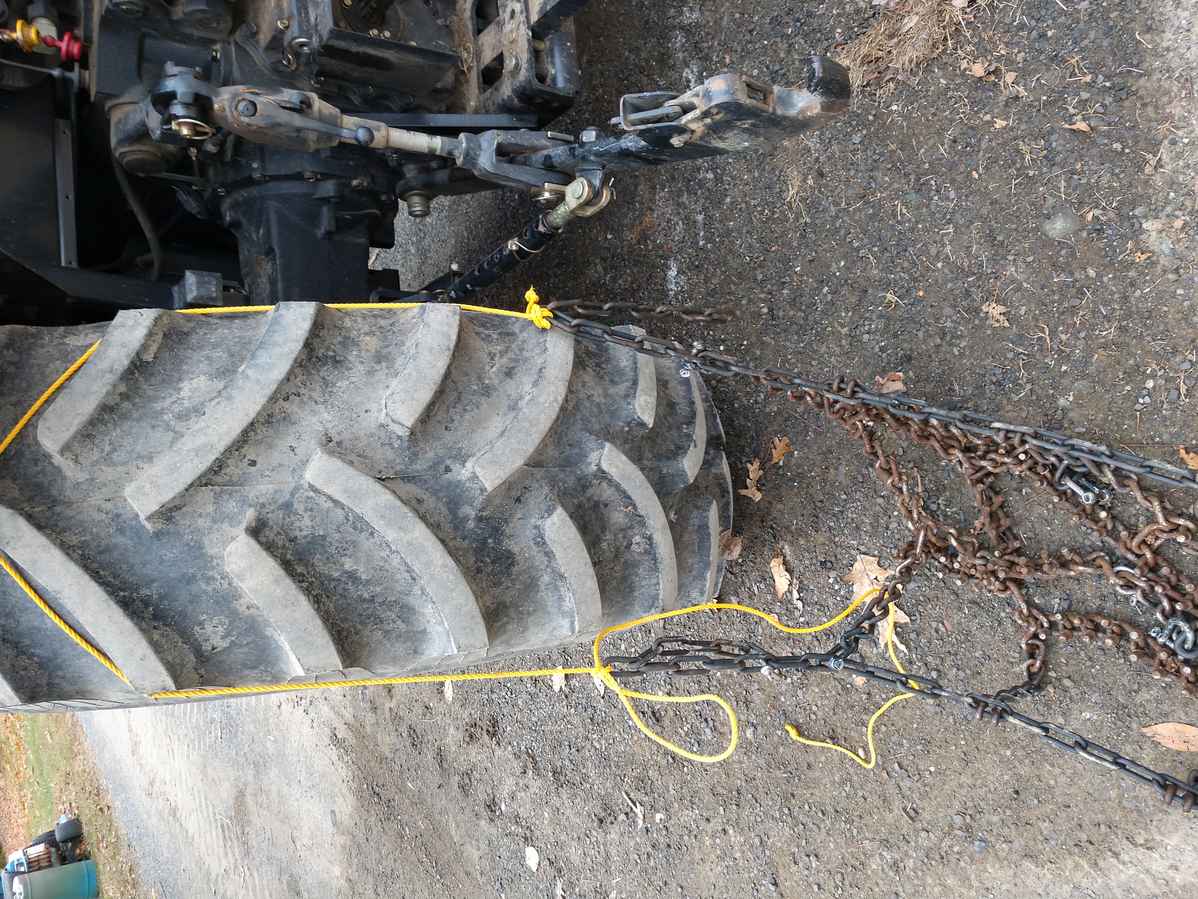

3) back up to your chain, take the cord and hang it on the tire treads.
4) drive forward slowly, stopping to spread the chain out on your tire.

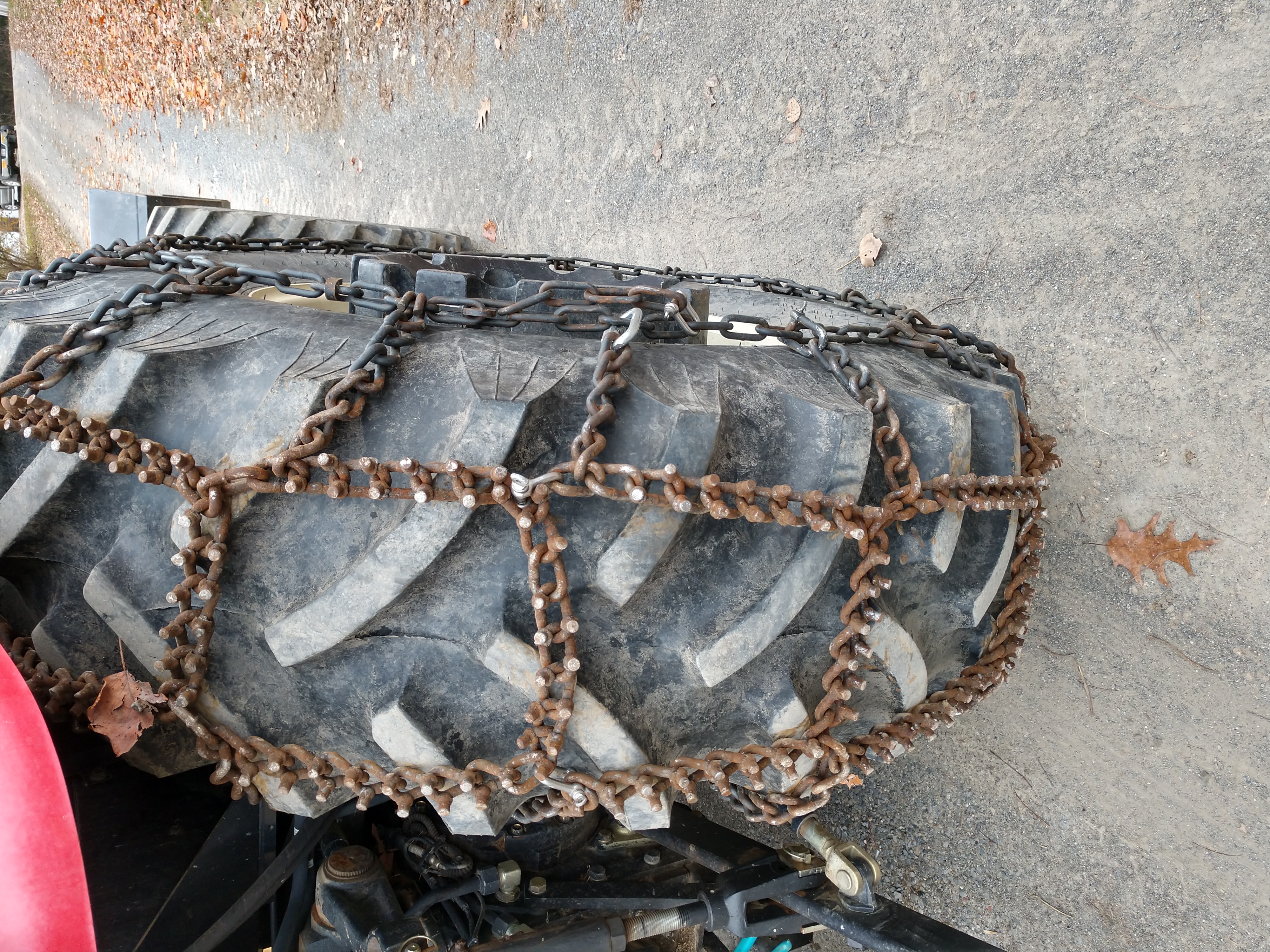

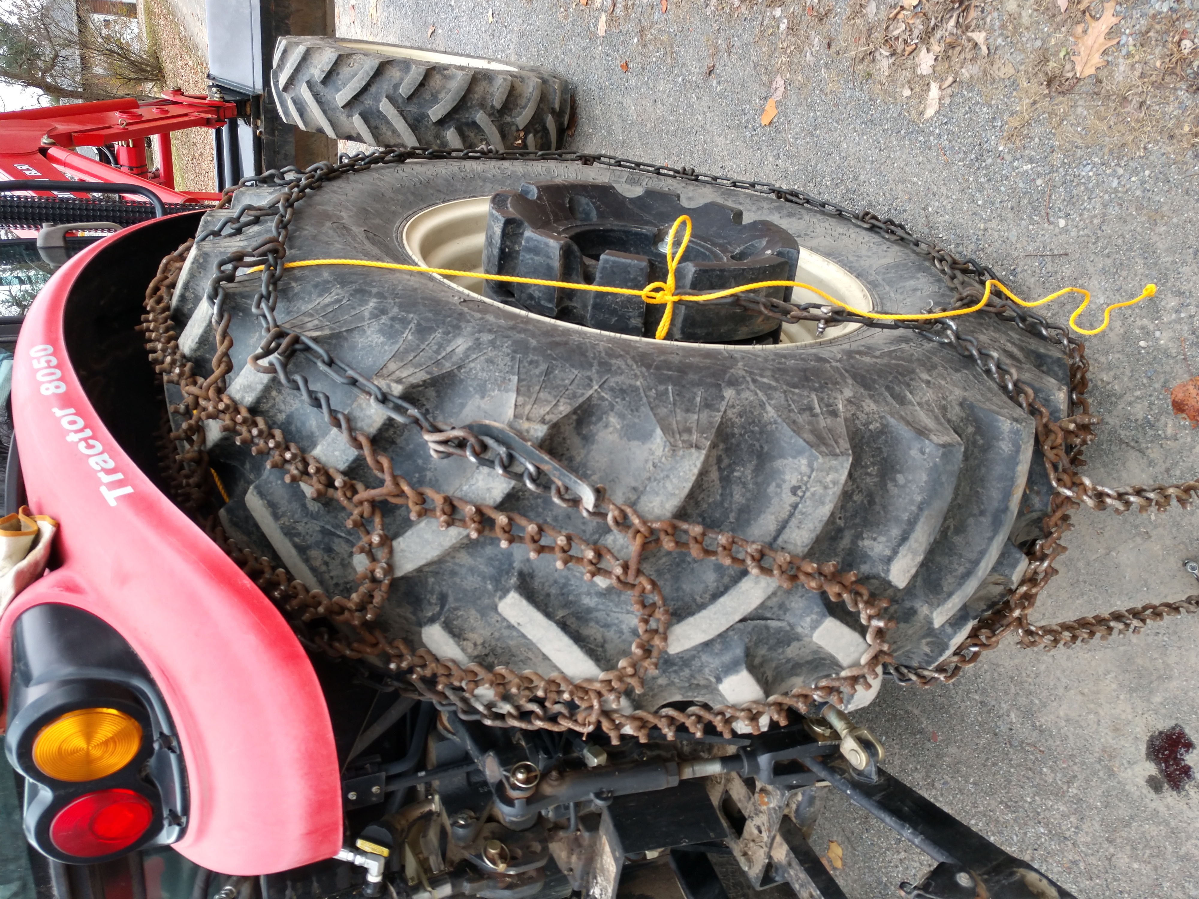

5) continue doing this till you have rolled the chain up on the tire and have working room at the rear of the tire
6) your chain should be well centered on your tire and have very little slack.

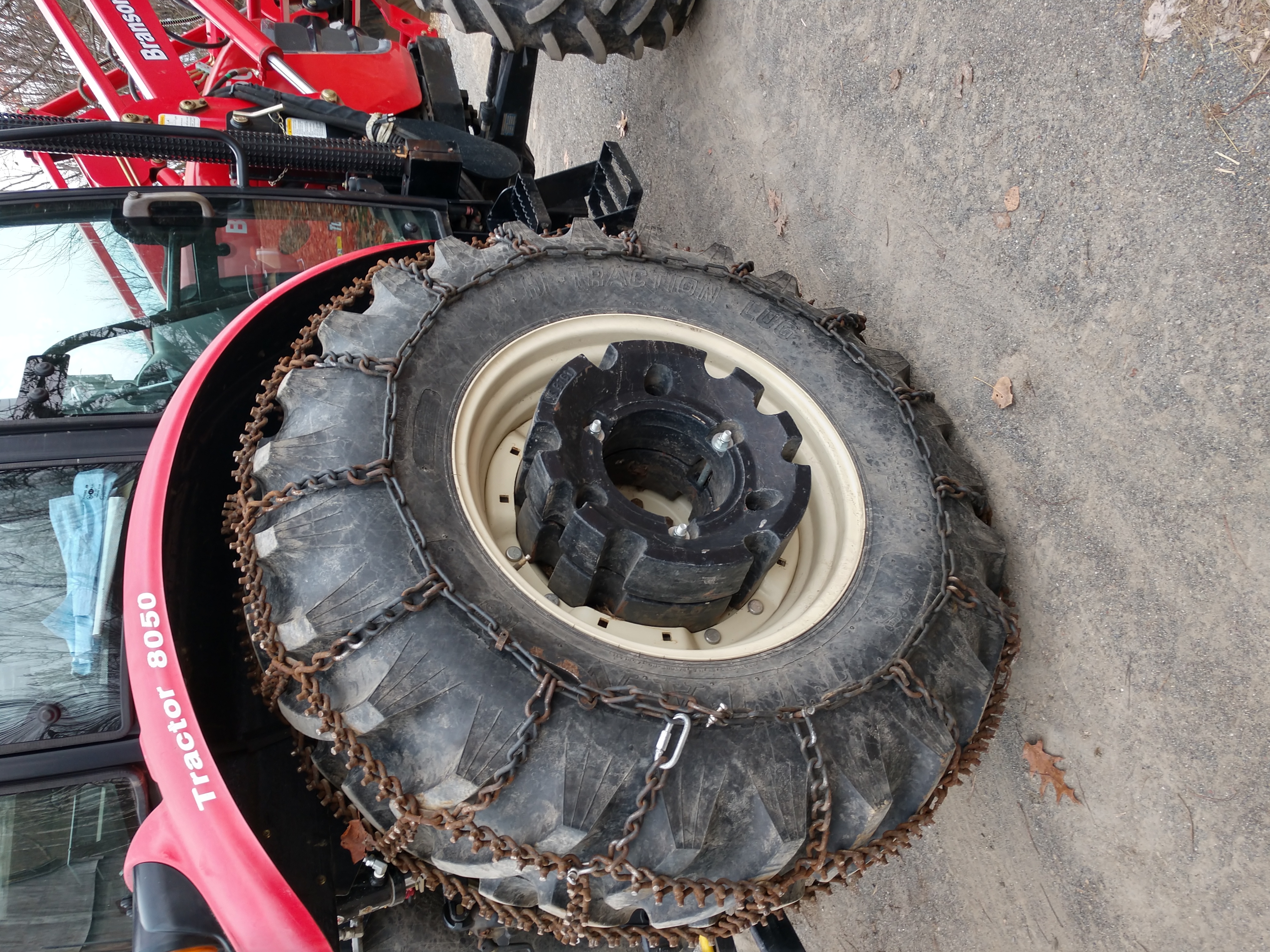

7) fasten your chains.
8) step back and check out your work

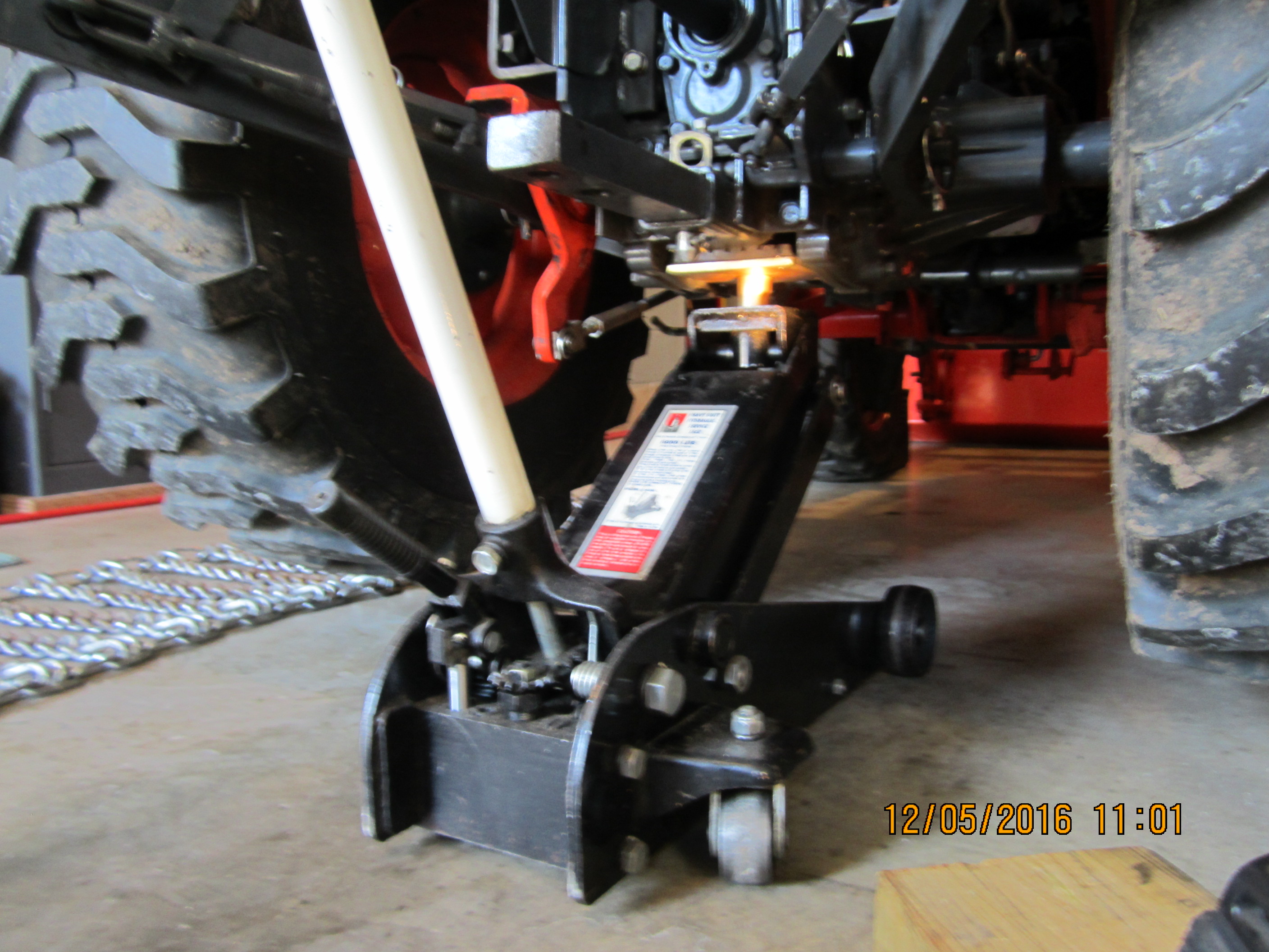

This is the easiest way I have found to do chains, if you are doing this in a shop and can jack up a wheel it works good than also.
On the smaller tires I have jacked them up and chocked the other side to do this, then simply kneel down to do the fastening.
If you find that your rope V is to long when the chain is started up simply stop and leaving your other cord on run a new V and snug it up remove the old and continue. Using this method one person can install heavy chains on large tires. Without straining and hurting themselves. If you take your time after using this method a few times you will find that after your chains are laid out and untangled you can mount them in well under a half hour each with help spreading the chains accross your tire and telling you when to stop it's even easier and you are not fighting with the weight of the chains when fastening the side links.
The shorter the V that works for you the easier to line up and fasten the side links with all the slack taken up by the chains, no fuss no muss.
This is most certainly not the only way, but it is the easiest way I have found.
Lou

I did mine today too. I use the same method. The way my chains hang it works out better for me if I tie the rope close to the center of the chains because if I tie to the side chains as shown it holds them spread wide on the side walls and I get less slack for installing the couplers required for the circumference chains on that type of chain set. Also if you have the type rims I do you can run the rope thru the opening in the rim. A little easier than hooking the tread lugs.

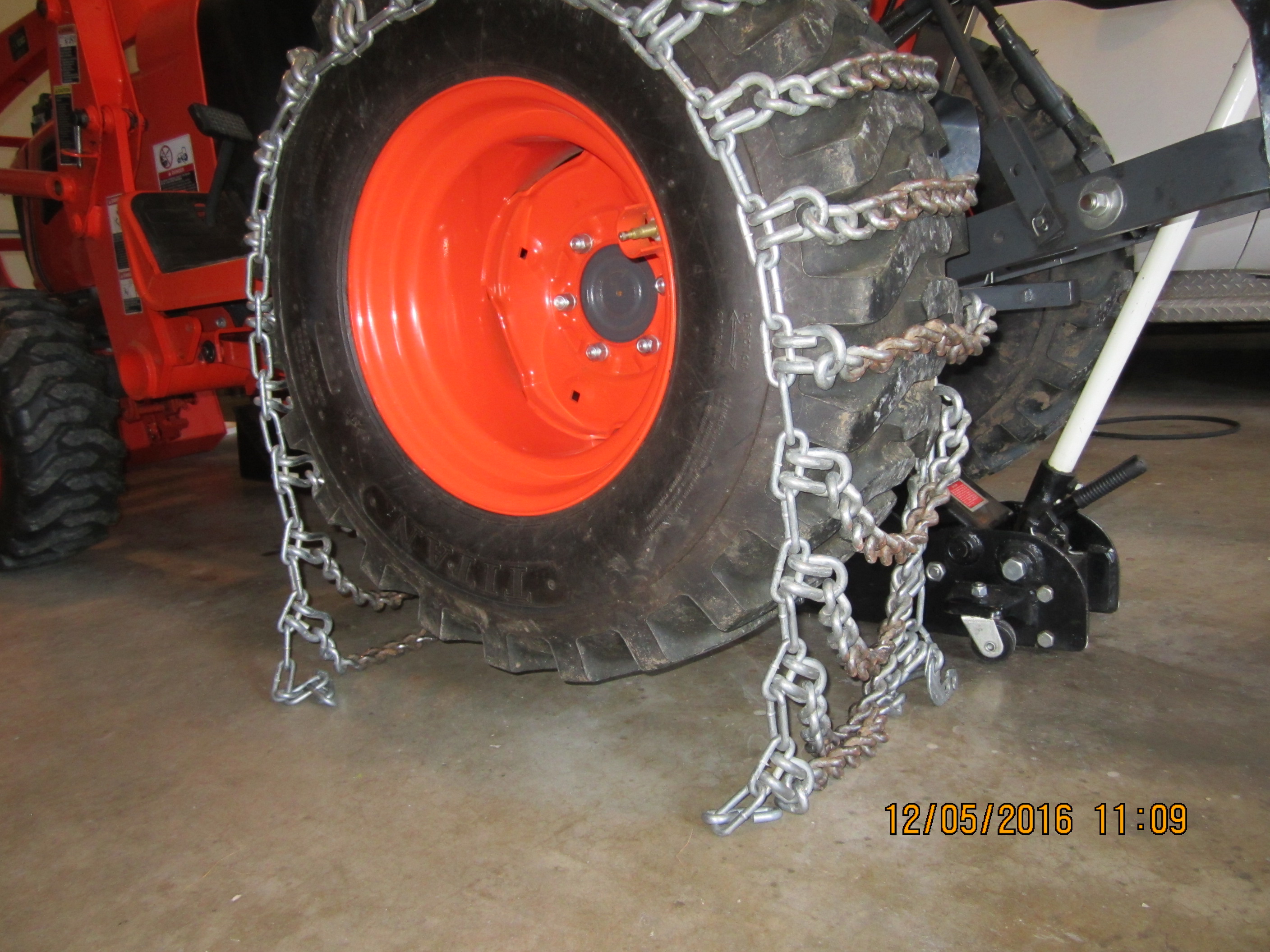

When I had a smaller tractor - some years I would mount my big, 'ol, nasty & heavy V- bar tractor chains. I always jacked up the tire and pulled, grunted and swore like a pirate getting them on - getting them straight - getting them reasonably tight.

That looks like a very good idea. I just wrestled my chains on the other day. They must weigh 80 lbs. each. I might make one small mod to your approach by attaching two small hooks to the end of the rope you make it easier to attach/detach the chain ends without having to tie/untie. Also, instead of driving I always jack up one wheel and then turn the tire by hand.

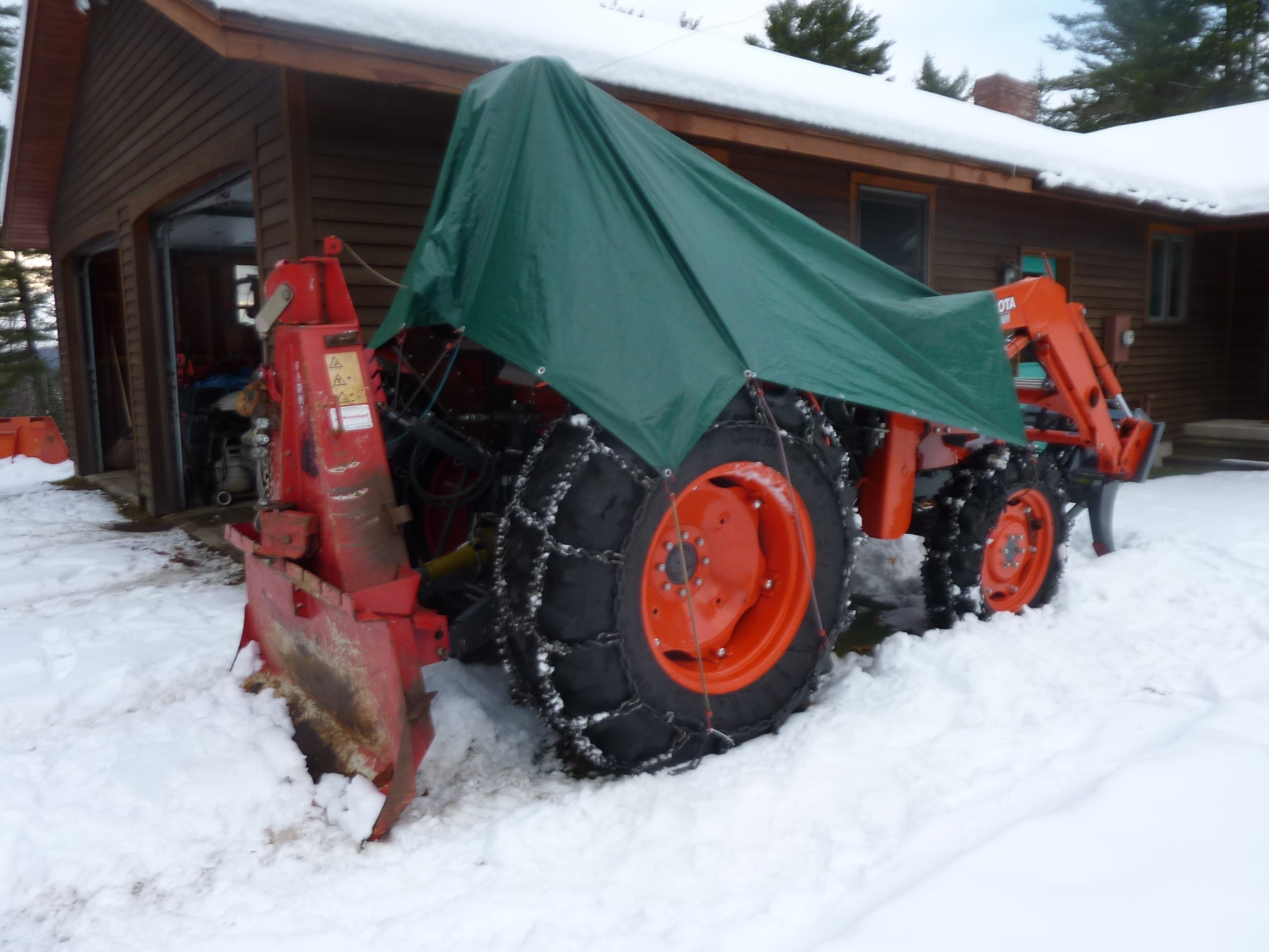

Thanks a million I was getting tired of wrestling my chains with a jack a prybar. I'm almost looking forward to next year!
The first storm left 22 inches, I had an emergency session with the winterizing the Kioti!

Nice videos, I like to pull using the outer side chains I find that more of the slack falls out of them easier that way,
I also tie to the spare link ends of the side chains a couple of links back from my fastening link.
After I fasten my center links with the latches hang free I find it easy to hook up the side chains with the hook end free.
I don't enjoy putting chains on but I can have on and latched in under 15 minutes per chain once I have them laid out,
