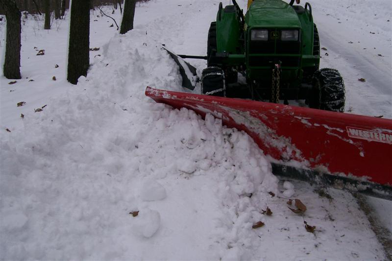

I've run chains on the rear for many years - simple single ladder chains. This is the first winter I've put them on the front and wasn't because of steering (that is what the individual wheel brakes are for, IMO). But I needed to go in the deep snow in the woods and the extra traction was great. I left just the fronts on for awhile. Then decided having a lot of traction just on the front wheels, without any help from the rears was not the best idea (although have not heard of a Deere having problems, and was told by a Deere engineer that they were designed to take the load).
Here are a couple pics of the rears and the fronts only.

Anyway, my 4150 has had chains on the front and rear for 6 years + now. I work it hard logging, loading, run chains in the summer bushhoggin' and have yet to have an issue. In my situation I have decided I would rather break something than roll the thing over on steep ground. I try not to dig with the bucket if I have front chains on unless I have a heavy implement on the rear. There are a lot of other folks around here with chains on all 4 corners.
Front chains are there to keep you out of trouble, not to dig harder.

If you'll notice - most DOT road graders and many plow trucks (both 2WD) have chains on the front wheels when the conditions are bad. Reason: they dramatically help with steering control and stopping (truck).
If you have concerns regarding clearance - look for some lighter chains that are smaller diameter. Like the ones for a small car. Or go with a cable chain.
I have found that many times while plowing and clearing snow; my front wheels are just slightly off the ground and don't do much in 4WD, anyway. But for steering control --- gotta have 'em!!! :eek: And for those times when you drop the front end off the edge of the road or just over a dip where the piles are... and you can't back up or go forward - thank God for chains!
Lot's of ice and deep, hard packed snow are normal operating conditions up here. You'd be hard pressed to find anyone without chains on all 4 wheels.
Use common sense - don't keep it in 4WD unless necessary, steer gradually and in wider arcs (no crabbing or binding). Go slower...
Using chains for 3 months in the winter (6-7 up here) shouldn't be any more of a concern to your front driveline than digging and dirt work with the loader in the warmer months.
