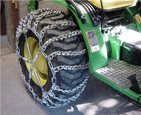

I have a JD 4115, and a set of tire chains that I am not very happy with. I bought the chains from tirechains.com because the price was good. Don't get me wrong, the quality of the chains is top notch, but the spaces between the chains is to wide. When I move snow, I have to go very slow or my teeth will shake loose from the up and down movement of the tractor. Does anyone know of someplace I can get chains that cover more of the tire so that I am riding on chain only.

You can probably just buy additional cross chains and add them between the existing ones. The chains for my NH 29D have three empty links between each cross chain so I'm sure I could double the number on "ladders". That would smooth the ride, but add quite a bit of weight.
I don't mind the bumpy ride so much as I don't go very fast, /forums/images/graemlins/smile.gif but the chains have been a life saver on the ice - worth every penny ...

Hi,
Do you have 2 link or 4 link chains?
2 link chains have a cross chain ever other side link, that is one empty link between the cross chains. The 4 link chains have three empty links between the cross chains...
Sounds like you may have the 4 link chains...if so maybe you should consider going with the 2 link...now if you have 2 link chains...what to do? you got me. Mabye a different style like the duro grip [if they are available in your size and if I remember the name right] might work better...
Still, chains will not give as smooth a ride as no chains do...but the 2 link I use aren't too bad at all. The smaller the tire the more the bump will be noticed I think, if 3/8 inch cross chains are used.

I had the same complaint when I put chains on my little B1750, so when I traded up to my L3010 I went with skidder style chains. They maintain a continuous contact with the ground so there is no thump-thump action, though the inch long ice spikes are not suitable for paved surfaces. I bought them here in New England, but can't remember where. I've also seen chains in a ladder pattern that would give as smooth a ride or better.

Ok Guys,
I called tirechains.com, and they are going to make me a set of V-bar Ladder style chains with 2 link spacing for around $239. I will let you know how i like them and post some pictures when i get them. I just cold not spend the $800 for a set of Pewag's

Ok,
I have installed the chains. I know it's early, but I was bored, and I wanted to make sure they fit ok before snow flys.
I went with the ladder type and every other link. I took them for a test drive, and they are much better then the Duro-Grip style. Very smooth.
